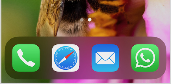

Previously, I should have done a mistake...
I took a 1125×2436 photo and create a 1301x2820 one with white part on the border.
I had something like that with Photos app and "Perspective Zoom" on (same white part at the top)
I tried again today with Shortcut app and it was ok. No white bar... 😵
So I think I failed yesterday in the size of the photo
