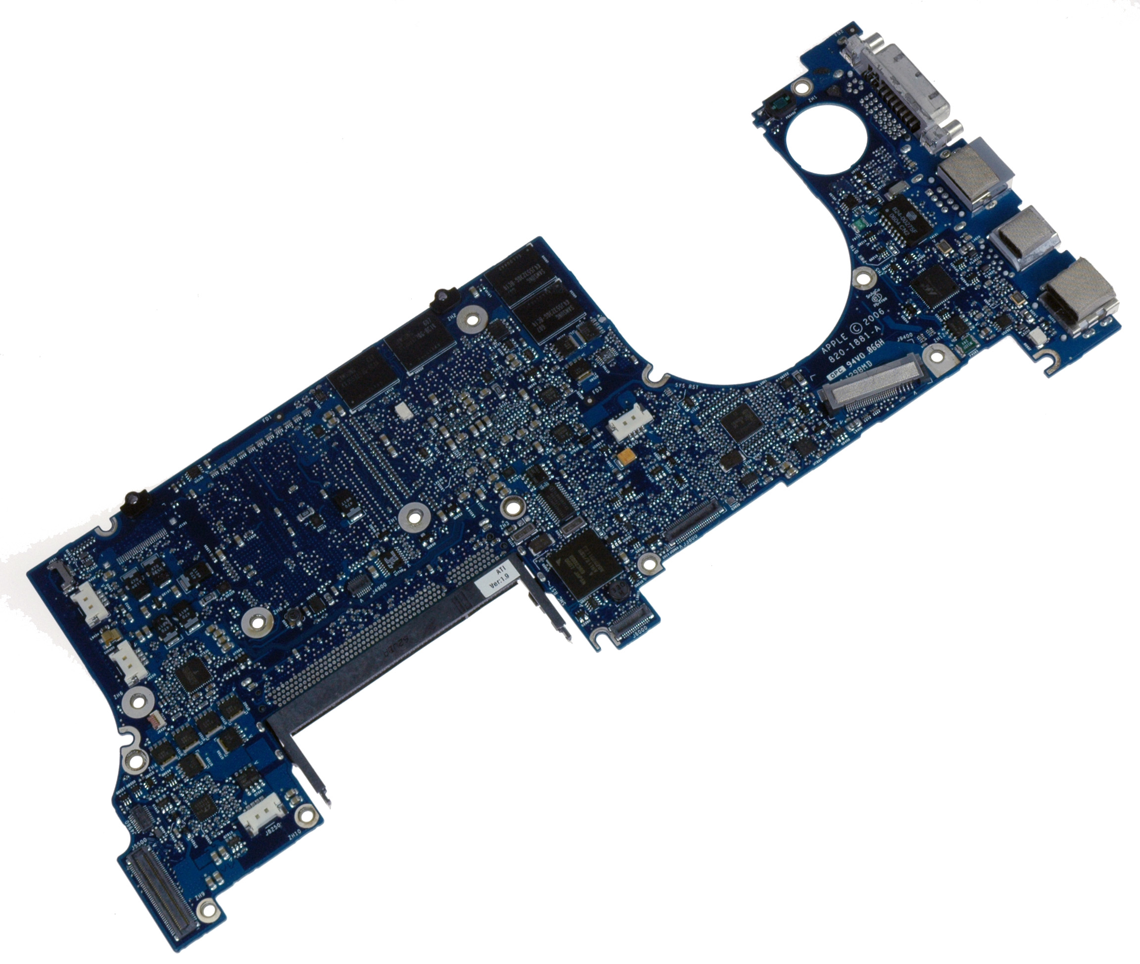

your display connector came loose, open it up and bush it back in, it should be located at the top right corner of the logic board.
in that case the connector is located right under/below the right fan, like in this picture
