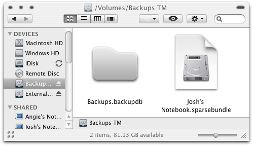

Hey guys, I've ben living with this problem for… well as long as I can remember, and it's finally time to fix it.
I have two computers using one Time Machine Disk. The physical disk is connected to my Mac Mini, and it's shared over the network to my MacBook Air. The picture below is the backup disk in case you didn't guess. The notebook is my MacBook Air:

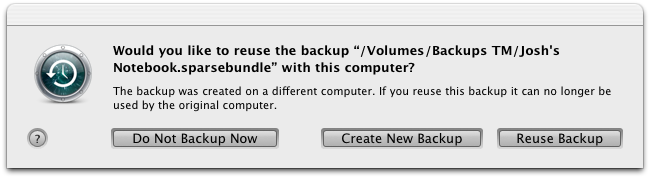

So the MacBook Air backs up just fine, but every time my Mac Mini tries to back up, it pops up with "Would you like to reuse the backup "*DIRECTORY TO MACBOOK AIR'S BACKUP*" with this computer?" also shown in the picture below. So I click "Create new backup" and it seems to backup in the Mac Mini's backup folder like it should… until next time.
So the MacBook Air backs up just fine, but every time my Mac Mini tries to back up, it pops up with "Would you like to reuse the backup "*DIRECTORY TO MACBOOK AIR'S BACKUP*" with this computer?" also shown in the picture below:

You didn't answer what button you pressed.
You shouldn't be reusing your notebook's backup for your mac mini.
Create a new backup for your mac mini instead and then it'll stop asking, hopefully.

Oh yeah, sorry about that. I've edited my OP. I do click the "Create new backup" button though, and sadly, it still asks.

Fixed it. I will write instructions here just in case I or anyone else has this problem again.
I fixed it by getting Time Machine to back up into a sparse bundle rather than a regular folder. I also think I know why/when Time Machine uses a sparse bundle rather than a folder: it only uses them over a networked drive so it has something to mount(?).
Step 1) So here is how I did it. I duplicated "Josh's Notebook.sparsebundle" and then mounted it.
Step 2) Then I option clicked the little backup menu bar icon, and selected "Browse Other Time Machine Disks" and selected ""Josh's Notebook" on "Time Machine Backups""
Step 3) Then click the little gear button and select "delete backup" for every backup. (This was to save room)
Step 4) I went to "/Volumes/Time\ Machine\ Backups/Backups.backupdb/Josh's\ Notebook" and I deleted it.
Step 5) I had a few problems emptying the trash because of error 8003, but I don't know if you will. Just to be safe, I ran "sudo rm -rf /Volumes/Time\ Machine \Backups/.Trashes" But if that doesn't work, you have to do all this "chflgs" stuff and whatnot. I don't know how to do it.
Step 6) I renamed "Josh's Notebook copy.sparsebundle" to "Josh's Desktop.sparsebundle".
Step 7) When Time Machine said it had found Josh's Desktop.sparsebundle to backup in, I clicked "Reuse this Backup"
So it does mount a drive every hour, but at least it doesn't ask me anything.
Thanks for the help everyone.
