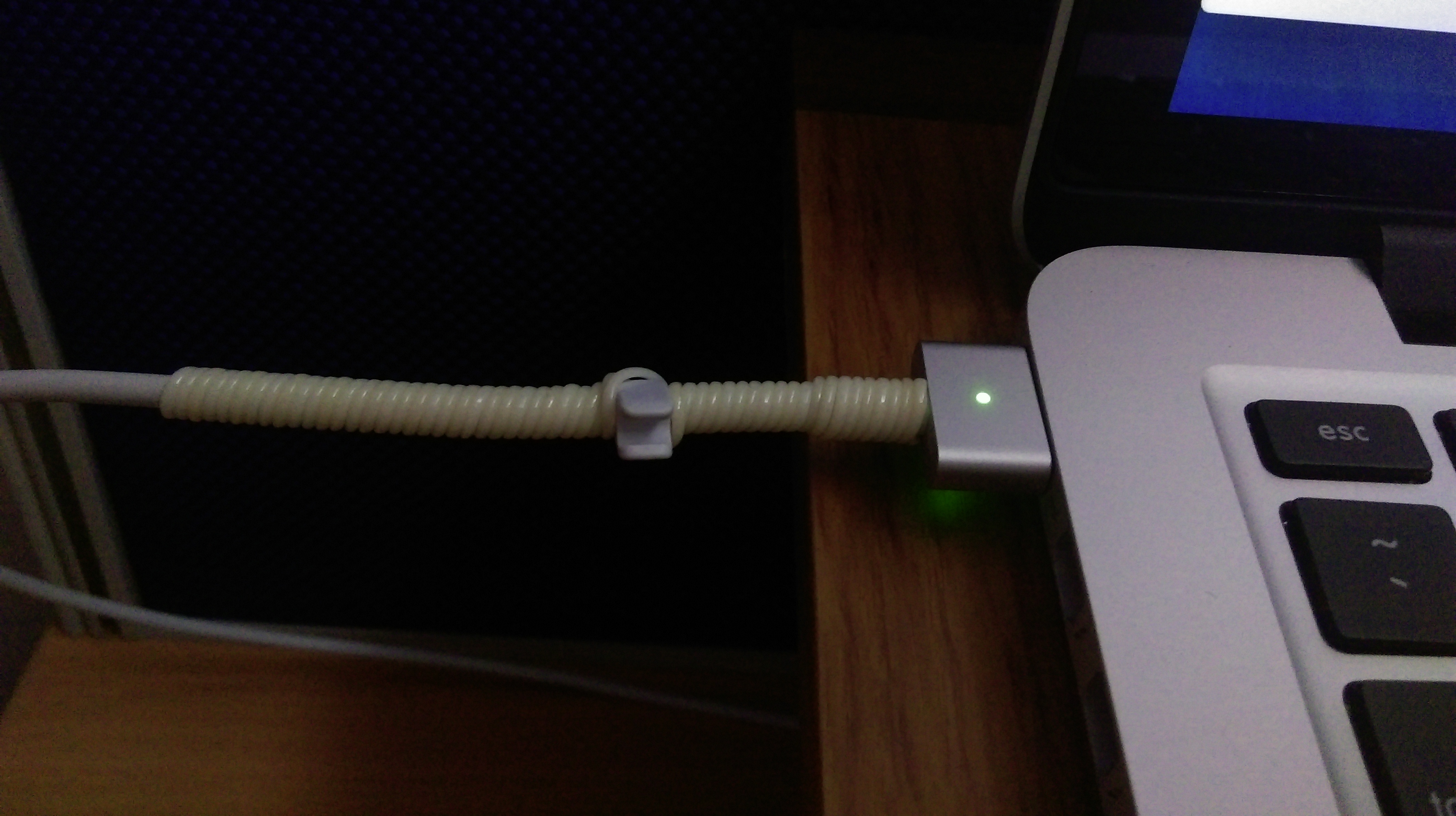

Hey guys, so I have a charging cable from when I bought my MacBook Pro back in 2011 and have been using it since. The only problem is, like the lightening cables, the MagSafe charger disintegrates with frustrating reliability. Mine actually started going black and falling off in clumps. I have no idea why this happens, but I have a solution. ABS Solvent. Just apply it liberally to any exposed area and let it dry.
Works like a bloody charm.

For something like this I would much prefer using a spiral cord protector...
The cord has already disintegrated... to be honest... past the point where a normal person would consider using it. Should have taken before pictures haha.

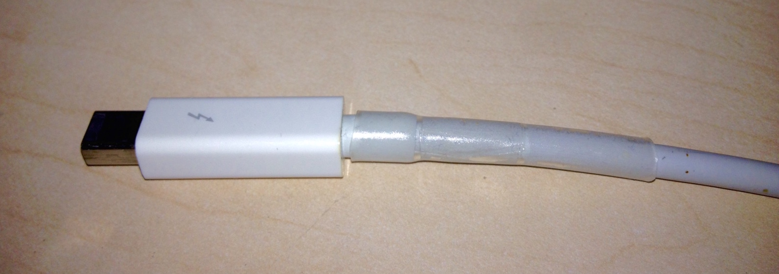

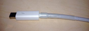

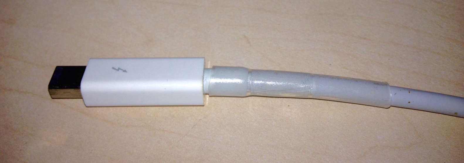

The thing with common shrink tube is that it's diameter can shrink only 2:1. So for my TB cable, I had to use lube to get it slide over the connector. The diameter difference of the MagSafe T-form connector to the cable seems to be too big to get a proper fit.

I had one cord that literally disintegrated as well on one of my MBPs, the old T style one. I went to the Apple store and they said there was a recall years ago, but the guy still honored it and gave me a new L connector. Said they constantly had people with the old T style ones coming in daily getting replacements. The T ones will fray very easily, well known issue.
L ones don't really have that problem much, but I still tweaked it a bit for preventative measures, used the coil inside pens on both Macbook cords
