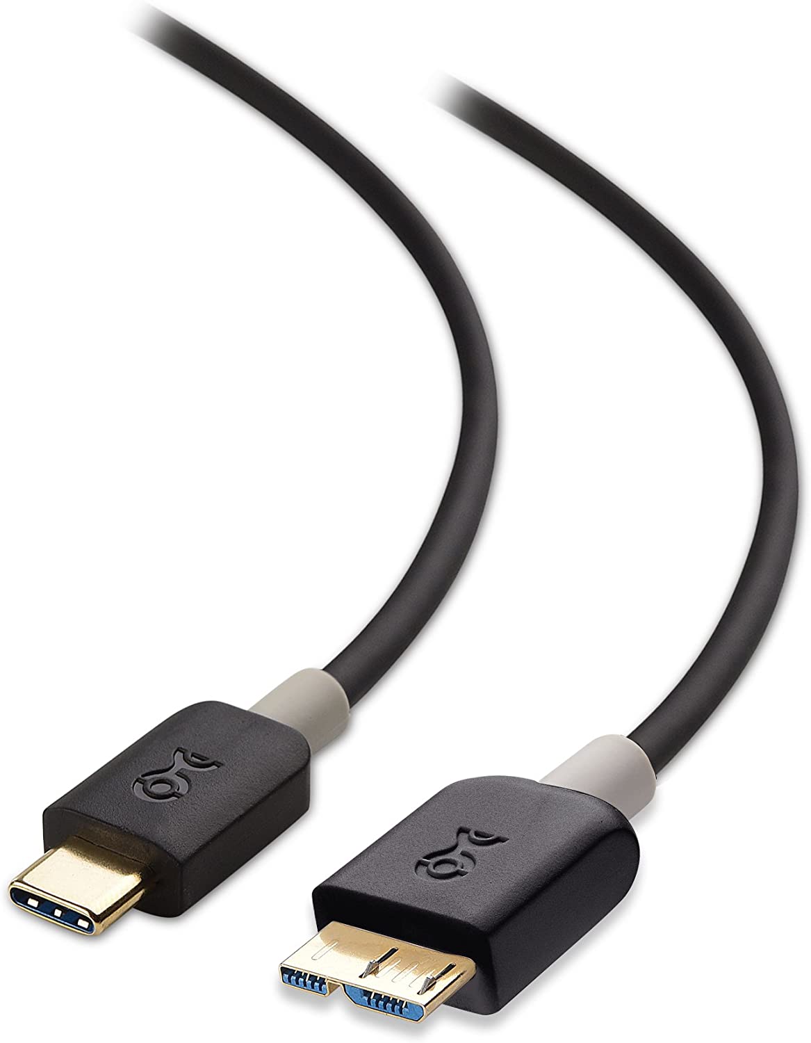

I got a few USB 3.0 to USB-C cables lying around whenever I need to back things up into my hard drives.
