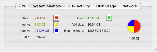

Here is the SS of the activity window. It looks like I need way more!

Maybe more than 8GB RAM total? Can I simply google Mac Pro RAM and get a bunch of the 2GB sticks? Thought I have no idea how to install them lol. I'll check into the 20" ACDs too.

Thats a good size of page outs. I would definitely increase the ram. Although how is your ram configured now?
Try macsales.com and they can walk you through it. I think bumping up your ram to 6 or 8 depending on your current configuration would be a welcome increase in speed.

You should also post a screen shot of your activity window set to disk usage. This will show you how much your hard disk is allready crammed with programs and data. If it is beyond 70% it urgently needs relieve because fragmentation will proabably make a lot of what is left useless and Windows needs free disk space even more urgent than OS X.
This is why you should really check how you have set up your windows disk in parallels. There different ways to do that. If the disk is set to grow with demand you do only have problems when the physical disk gets to the 80-90% mark.

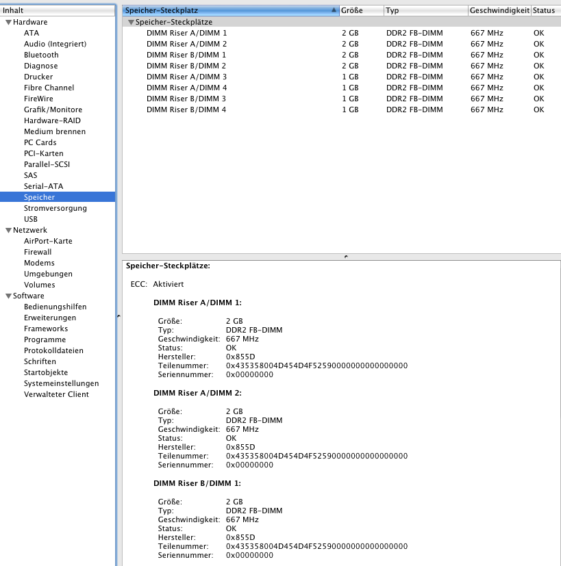

If you go to profiler you can see how and what is fitted in terms of memory to your machine. I have basically the same MacPro1,1 model and show it in the attached pic. You see that they are indeed DDR2 667 FB-DIMMs as Dr Pants said. You can see in my configuration that I'm using 1 Gb and 2 GB modules. If you fit 8 2GB modules you max out your RAM but that will probably not give you much more speed than the 12 GB I have. So I did not bother to sell my 1 GB modules. If you buy at reputed sellers like Newegg or OWC http://eshop.macsales.com/shop/memory/Mac-Pro-Memory you don't have much to worry. Four 2GB modules would probably be best for you, which will set you back 190$.
