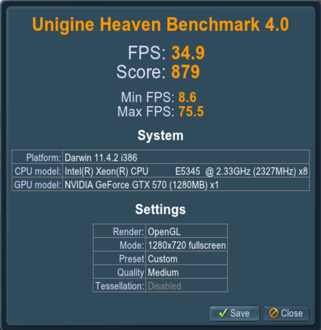

Is it possible that the test is CPU bound?
Anything is possible of course but one wouldn't ordinarily expect an OpenGL slash DirectX benchmark to be CPU dependent.
My guess would be that it's a lame-ass windows port and isn't doing almost anything right. Just a guess tho. 😉
I would say that it is something fishy with your 570 (even though, yes the 8800GT was a beast for its age).
My 560Ti even get better scores than your 570 (56.5fps/1423 points on the same 1280-settings you used for the Heaven 4.0 benchmarks)
Try increase the settings to 1920*1200-ish and higher settings to see if the difference is larger then? (my 560Ti got 32 fps on 4xAA and medium quality, 1920*1200)

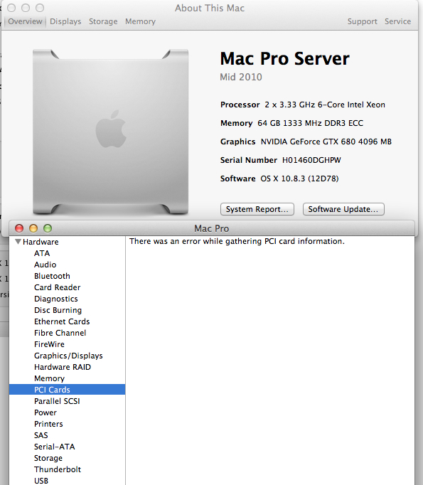

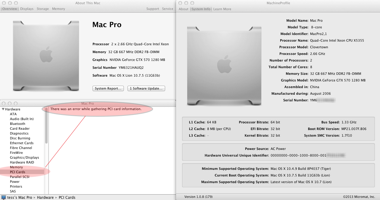

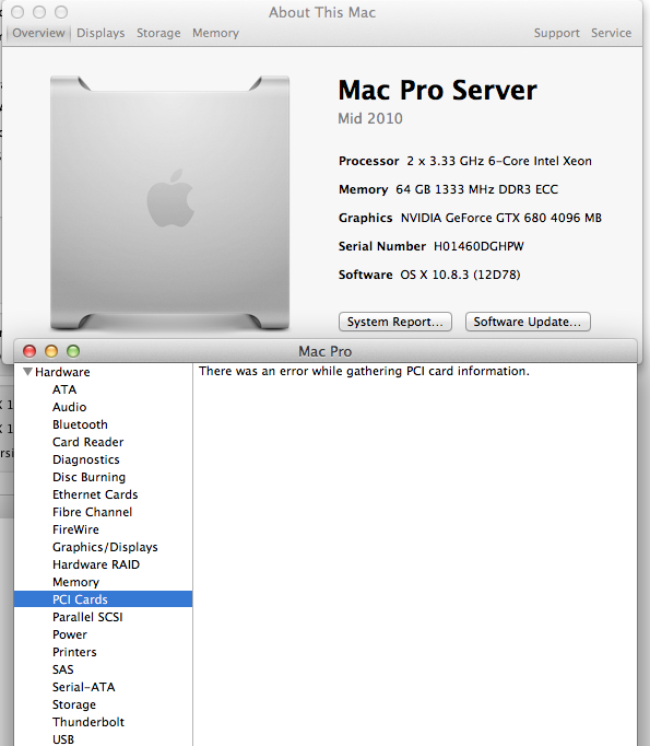

Could be you're right... I mean WTH is this (notice PCIe bus is erring somehow):

I get the same error...
I get the same error... I think it's due to running non-EFI cards.

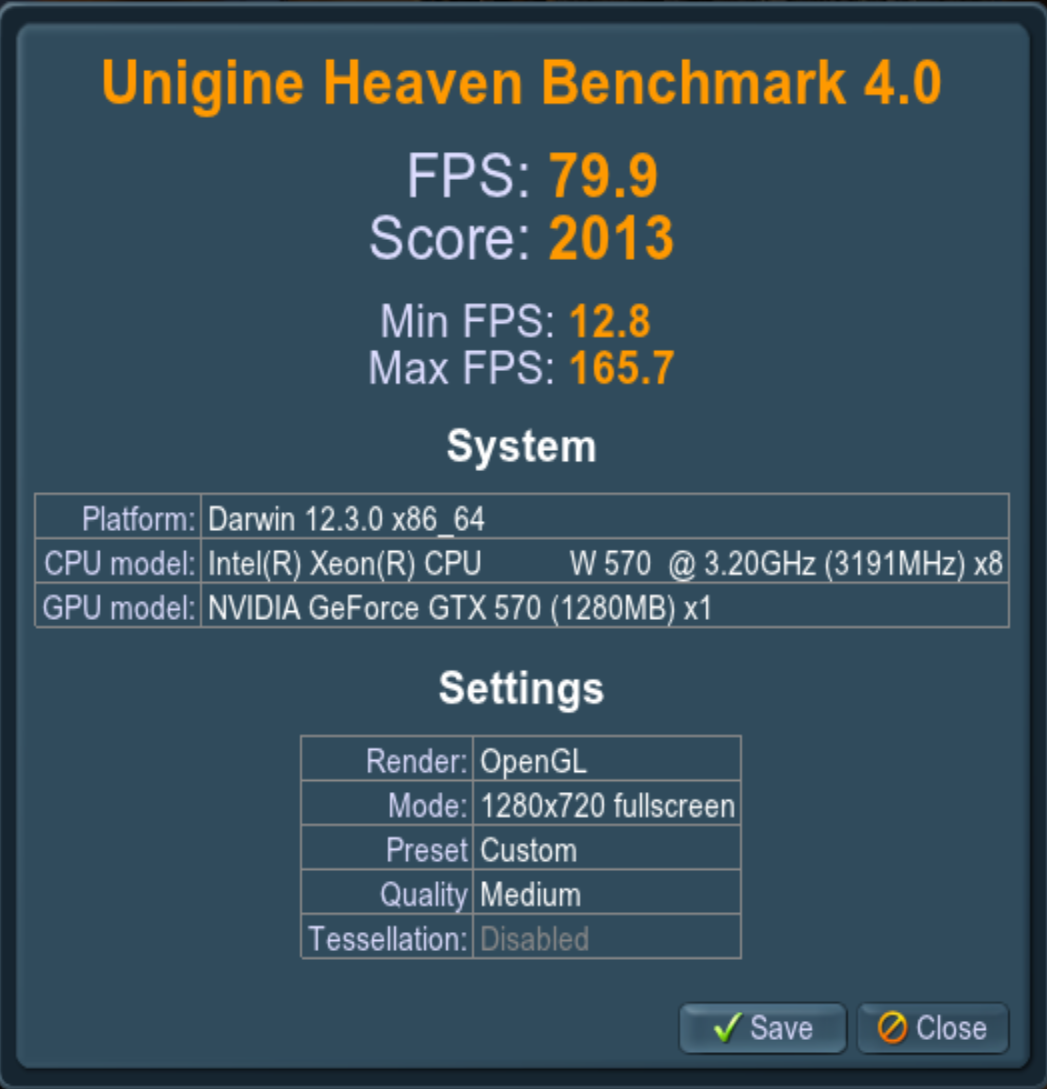

Heaven Benchmark seems to be working fine for me though.... 😀

Error in ASP is normal when you have non EFI graphics card installed.

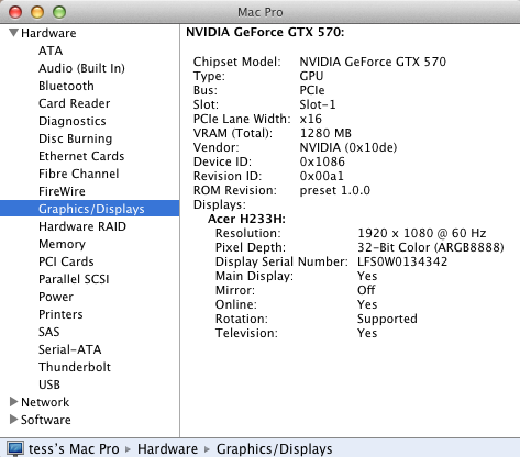

Tesselator: something is wron with your 570. How much lanes does it show in ASP/Graphics Cards? Bechmark score looks like it would be about x4.
Hmm, these errors don't sound real good. I guess we need to flash the cards to get rid of them? Great, more trepidatious procedures to undertake. 😛

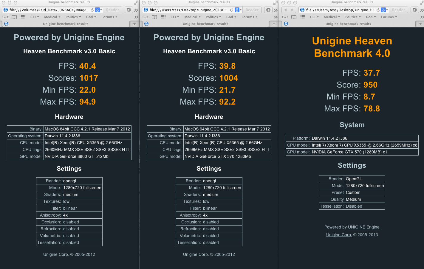

I tried upping the specs and the score remains about the same. Between 1010 and 1070 no matter what I turn on or off. And the average frame rate stays the same too (between 40 and 50) - again no matter what I turn on and up to 1080p. I guess that's different than the 8800GT which crawls set like that but it's still kinda weird that MUCH lower settings wouldn't produce MUCH faster frame-rates. <shrug>
It says 16x... <shrug>
You'd need to create EFI32 ROM for it, because all existing are EFI64.

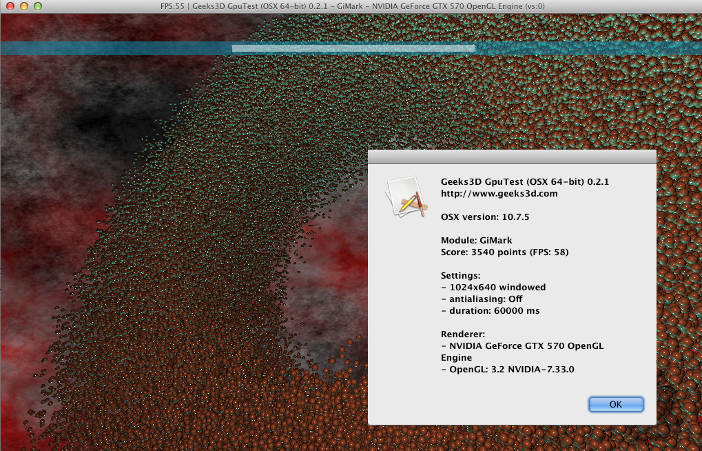

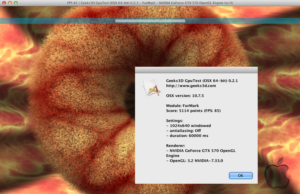

Other benchmarks seem to be appropriate (in comparison with the 8800GT) tho. The 8800GT gets about 5FPS in FurMark (right) and 0.1 FPS in GiMark (left).
Although interestingly, Furmark in full frame at 1080p (on the 570GTX) shuts the power off to the card about 20% of the way thru the benchmark. I hear a click, the display goes black, and the card turns completely off. Weird. I assume the PSU is being over-taxed and this is a safety feature. <shrug>

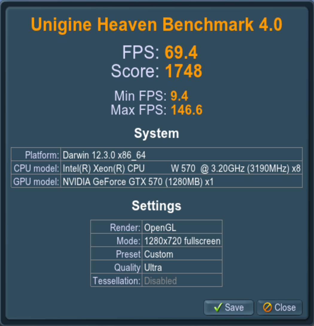

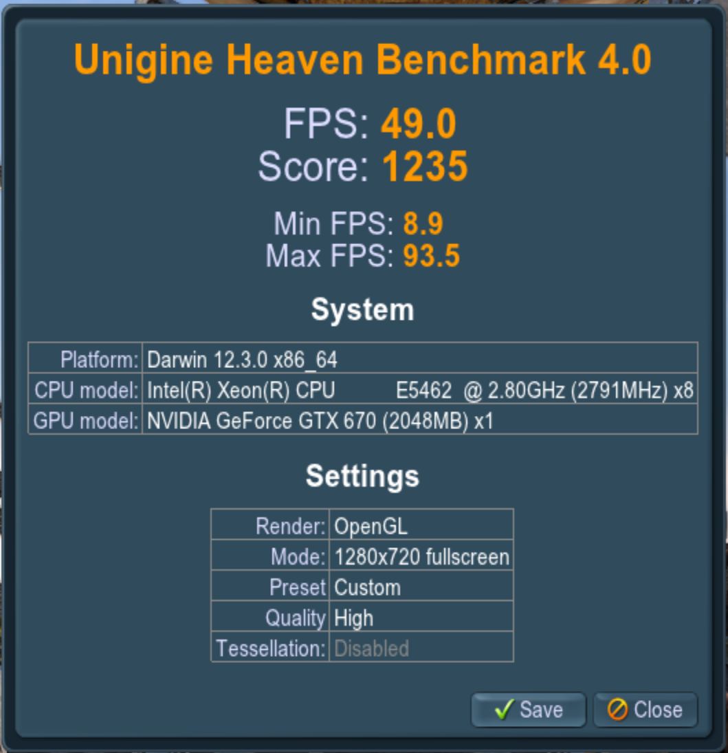

Here's mine at that resolution.
Thanks man! That a different (higher spec) system tho. I'm waiting to see what 666sheep comes up with. 🙂 If it's at all close to mine I'll just relax and accept it. If it's significantly higher I have to do some more testing or return the thing. 😛

Here is the 4,1 on medium settings just like the 1,1..
Amazing the difference between the same card in two different machines.
