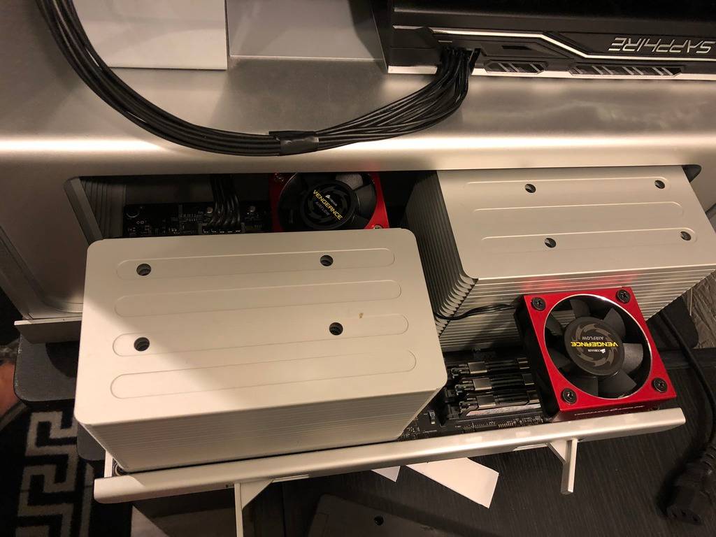

I wanted to see what difference some extra fans would make cooling the ram and IOH and this is what I used.

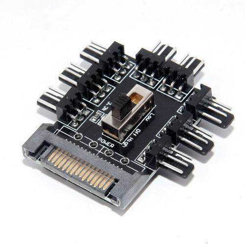

one of these SATA to fan controller, with high and low speed setting.

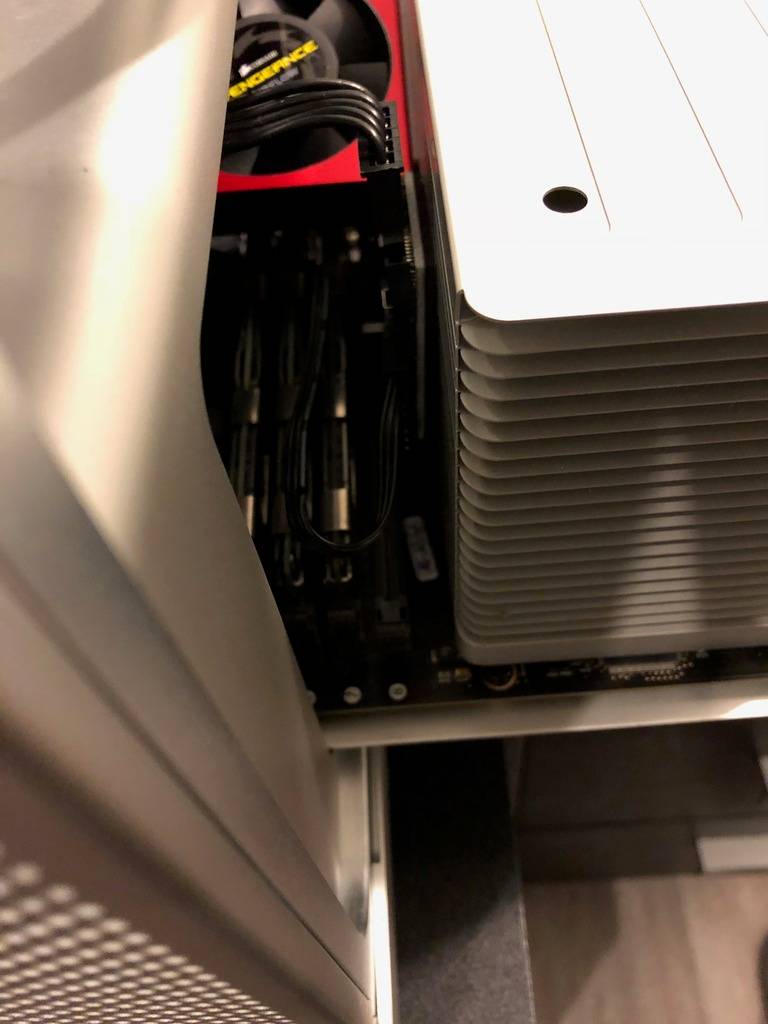

then fitted fans using double sided tape, foam filled so no vibration. looks like this.
the fan controller is also double sided taped to side of heatsink B like this.
and before and after temps, and totally silent on low setting.
and after temps.
so after it is cooler and silent, and lost 6.5c off the IOH temp plus ram cooler.
the power I took from the SATA power feed, can be via the spare optical drive, so you need a SATA power extension cable. run that to the fan controller pic 1 and then stick that to the side of heatsink B and plug in the SATA power lead from optical drive spare. the fans are 60mm corsair vengeance fans with aluminium which again are double sided foam taped to side of CPU heatsinks. plug fans into the fan controller and that's it.

Is there any evidence that the memory needs additional cooling? 33c doesn't seem concerning enough to warrant this.
Reactions: mrxak
when you are using memory intensive tasks it heats up and throttles, which reduces band width also heats up IOH so 2 simple fans can make a difference. its just an easy mod to improve cooling really, heat is the biggest cause of failure's of any component part. if you live in a warm climate 6c will make a difference.

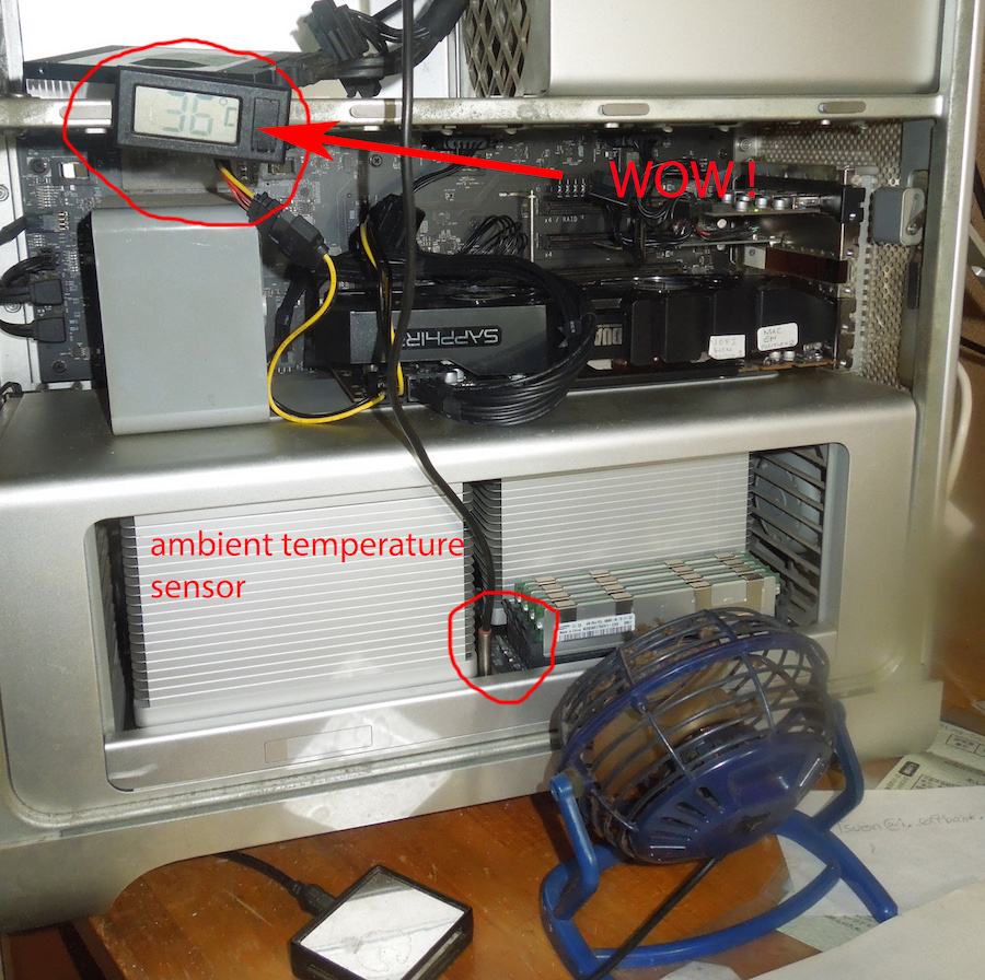

I just did this as a test using the blue USB powered fan in the photo with an ambient temp sensor.
Not very scientific but close to real world data.
Got a 7°C reduction in ambient temperature from 43°C to 36°C. Considering that it is the peak of summer here in middle Japan that's amazing . .. . I might try to connect one of those ultra slim GPU fans to the USB one and position it between CPU B & CPU A . . . as a test
Got a 7°C reduction in ambient temperature from 43°C to 36°C. Considering taht it isthe peak of summer here in middle Japan that's amazing . .. . I might try to connect one of those ultra slim GPU fans tothe USB one and position it between CPU B & CPU A . . . as a test

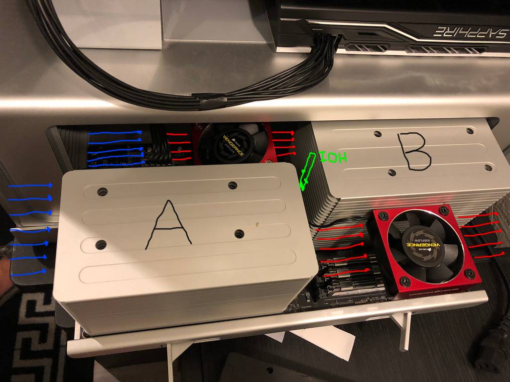

interesting test there, only thing I can see is your temp sensor sits right in front of the cooling fan offering optimum detection of temp variation. this is how I see the air flow in a Mac Pro.
Cool air enters via the intake fan at the front, CPU A gets the coolest air, Memory for CPU A also gets the coolest air from intake fan at front. Boosta fan in CPU heatsink A pushes air out the back of heatsink A ( which has warmed up cooling the CPU A then has to cool the Dimms by the side of heatsink B and exit via the fan at rear. the fan above dimes next to cpu B is directly above the centre of dimms blowing down to offer better cooling to Dimms next CPU B before exit via rear exit fan.
Cool air from the front goes across the CPU A dimms and warms then passes over IOH heatsink at the bottom of CPU B heatsink and into the boosta fan of CPU B to exit from rear fan at the back. this is the warmest path from entry cool air over CPU A dimms then IOH and then CPU B. the fan I have put on the side of heatsink A is not directly pointing downward. its at an angle pointing backward towards heatsink B directly blowing over IOH and aiding the cooling of CPU B
the Mac Pro cooling layout isn't bad, works as a tunnel blowing cool air from the front to exit at the rear. this setup aids in cooling and if you are sat in a hot climate it can help keep your Mac cool with out making it noisy. the side cover is important to keep on as this creates the tunnel affect from front to back.

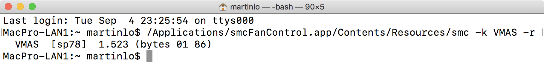

On my flashed 5,1. The PC3L memory is running at 1.523V.
I suspect your current DIMM simply has better quality then the old one, therefore, give you better result. That's most likely nothing about 1.35V vs 1.5V
