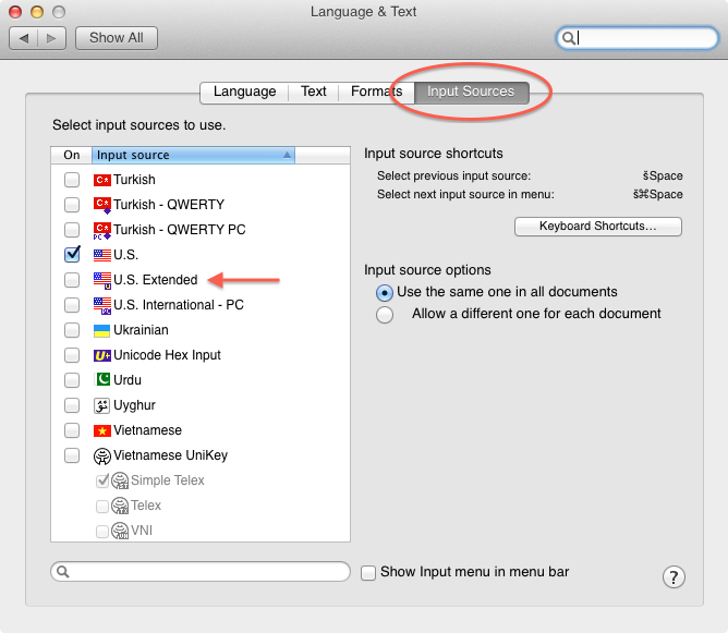

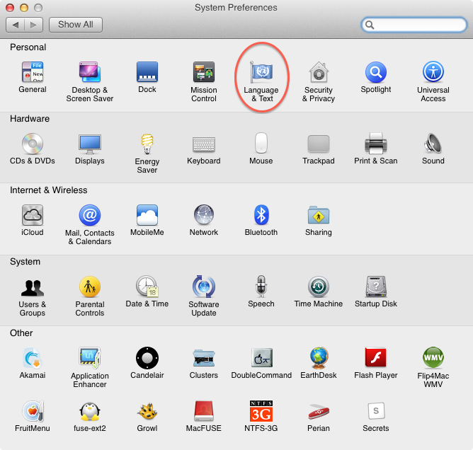

Are you using an extended keyboard or the shorter keyboard? Either way, try this:
Open System Preferences and click on Language & Text:
Select Input Sources, then scroll down until you see the choice between U.S. and U.S. Extended. If you have an extended keyboard, make sure you're on the extended choice (I'm guessing maybe it's the opposite).
jW
Thank you for your help. I use a Turkish Keyboard, shorter one. It is the original iMAC keyboard. Tried all the possible combinations, but not solved yet 🙁
