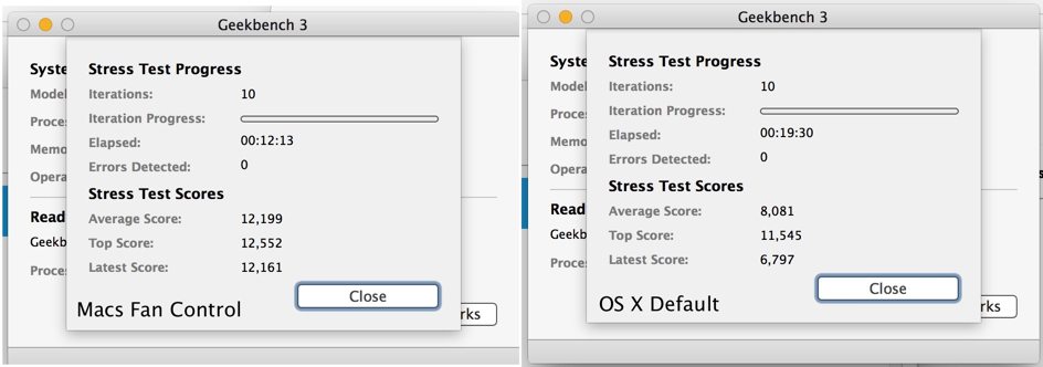

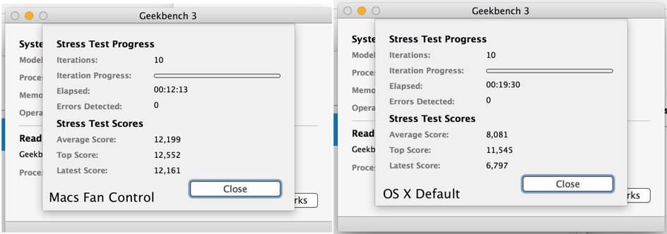

Here's a comparison showing Macs Fan Control vs just the OS X default using the CPU Proximity sensor fan control while running 10 iterations of the Geekbench stress test:
Note that the final Geekbench score is in the range of a dual core i7 MacBook Air rather than a quad core i7 rMBP and took over 7 minutes longer to finish when the CPU depends on the SMC for cooling. It really looks like a bad CPU proximity sensor not causing the fans to spin up to speed and relying on the i7's thermal self protection to drop the clock speed to keep from overheating.
Mark
