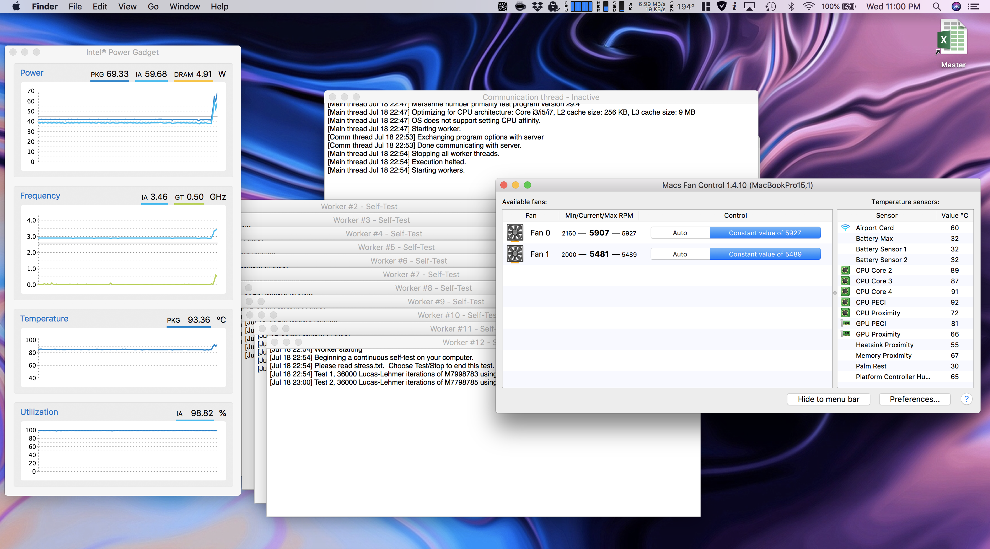

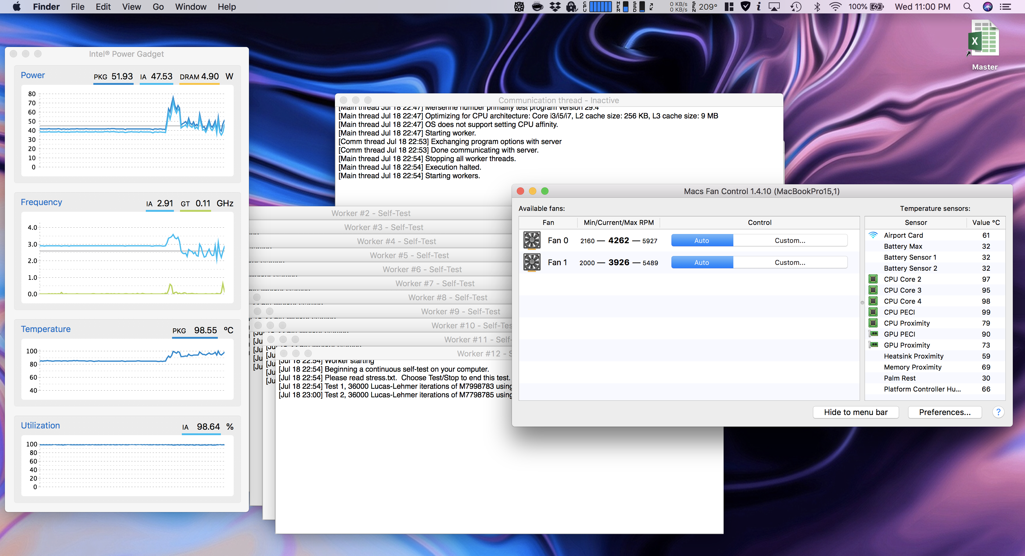

So I installed Macs Fan Control and maxed both fans and ran torture test for at least 5 minutes on Prime95 and held a constant 3.0GHz on a i7 2.6. As soon as I turned the fans to auto, that's when it started to dip below base frequency. So in theory, Apple could fix this with a much more aggressive fan speed profile. See screenshots.

I didn't think they were unacceptably too loud. It may not even require 100% max sped on both fans to maintain frequency above base. I guess I could keep lowering it by 1% to see where it finally drops but the point is that best case scenario, it can be fixed with a more aggressive fan speed profile. Which means it could be fix on the software side.
