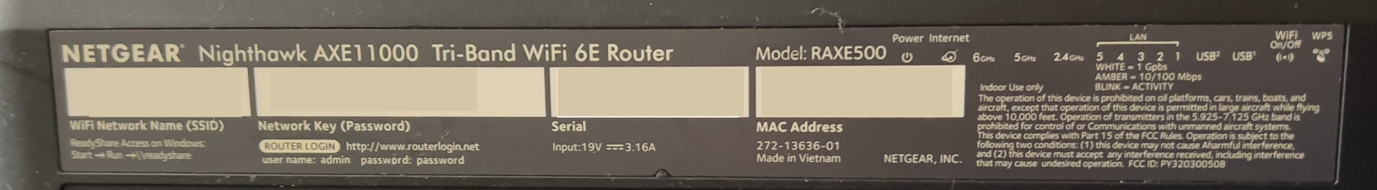

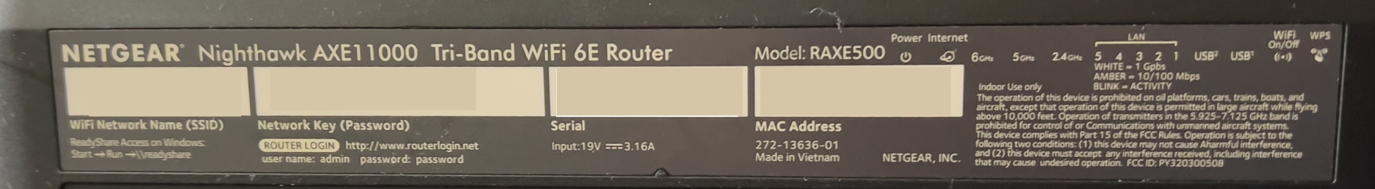

Look at the bottom of the wifi router and modem, all the model info should be on a sticker.
The router is on a top shelf needing a ladder to reach it. However the modem is easily accessible. Which one do you want the info for?
You are looking for:
In this case the router vendor is Netgear, the model is Nighthawk AXE11000.
