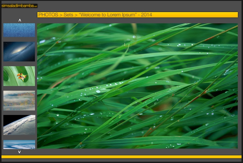

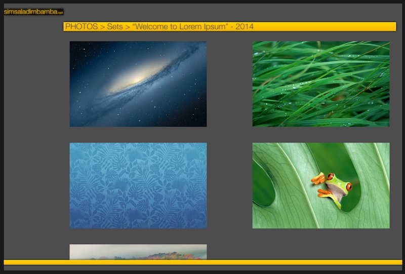

I embed two screenshots of what my website might look like, with crude examples of spacing and size and all that shizzle.
The site shall look like this, when one has selected a gallery to view:
In the old times, I would have done it via frames, but I guess, that is not needed anymore.
A top frame for the page name,
another frame below for the navigation (the yellow bar)
and another frame below for the content, which would be divided into a left and right frame (see second image) for navigational purposes,
and then a frame below the content for the rest (contact, about, share (?), ...).
The second frame from the top would have included an image of the navigation and I would have used an image map to embed the links.
Is all that still needed? Should I divide the image into several to not use image maps? I do not want to use a regular font and do not want to look the font different on another device.
As for the second image:
Once one has selected to view an image larger than in thumbnail view, I guess I can use such jQuery template, but what if I want to still have the thumbnails available somewhere for one to click on? I liked the idea of them being on the left, maybe in a scrollable frame (which adds a bit of interaction, but can be quite turning off to the visitor), but most gallery templates put them on the bottom, which is okay too, and one would not need the two frames in the third frame.
Sorry for all the frames, as that is how my mind is still set up, but with all the dynamic stuff nowadays, frames seem to be mostly gone, except when rigid.
Anyway, if anyone would be please so kind to give me some pointers on where to go from here, it would be fabulous.

What you could do with HTML5 and CSS is the following:
you have a container that wraps up the entire thing, both the thumbnails and the actual gallery image. The thumbnails consist of a list with links to the actual image from the thumbnail, so that they remain accessible without javascript. You float that thumbnail list to the left and give it whatever width you like and apply some right margin, so it's not bumping right next to the actual gallery image container.
Code:
<style>
#content-container {
background:green;
margin:0 auto;
width:960px;
.thumbnails {
background:gold;
float:left;
margin-right:50px;
width:300px;
#image-container {
background:dodgerblue;
float:right;
width:600px;
.clearfix:before,.clearfix:after {
display:table;
content:'' ";
.clearfix:after {
clear:both;
</style>
<section id="content-container" class="clearfix">
<ul class="thumbnails">
<li><a href="image1.jpg"><img src="thumbnail1.jpg"></a></li>
<li><a href="image2.jpg"><img src="thumbnail2.jpg"></a></li>
<li><a href="image3.jpg"><img src="thumbnail3.jpg"></a></li>
</ul>
<section id="image-container"></section>
</section>
This is just a very rough idea on how you could proceed.
The image-container remains empty, since you add those images via javascript/jquery.
