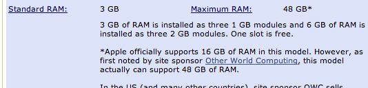

This is why I'm confused from everymac.com
---> *Apple officially supports 16 GB of RAM in this model. However, as first noted by site sponsor Other World Computing, this model actually can support 48 GB of RAM.

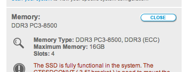

... and on top of that the crucial system scanner also says max 16GB
Okay I understand about the 48GB part, but where on the apple site does it say officially supports 16GB? In their document I found: http://support.apple.com/kb/SP589 it says this model supports 32GB.

Thanks for that, I understand that part but why do some sites say that this model has as maximum of 16GB?

Is this because at the time of posting the results above, 8GB dimms had not been tested yet or there weren't any 8GB dimms of this speed so apple just said the maximum was 4x4GB chips? Or have these sites just simply got it wrong?
... why do some sites say that this model has as maximum of 16GB?
AFAIK - Apple did not configure that model with more than 16 GB. The Apple support page for upgrading memory no longer uses that figure, but says 32 GB max - which is also not accurate. The 16 GB figure just doesn't give you all the info that you need, without some more study.

When I look at (Crucial.com) the single 3.33 GHz, 6-core processor, mid-2010 MacPro shows a maximum of 32 GB - not 16 GB?
Thanks DeltaMac that clears things up.
Yes crucial.com does say 32GB for this model but if I use the system scanner from the same site it comes up as 16GB as you can see in the picture above.

I went back to everymac.com and looked up my model and this time I couldn't find where it says,
*Four memory slots are provided on the "slide out" processor tray. Note that this model supports triple channel memory addressing and performance is improved by installing memory in groups of three.
Could I have been mistaken? Turns out I was! This comment comes from the 2012 Mac Pros so I'd click the wrong model... unless they've changed it recently.
Anyway, everymac.com says about this model,
3 GB of RAM is installed as three 1 GB modules and 6 GB of RAM is installed as three 2 GB modules. One slot is free.
So maybe after all this model really is triple channel memory as well. I don't know if I will fork out the extra $99.79 for another 8GB dimm, just for my Apple OCD.
