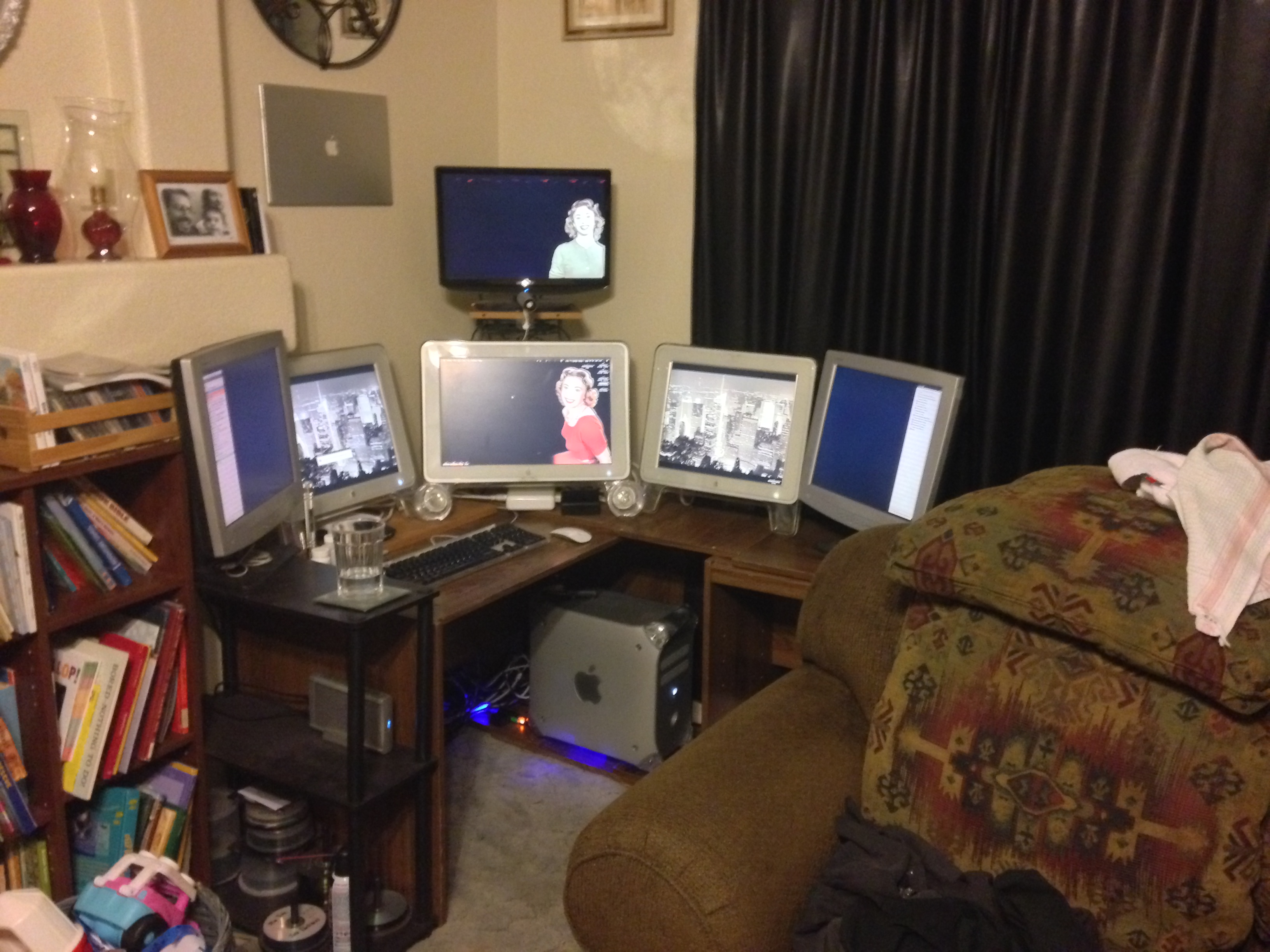

Well, tonight I thought, how can I keep my six displays and resolve this?
I have another 9800 Pro card that was donated to me, but it was a flashed card and the last time I tried it I didn't know that and so did not tape pins. I put in the fan that I had pulled from my new 9800 Pro, taped the pins and started the QS up.
Well, lo and behold the Mac booted, but just like with the FireGL X3 card the Mac did not see this 9800 Pro at all!
So…now, I am annoyed. I shut down the Mac and pulled out the card. I took the VGA cooler off the new 9800 Pro and put the fan back in BECAUSE this card WORKS in the AGP slot. It was Mac branded for a G4.

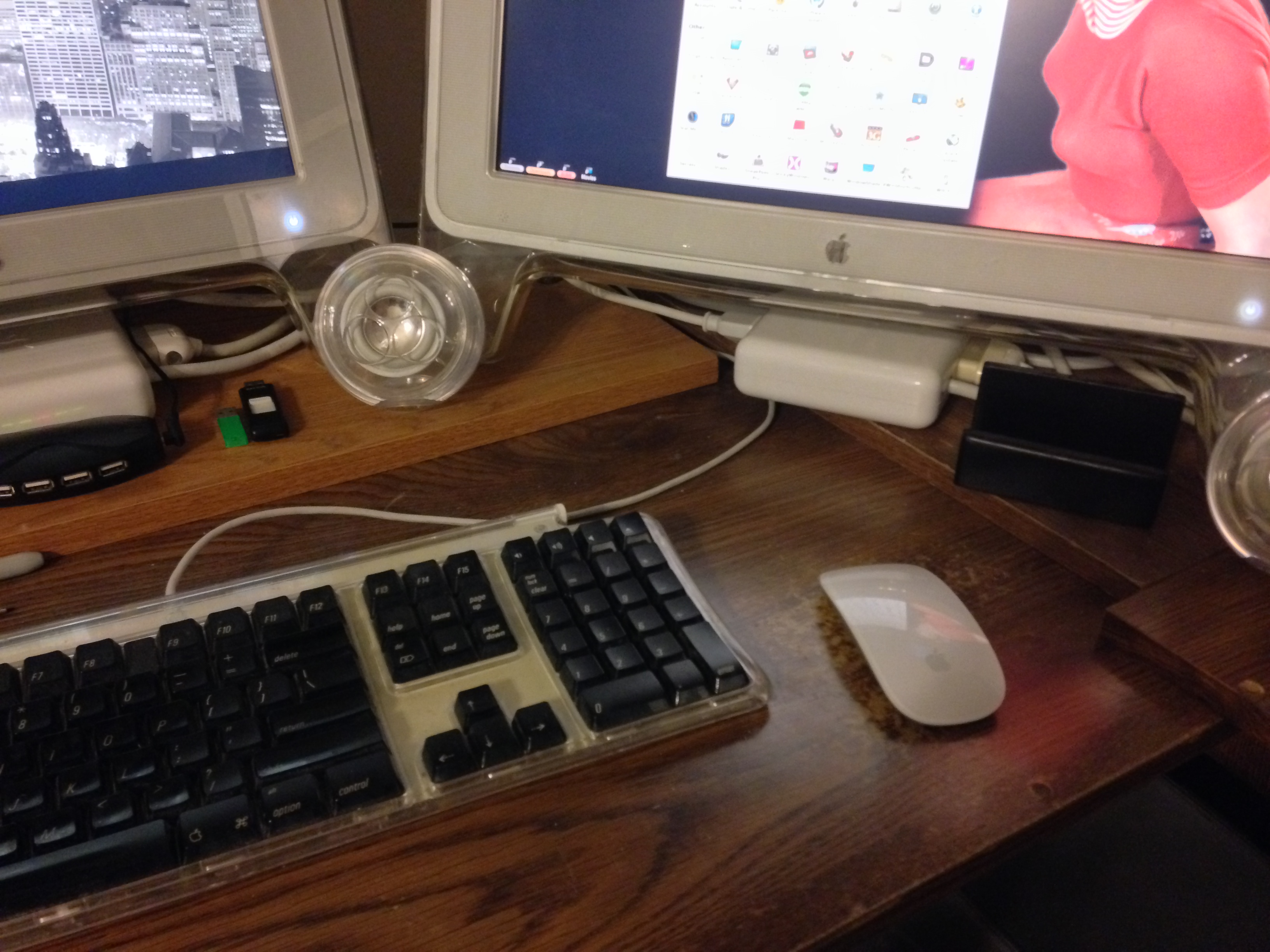

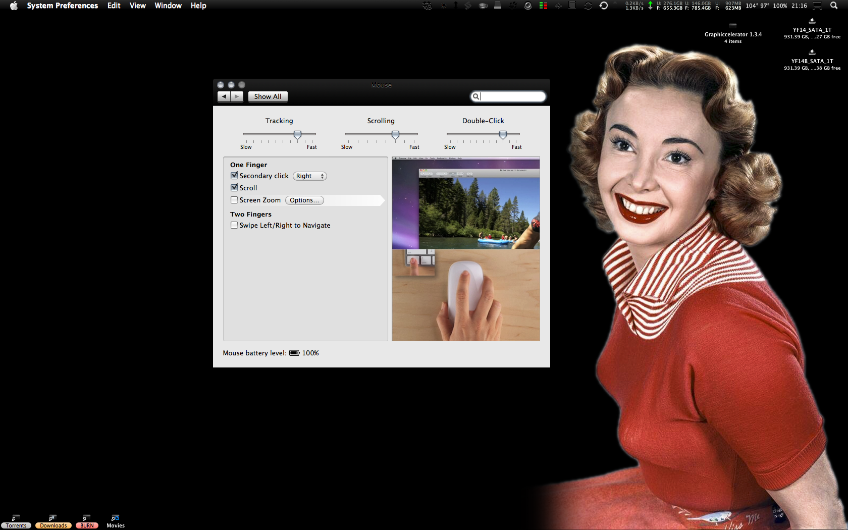

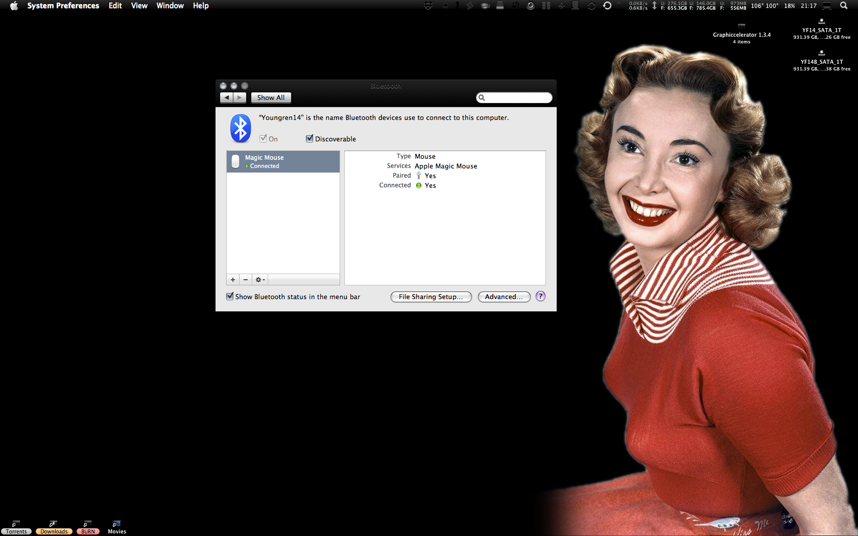

Somewhere in there I installed the Sonnet card. Booted the Mac back up with six displays and plugged in the Belkin USB adapter.
Instant Bluetooth!!!! My QS paired with my Magic Mouse and I am now using it flawlessly!
I bought a different USB BT adapter much earlier and had nothing but problems. This Belkin has a range of 100 meters and the connection is solid!
So, here I am. Six displays, all slots filled, a Magic Mouse and two more Firewire 400 ports!

Is there a picture somewhere of all 6 displays? I feel like I have to see this to really believe it. 😛

!!!AWESOME!!!
As you can see, I am so excited about this that I put the exclamation points before AND after the word. Nice job, man!!!
Sure…
ATI Radeon 9800 Pro (AGP)
--> 22" Cinema Display
--> 20" HDTV
ATI Radeon 9200 (PCI)
--> 17" Studio Display
--> 18" Gateway FPD1810
ATI Radeon 7000 (PCI)
Sure…
--> 20" HDTV
