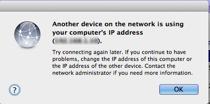

Is this anything to be concerned about?
What causes this?
How can I fix it.
Many thanks all 🙂

Usually I've seen that when I've connected both via Wifi and Ethernet, and the router has gotten confused. Fixing settings in the router or just making sure you only connect via one method can resolve the issue, or if there are multiple devices on the network, make sure that they're not set to grab the same assigned IP address and instead either have different ones or are set to assign automatically.
jW
This is a problem that occurs sometimes with Macs. When connecting to a network that uses DHCP they want to use the same IP Address they used the last time they connected. However, after a router reboot the router will assign IP addresses on a first come first serve basis.
For some blasted reason a Mac connecting to the network will continue to want to use the same IP Address it used before. Rather than just taking a new one and keep throwing up this error.
The methods I have found to prevent this are to delete the network from the Keychain then reconnect, create a new network location in the Network pane and delete the old one, or assign static IP Addresses.
This has been a long standing problem in OS X. Though I have yet to encounter it with Lion. I don't know why Apple has had so much trouble with automatic DHCP, Windows just moves on to the next address.
