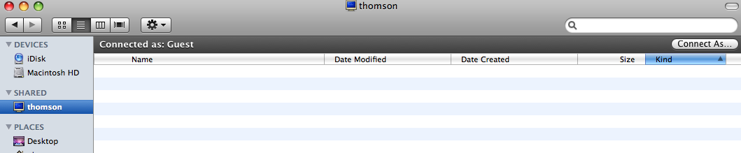

I have just installed the leopard last night. while i clicked into the mac HD, i see there is another person's name appeared under the folder SHARE. It is a pc user and has been somehow connected to my computer under a guest connection. I am really worried that he might have hacked into my account and steal my personal details. Or stealing my internet, I already have a wep pin for security.
can someone please help and let me know how to stop the connection or forbid other random people logging into my computer? as that person might not even realise that we are connected.
Thank you so much!

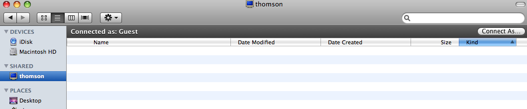

I took a screenshot as suggested by Savar. Please take a look and see if someone has any clues!

Screenshot

Unless I'm missing something.. that's a computer to which you are connected as a user, not one that is connected to you. In other words, you're accessing *their* drive, not the other way around.

I have EXACTLY the same on mine! With the name Thomson as well?! I have no idea where it came from?! Is this a leopard bug?
Under the Shared tab in Finder, your computer will list any resources on your network that are available via Bonjour.
I thought I read once where a particular model of a DSL modem was announcing across the LAN that it had resources to share, so Leopard listed it under the Shared area of Finder, just like it would with any other resource.

Looks like the culprit is a "BT HomeHub", whatever that is.
As others have pointed out, when you see a device along the side of a Finder window, that is a shared network resource that YOU are connecting to, not the other way around.
(In fact, I'm not sure how easy it is to see, within the Finder, who else is connected to your computer.)
When browsing public networks, please be sure to turn off file sharing if you're not using it. Especially since Leopard makes it that much easier to find and connect to them.
