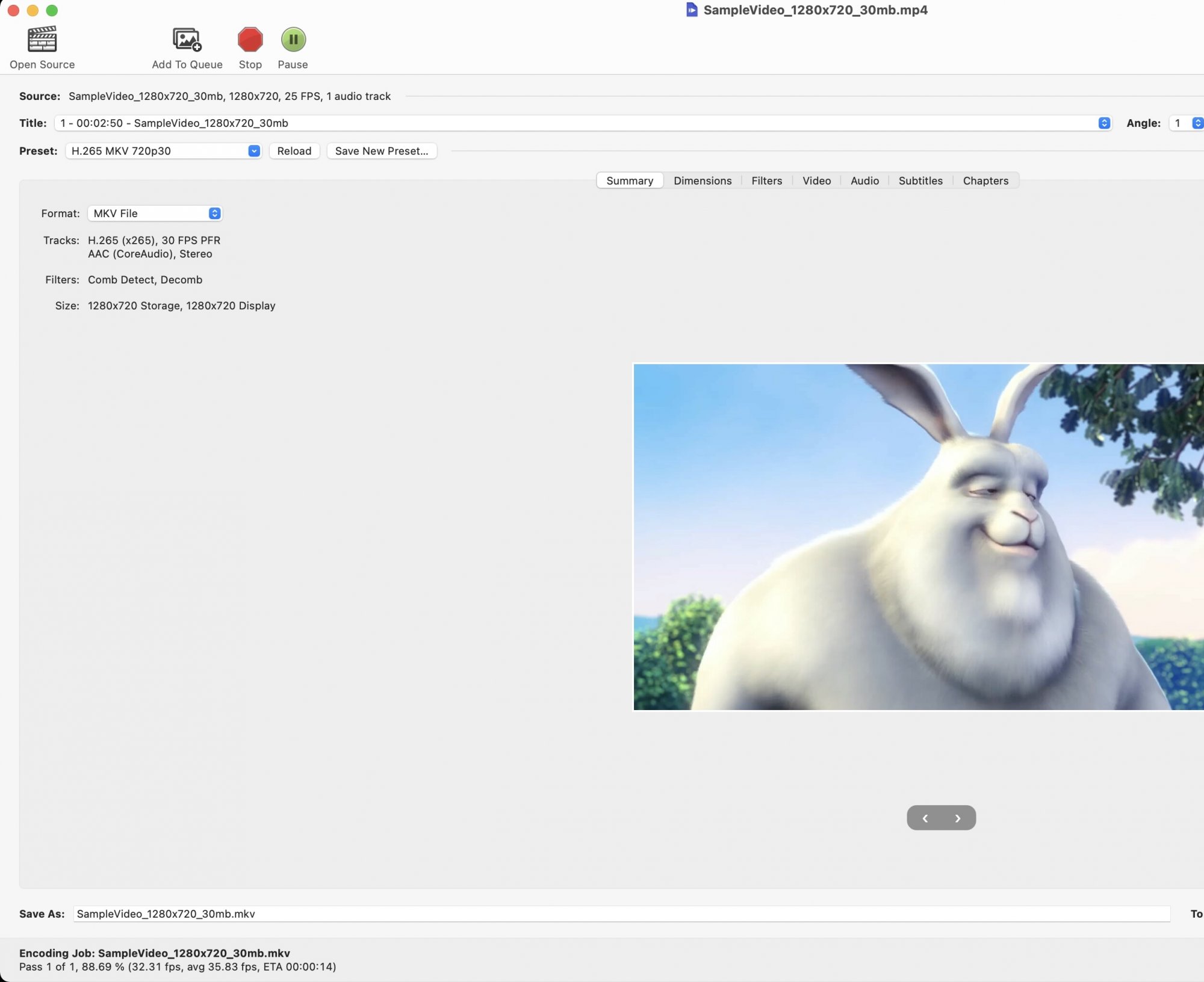

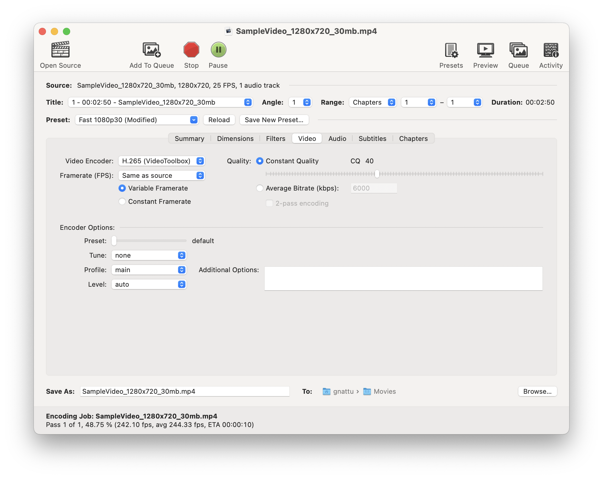

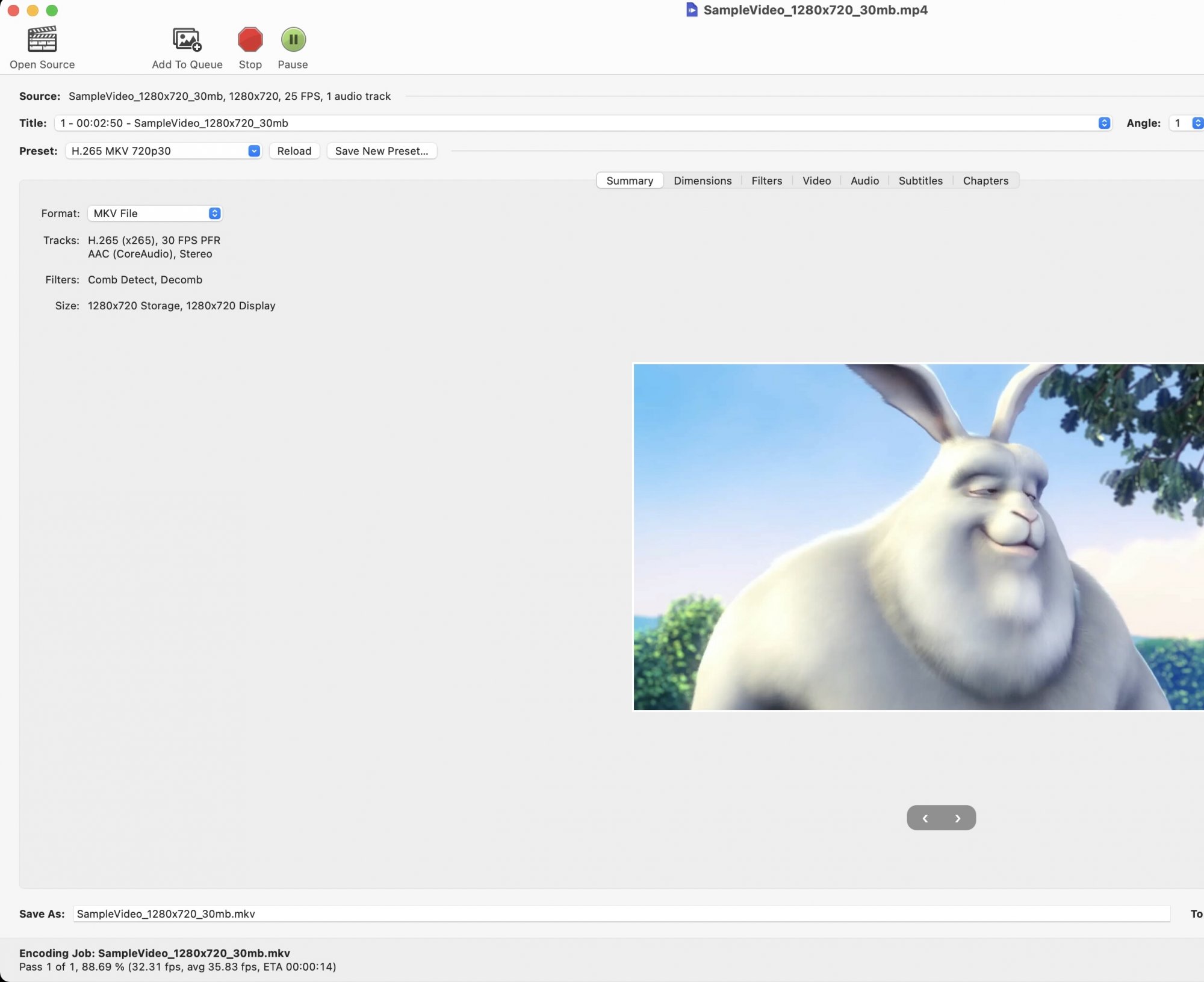

average is about 35fps

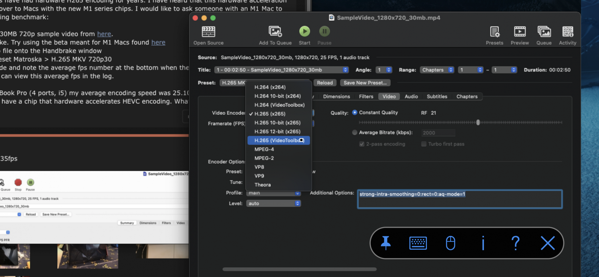

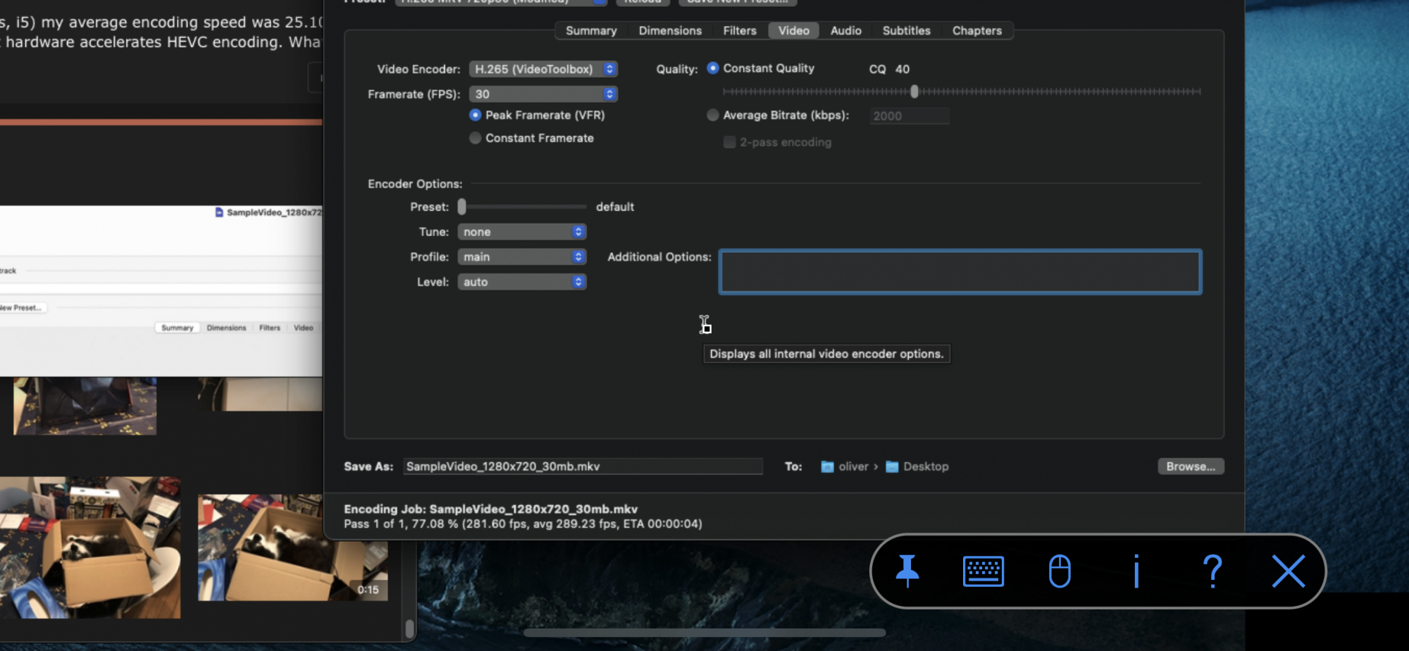

It’s faster than that if you enable hardware encoding.

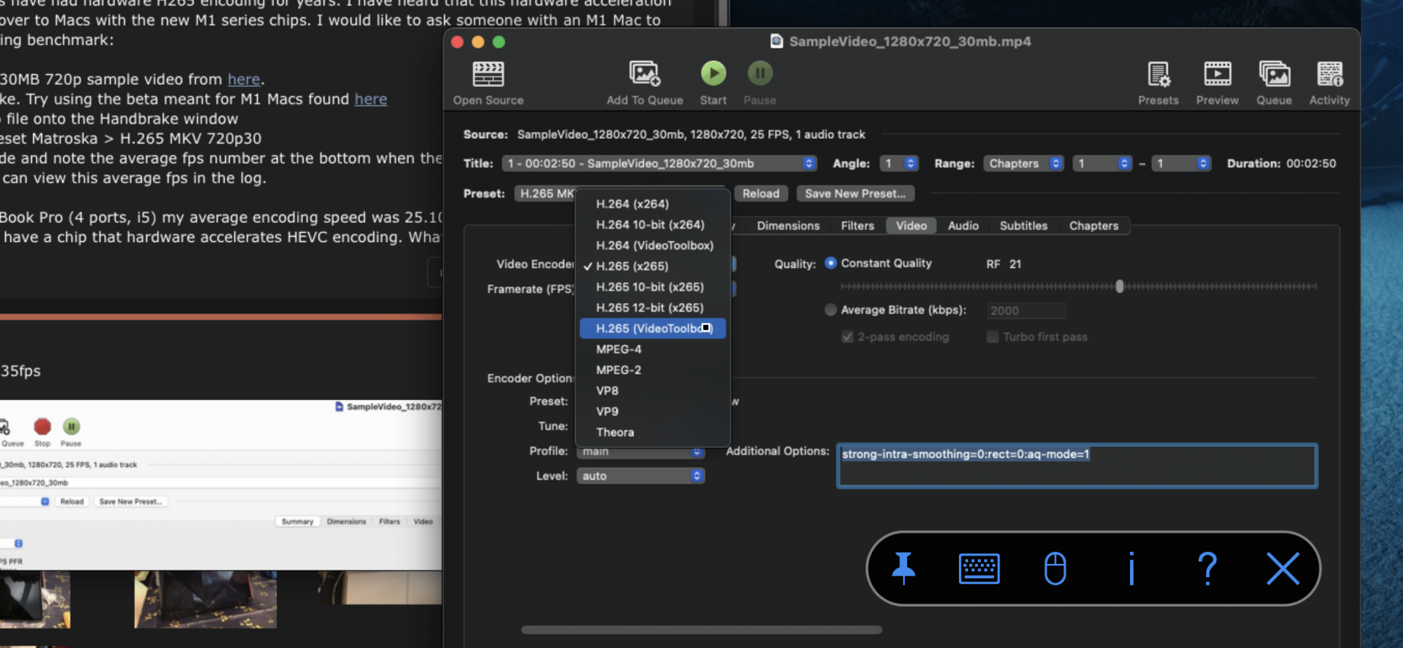

I just ran your test on my M1 mini.
By default the MKV H265 profile is using software encoding.
With Videotoolbox selected (hardware encoding), the encode finished in about 3 seconds.
Please excuse the quality of my screenshots, I was using VNC to remotely control the mini from my phone.
View attachment 1699982View attachment 1699983

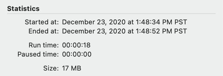

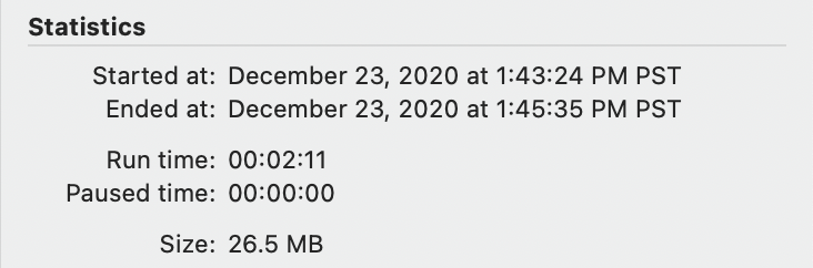

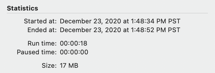

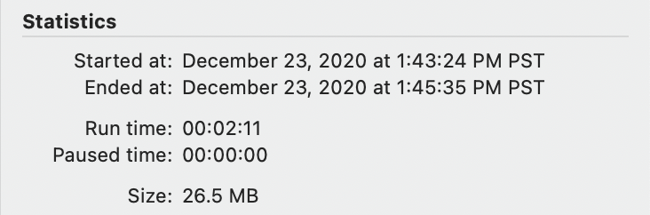

Yeah, already figured that one. It took 18s to encode with H.265 (VideoToolbox) vs 2:11 x265 on my M1 MBA (240-250 fps).

Looks like I was wrong about file sizes:
Hardware encode = 17MB
Software encode = 27.5MB

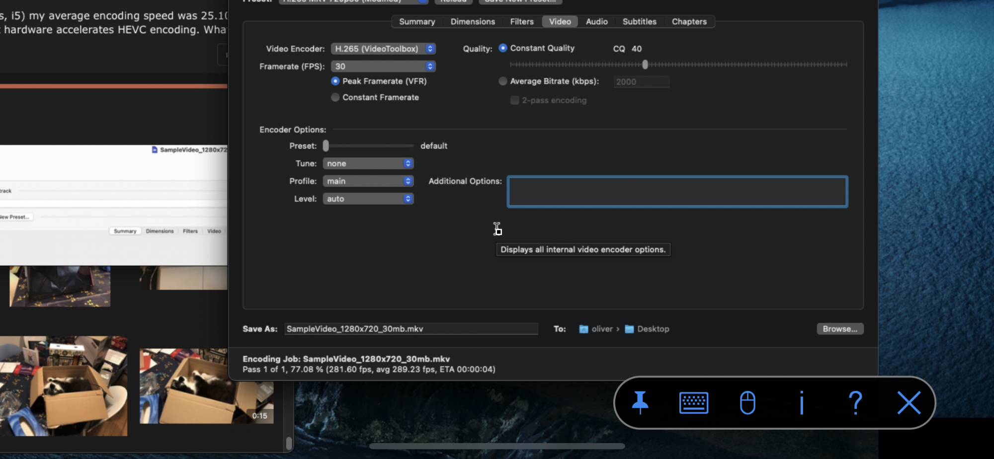

It's available in the latest beta, and maybe only available for Apple Silicon Macs. FPS is about 10 time faster.Screen Shot 2020-12-23 at 18.23.44.png
I will attach the output file here and you can see the quality for yourself.

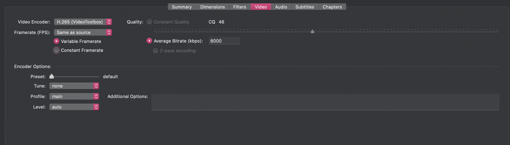

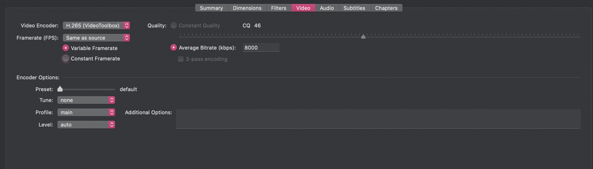

I see the CQ option with the latest beta, but I'm unable to change it on my intel Mac. Presumably it's only for the M1 Macs.
Average Bitrate is selected on your screenshot. Have you tried if you're able to select Constant Quality? You can't adjust the CQ slider if you don't have the Constant Quality button selected.
Yep, as you can see the radio button is grayed out. This happens for both H.264 and H.265 VideoToolbox, but it doesn't for the other options
