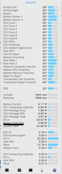

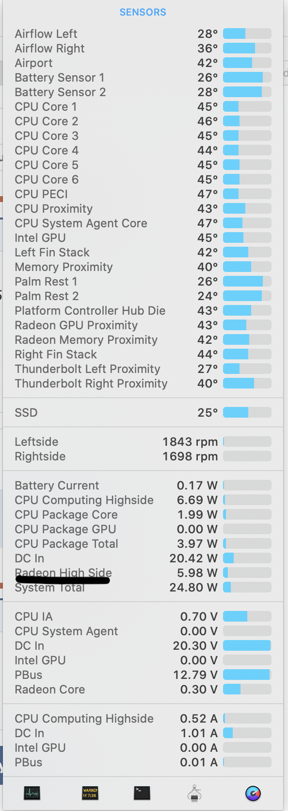

oh and are u reporting the radeon high side?
what resolution did u set the iMac's display?

can you test again with no apps open? and at idle?
i dont have that i'm going off GPU package watts
Imac is the native scaled 5k to 2560/1440.
