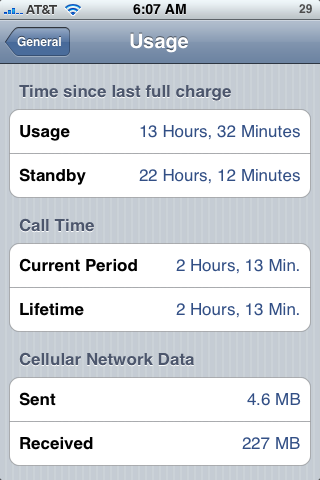

At the end, my iphone does look just like the picture below. I do not have a camera handy but thats how it looks. I also posted a snap shot of what the iphone gives me as far as user use. I'm not much of a phone person but I do use the phone VERY heavy at all times. Lost of browsing, you tube, stream music via wifi, 3D games, you name it. In the 2 weeks that I have done this to this phone (did it to another iphone but not with the batteries from ebay) I have had absolutley no problems at all. Just like other phone I did this to everything runs like OEM. Accept I get awsome battery life.
Anyways, thought I post this since I dont read much about iphone mods in forums so thought you might enjoy something different.
Thanks for looking.
EDIT: TO MENTION MY IPHONE IS JAILBROKED thats why you will see the number "29" showing battery power left.
