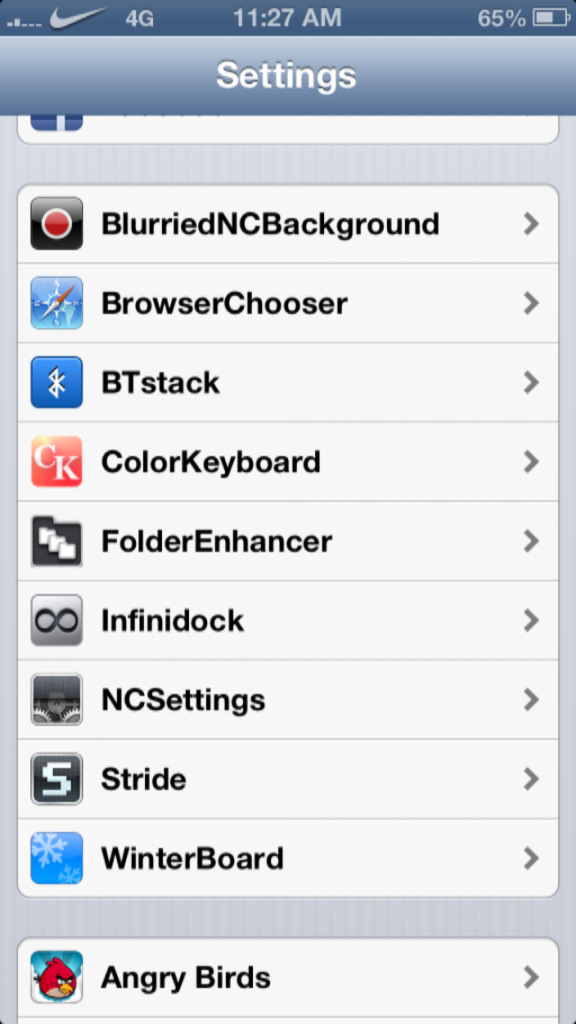

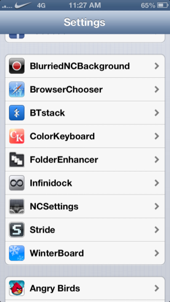

I have no idea what, but something's making my iPhone 5 die super fast, out of this list, what's most likely to cause it? ImageUploadedByTapatalk 21360697343.301585.jpg
Just curious - Why do you think it's an app? Most battery killers I've seen are related to calendar and mail sync issues.
I would be checking mail for a stuck message in outbox, disabling Exchange/Gmail/iCloud accounts that sync (ActiveSync) etc, and see if that helps calm things down first.
What does BTstack do, anyone know?
quick search on google:
BTstack stands for BlueToothstack. in other words, its a process that allows you to connect items such as bluetooth keyboards, or your apple magic mouse to the ipod for use instead of the touch keyboard, or touch screen.

I have no idea what, but something's making my iPhone 5 die super fast, out of this list, what's most likely to cause it? View attachment 396401
That's what it was for me too. Turn off Exchange until 6.1.2 is out.
TS I don't believe is any one of those, prob the exchange bug?
