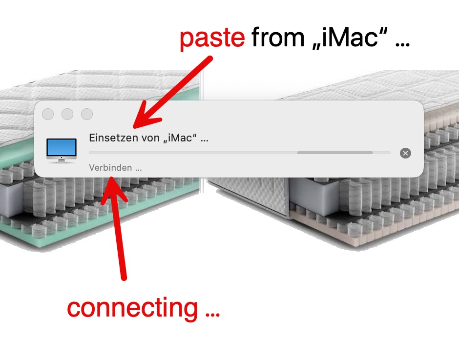

- My friend is working on my iMac 27’, 2019 (Mojave 10.14.6) in a pages-document and doing copy-and-paste - WiFi is turned off (and no LAN-cable is connected).
- At the same time I am in the same room and surfing the web (safari) on my MacBook Air M1, 2020 (macOS Sonoma 14.7) - WiFi is turned on (no LAN-cable is connected).
Both Macs are in the same Wifi-Network (but iMac-WiFi is turned off) and I never used file-sharing between the Macs.
- When my friend is copying text with the Apple Magic Mouse on the iMac often - when I am also doing copy-and-paste - the clipboard-text from the iMac is „transferred/transmits/jumps“ one-to-one to my Macbook Air.
Example:
My friend is copying the words „xy5xy5 zy2zy2“ on the iMac.
I am doing copy and paste in safari - but totally different things.
Then exactly the iMac-words „xy5xy5 zy2zy2“ jumps/transfers to my Macbook Air while I am doing totally different copy-and-paste (with my MacBook Airs built-in Trackpad).
So it "destroys and overwrites" my Macbook Airs clipboard contents.
During this, a small window on my Macbook Air opens up, which indicates that the two Macs connect for unwanted data-transfer.
- please see attachment -
- File sharing between the two Macs is turned off in system preferences.
- Also bluetooth File sharing is turned off in system preferences.
What is going on here and how can to stop this „connecting“ completely?
(I ask for your indulgence for my bad english, it is not my native language)
For Universal Clipboard to work, computers need to be signed in using the same Apple ID and Handoff is on. But Wi-Fi and Bluetooth also need to be on.

Just turn off Handoff.
