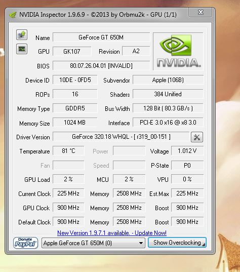

After installing the latest geforce drivers
I tried dota 2, and i had like 10 fps, i loaded up a onscreen display to found out my GPU was stuck at 225mhz clock.
When it supposed to be 900.
Its not warm at all, 60 degrees.
Tried PRAM reset.
Heres a pic from nvidia inspector, notice it says invalid bios?

Try PRAM reset again. Sometimes the attempt won't register for some reason. I've had to try a reset up to three times on occasion for things to finally go back to normal.
Also, it's probably SMC reset that you want to do (again, sometimes you have to try it a few times before it resets.) PRAM reset probably isn't going to affect your issue at all.
If that doesn't do it, then I agree ... something is very wrong with your GPU.
Perhaps its the drivers and not the GPU, i.e., software instead of hardware. Looks like you're talking about updating the windows video drivers. Downgrade those and see if that fixes it.
I had a similar issue with some failed driver installs. Or just some broken non compatible drivers. Got resolved by reinstalling different drivers.

Turn the gpu off for a few seconds on device manager than turn it back on. ITs a glitch with the Nvidia drivers no matter what driver you have on Mac.
