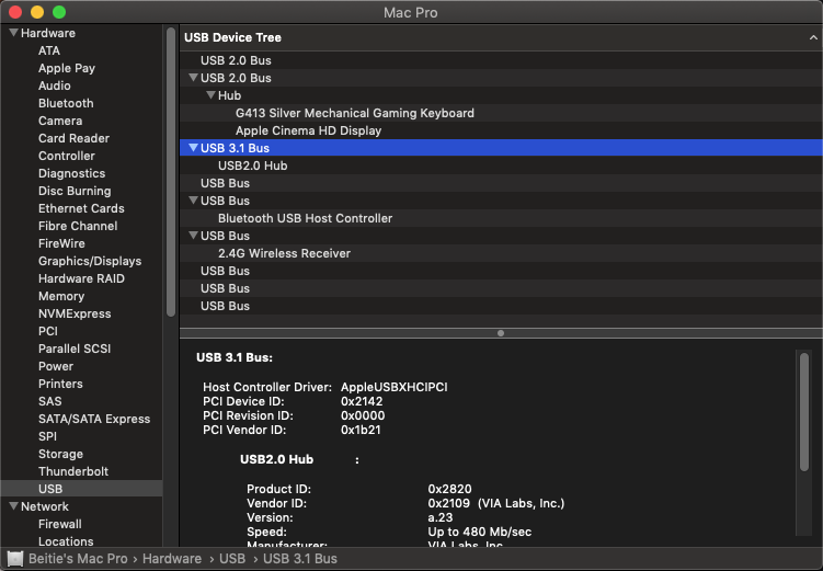

Hello everyone. So recently I purchased a Sonnet Allegro USB-C 3.2 Gen 2 card in hopes of having nice fast USB ports on my 5,1. I am using a ORICO 4 Port USB 3.1 Gen 2 HUB, connected with an Anker USB cable. My system report is showing the HUB as a USB 2.0 HUB, and I'm only getting USB 2.0 speeds on it. Does anyone know what I'm doing wrong here?
Before this, I was using a Inatek KT4004 card, and that was fine running the HUB at USB 3.0 speeds, though it also used a different cable.

Thanks @Sixtyhorses! I actually did figure it out. The USB cable I purchased was not compatable with the high speed data transfer. So for anyone reading this, if you're having the same issue, ditch the Anker USB cable! I went with one from TrippLite and it works fine.

For reference to others: I use an Angelbird USB 3.2 Gen 2 Type-C to Type-C Male Cable, which is overkill, but it maximizes the throughput potential thereby making the Allegro USB-C card with two Gen 2 USB 3.2 ports the bottleneck in the wattage transmission and Gbps. I am happy with this until I decide if I need an internal pcie storage/scratch disk at all.
