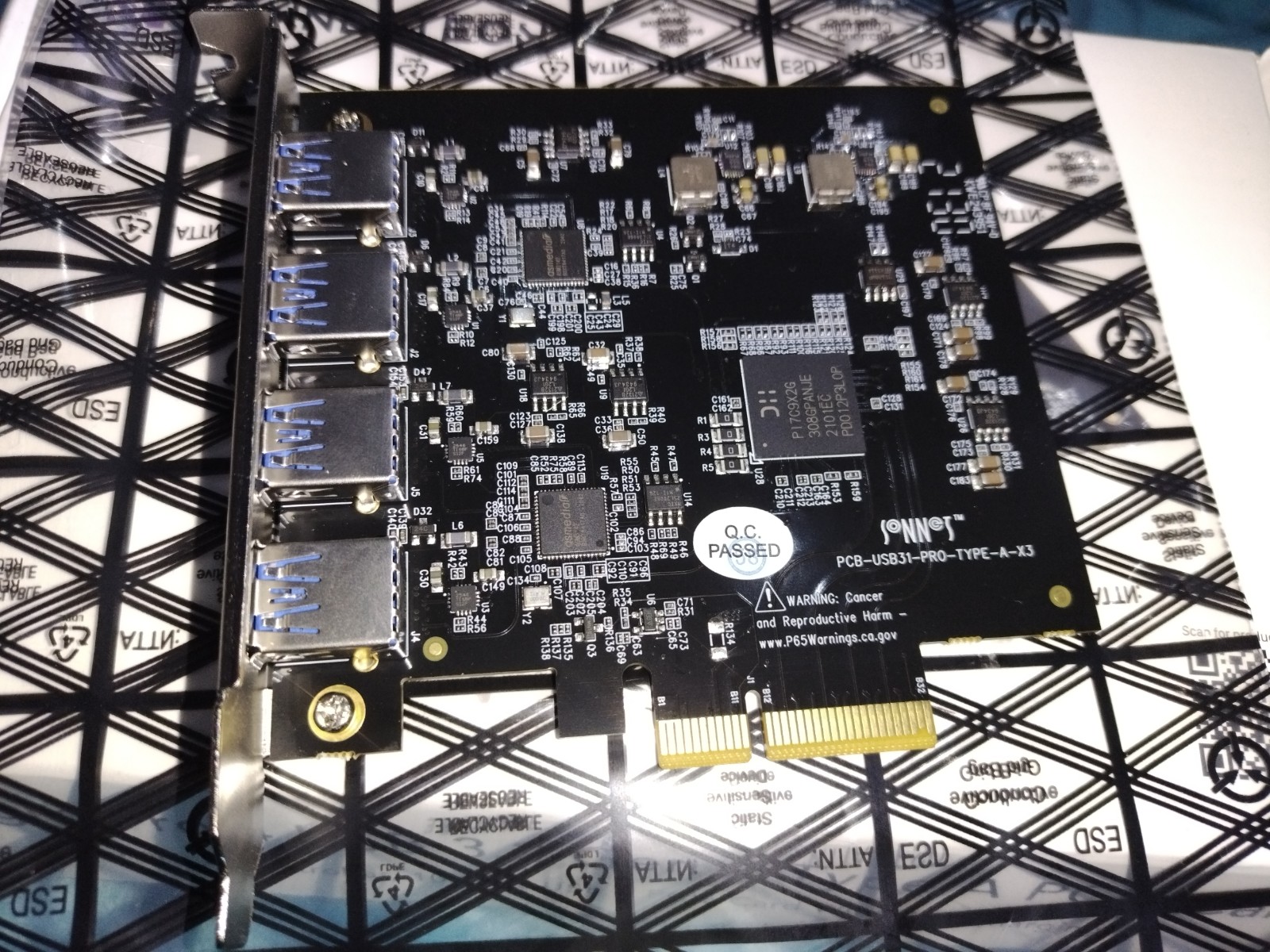

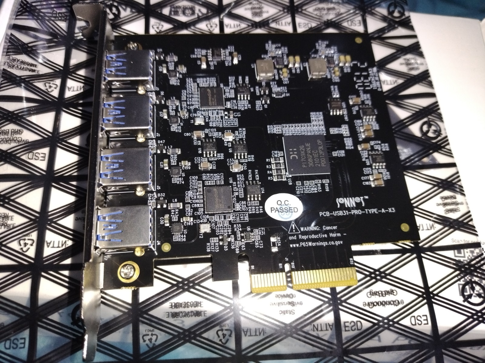

I bought a sonnet allergo pro usb card from ebay 1 year ago, they sold it quite cheaply, but since it was advertised as used, I thought that's why it was cheap...
then after the card arrived, it became apparent that the appearance of the card did not completely match the card displayed on the official website!
e.g. In the lower right corner of the card on the official website, there is a serial number (1825). The card I bought is missing this number and the parts are also different!
I was like, that's why you shouldn't buy anything cheap..
I just bought it from an official store and received the same card!

The same is the case with the card you just bought 🙁
My question is, is it possible that this card might be counterfeited and I managed to buy such a copy?
I am attaching pictures too!

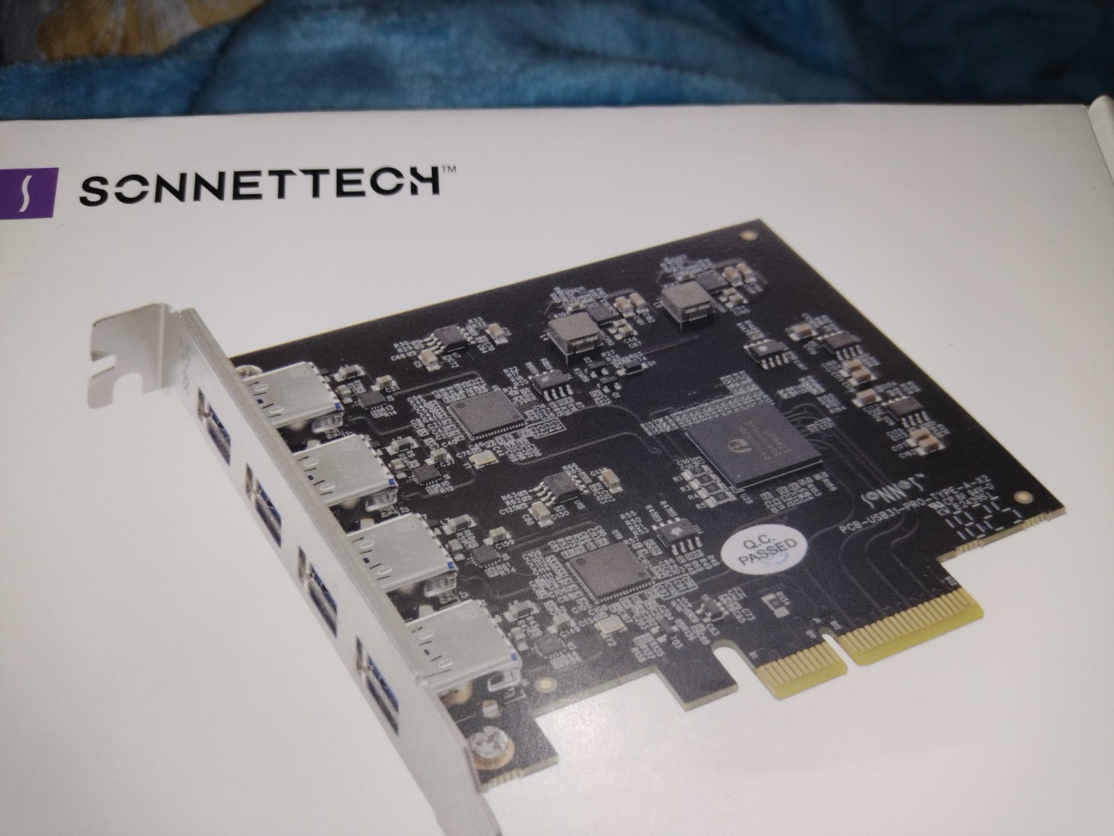

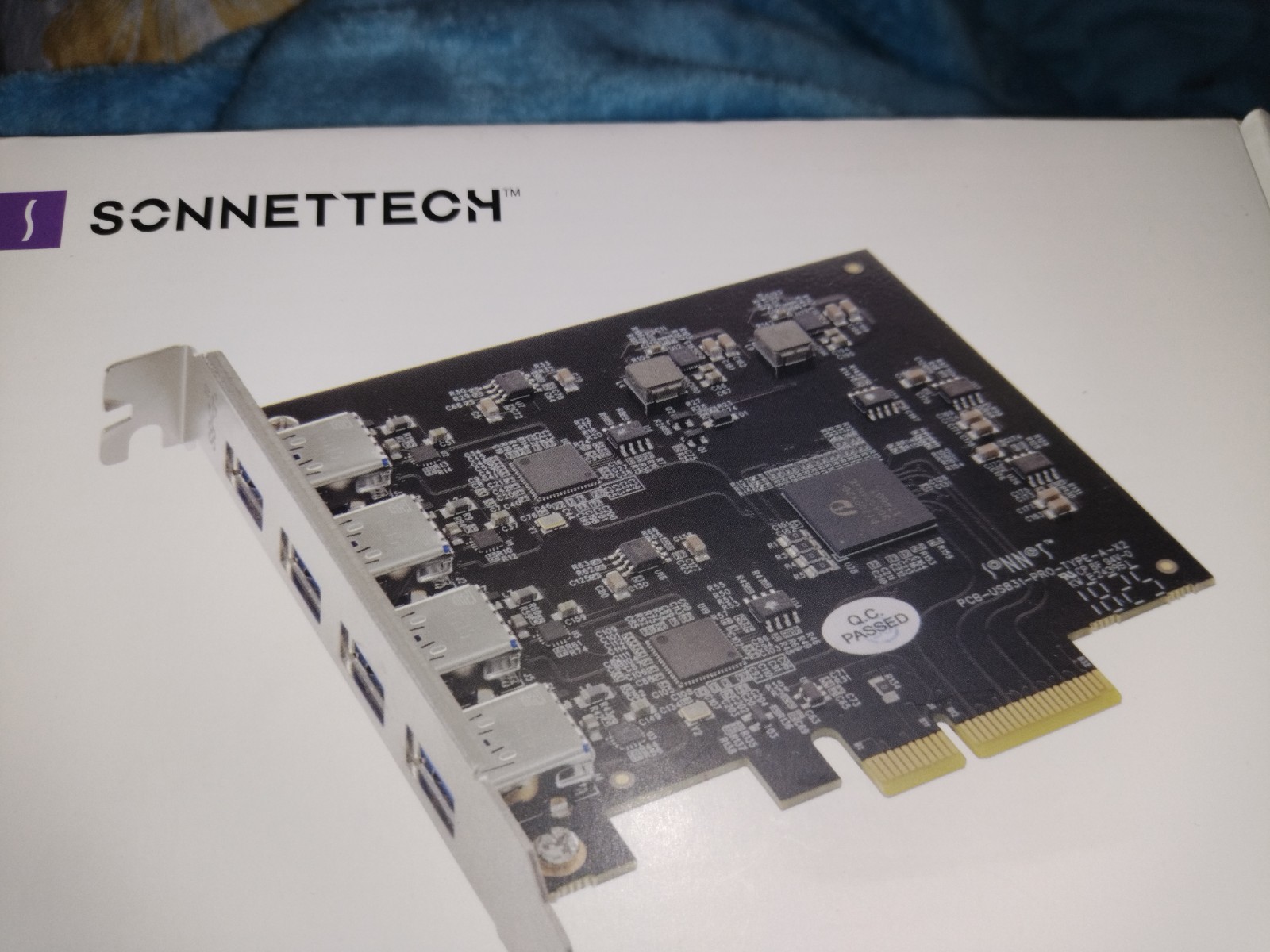

There is a picture of the "original" card on the box
however, if you look at the card, you can see the differences!

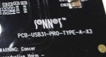

First picture shows "Type A X2", Second picture shows "Type A X3", so presumably a revision and update, or the first one is a PCI 2 card, and the second is a PCI 3 card?

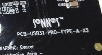

1825 is not a serial number, but a PCB production date marking:
  • first two digits are the year, 18 = 2018
  • last two digits are the week of production, week 25 = June 18 to June 24
The second card PCB production date is 2130, 2021 week 30, more than three years later.
Photo from the box is a revision 2 card while yours is a revision 3 PCB.

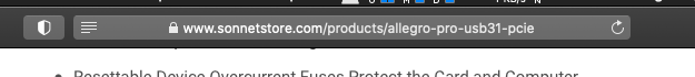

The sonnet allergo pro is a usb 3.2 gen 2 card! It is equipped with 2 controllers!

So, you have how much cards, this one is not the same as the photo from the first post.

Damn it! You're right. This card was sold to me as 3.2 gen2! And that's what it says on the box! However, there is really 3.1 on the motherboard
So, Sonnet is really being creative with the marketing and packaging, but not with the URL and PCB markings?
Even the URL still says allegro-pro-usb31-pcie, damn USB Implementers Forum and the spec rename that allowed this type of mess.

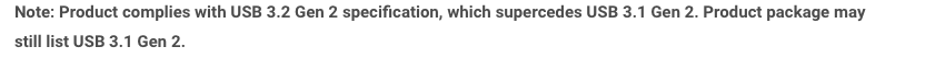

This is a pretty big scam and I wrote a complaint letter to the seller! I will be curious as to what answer I will get
I bet that they will say that the box and site were updated to reflect the USB-IF renaming of the prior USB 3.1 spec as USB 3.2 Gen 2.
USB 3.2 spec itself can be called a marketing scam:
