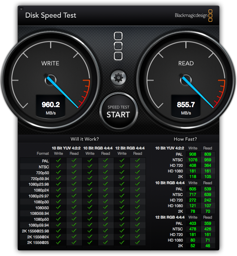

What kind of read and write speeds do you get?

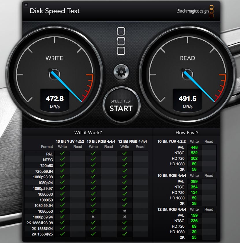

Yes I have 2 1tb 840 EVO's on mine and get the same speeds - it is nice and fast, although the boot manager deal is a know issue with the Sonnet and doesn't seem to matter about whether its matched with a video card w/no EFI. (I tried it with and without an EFI card and had the same issue on the boot manager)

Are you getting these speeds with RAID 0? and what model of Samsung do you use?

No, I am not using RAID at all. That speed test was made with a 500GB Samsung 840 EVO, my Samsung 512 GB 840 Pro produces similar results, and my Samsung 500GB series 840 is a bit slower.

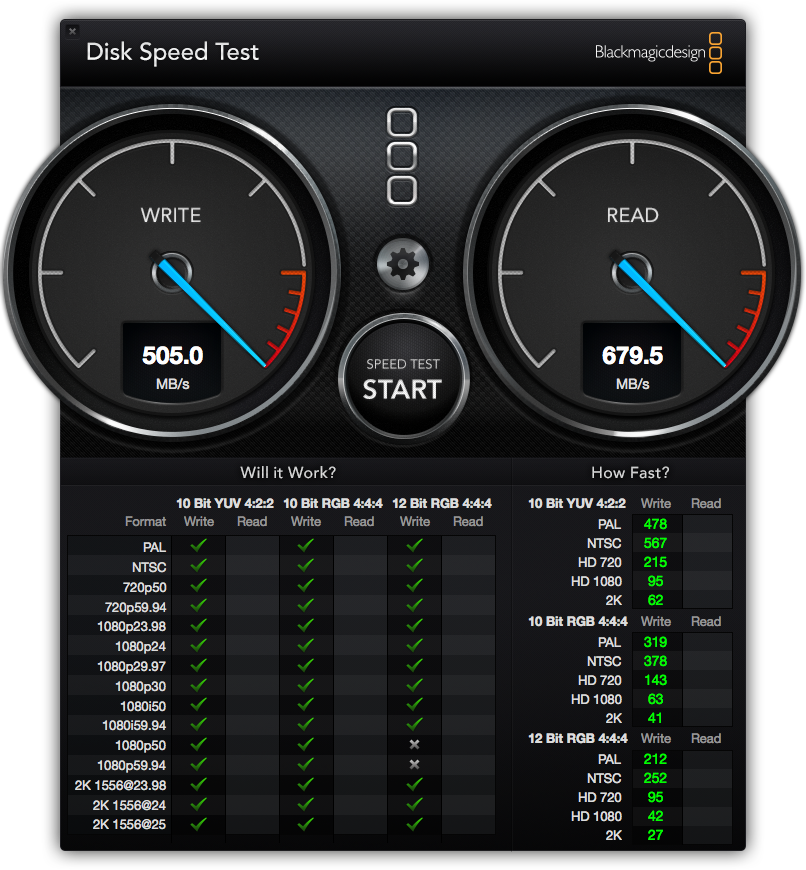

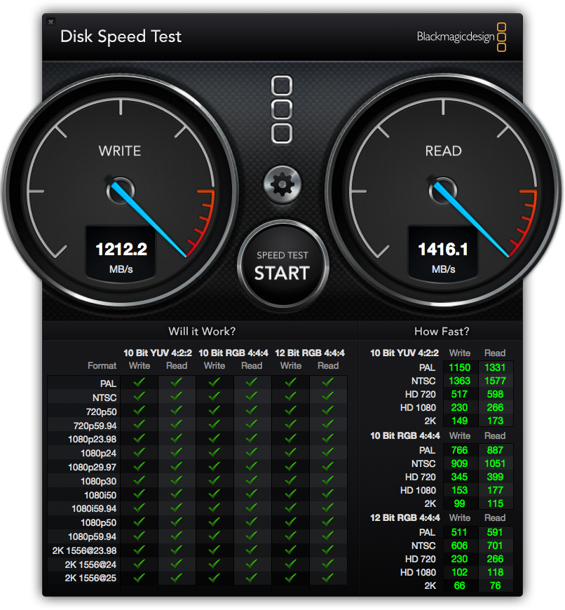

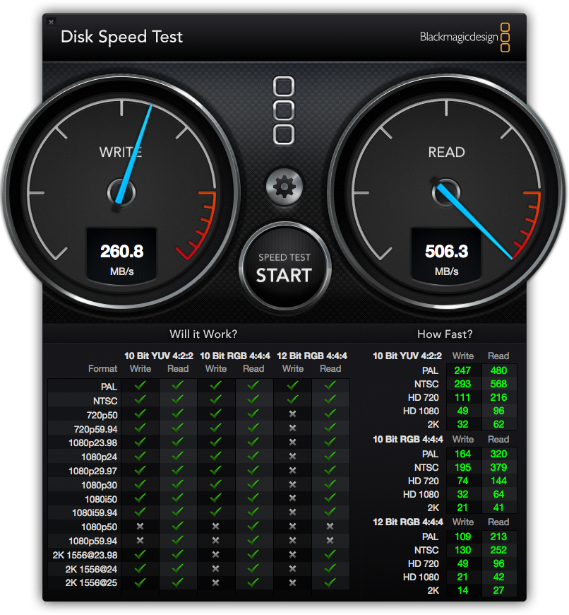

I have both the Sonnet Tempo Pro (non-plus) and the Velocity DUO x2 and ran a test of the RAID-0 performance with the same set of Crucial M4 512 GB SSDs on both boards in the same slot #2 on a Mac Pro 5,1. The Tempo Pro outperformed the DUO on read speeds probably due to the 4-lane vs. 2-lane capability. The write speeds were similar since the Crucial M4 have a fairly low write speed and were probably within the capabilities of both the x2 and x4 interfaces.
I have been running the Tempo Pro as a 1TB OS X boot disk for about 2 years now and really liked it. I purchased the Velocity DUO mainly for its capability to host a bootable Windows 8 SSD which the Tempo Pro will NOT do. I ran RAID-0 comparison just as a matter of interest. I currently have my Windows SSD on the DUO card, but have recently replaced the Tempo Pro with a 1TB Apple PCI SSD.
My best speeds were with a pair of Samsung 840 Pro SSDs where the write and read performance were more equally matched (807 / 956 MB/s). I only had a pair of 256 GB parts, so I ended up using the 512 GB M4s for greater capacity and didn't worry about the write performance.
Here are the Disk Test results I obtained:
Tempo Pro RAID-0 ---------- Velocity DUO RAID-0 (same set of SSDs) ------ Single M4 SSD on PCIe card
Hope this helps...
-howard
Hope this helps...
-howard

Howard: I think that your results with the read speeds demonstrate the limitations of the 2 lanes vs 4 lanes which has been my concern. The 2 lane card is 26% slower than the 4 lane card when reading from the drives.
Now that I have a clearer picture, I think I will invest in the Tempo Pro Plus for now and later on I will pick up the Apricorn Duo with two more 850 EVO and install either Windows 8.1 or 10 later on this year.

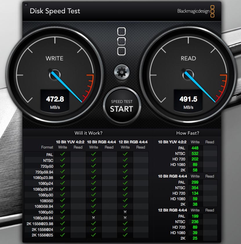

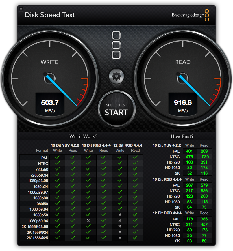

Here is the test on my MacPro with the Sintech card and Apple 1TB PCI SSD. Note, I do not have the super fast but unavailable SSD that was mentioned in that thread, I bought a slightly cheaper one on eBay as I think it is fast enough for me. 🙂
That is plenty fast for me. Those are the marks I was hoping to achieve with the SonnetTech Tempo Pro Plus in RAID 0.
