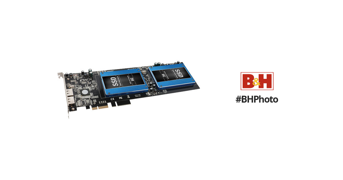

TSATA6-SSDPS-E2
Tempo SSD Pro Plus dual SATA3 + dual eSATA to PCIe 2.0 x4.
Product page https://sonnettech.com/product/legacyproducts/tempossdproplus.html
