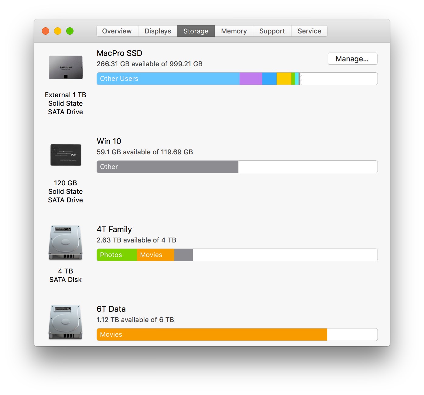

The only "problem" is that the OS thinks it's an external drive, so the icon for the drive in Finder is different than the other internal hard drives. It's purely cosmetic.

That hard drive icon can be change, you can change to whatever you want.
