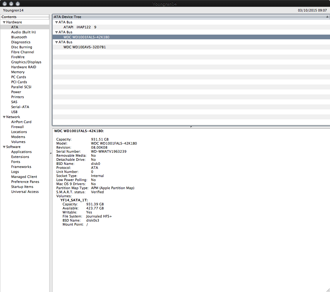

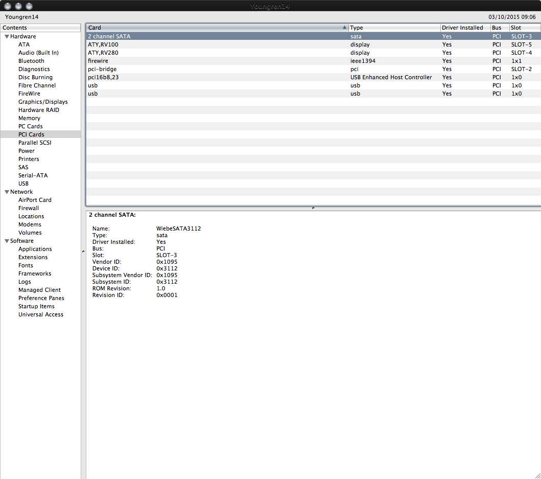

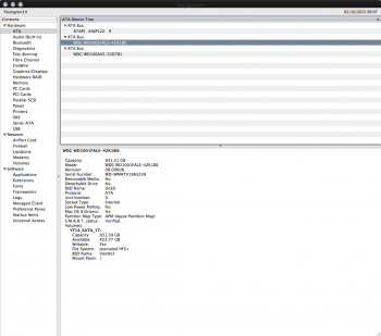

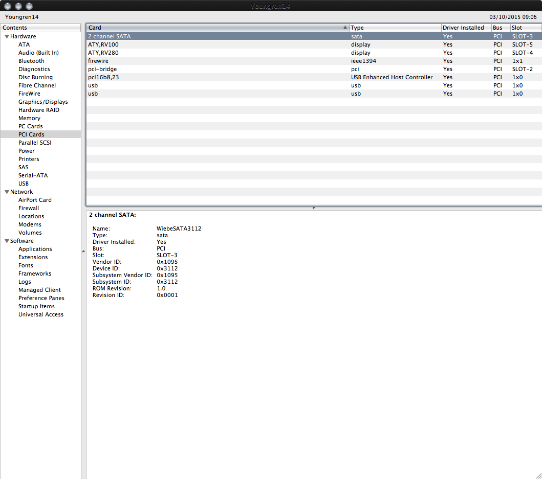

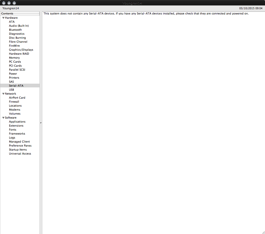

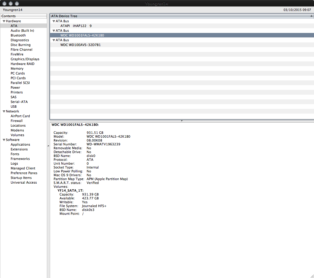

to further add onto what bun has said The SATA card I flashed using the guide on here shows up as an ATA Device not a SATA device. I would check ATA devices and SCSI Devices in system profiler see if your SSD shows up there
Yeah, mine is a $10 Windows/PC SATA card that I flashed using @harrymatic's directions. Reports only on the ATA bus just like LightBulbFun (Fan 😀).
