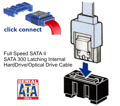

I also occasionally had the lock-up problem when transferring large files to a SATA drive connected to a SATA card. I believe it was because the SATA cable was not securely connected to the card. The cable I used was a type with a latch at one end while the card's connectors needed another type without the latch to fit snugly. In the end, I desoldered the card connectors and changed them to the ones that suited the cable's connector (finding the cable with the right length was harder than changing the card connectors for me) and the problem was gone.

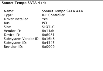

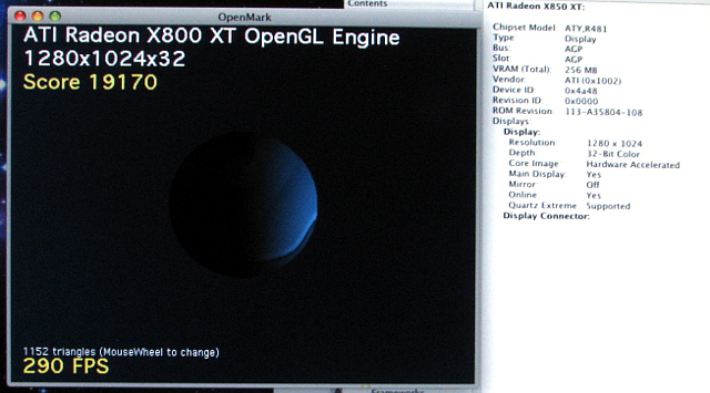

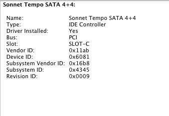

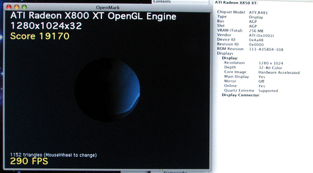

Here is what it is reporting after I run the installer but before the reboot and update rom cache. Not sure if there is a way to script the loading of the firmware manually. It seems to work fine until I reboot. This card also works in Windows as well. Any chance putting it in a Windows machine and swapping it back to Mac might fix it. On a side note, since I had my G5 open I started fiddle with X850XTPE that was not working before. I got that working again.
Is it totally consistent that when you reboot, the card won't be recognized?
If so, I could think of 2 reasons:
- Conflict with other drivers or other cards
- The card ROM doesn't get flashed properly. So the only time the card is recognized is just after installing the driver and before rebooting. And the reason you couldn't find the SonnetSATA.ktext may be because it was erased when rebooting and didn't get reloaded from the card as it should have been. Just a guess.
It is totally consistent, it happens on this G5 and on a G4 MDD that I tried it on. So it happens on different versions of OSX as well ( Leopard , Tiger ). The only other card is the video card. I have tried it with 3 different video cards. 2 flashed and one standard apple video card. The files are written to /tmp which gets dumped after a reboot according to Pacifier when I opened the pkg file.
