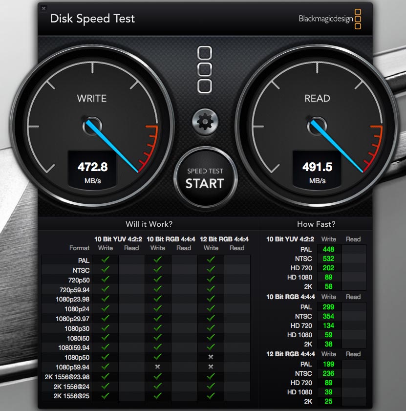

What kinds of speed are you getting. See after I installed my Mercury Extreme OWC SSD on my tempo card the write speed is way slower than when it was in the drive bay
I'll post my BlackMagic result. Samsung 500GB 840 EVO and Apricorn Velocity Solo x2.
Lou

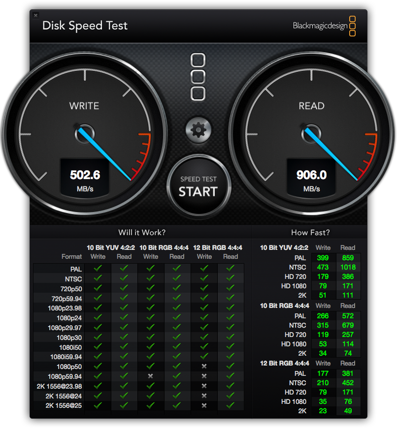

This is the BlackMagic DiskSpeedTest with a pair of Crucial M4 512GB SSDs in RAID-0 mounted on the Sonnet Tempo Pro SSD card.
500w/900r MB/s

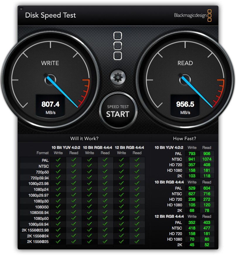

The second test is with a pair of Samsung 840-Pro 256GB SSDs in RAID-0 mounted on the Sonnet Tempo Pro SSD card.
800w/956r MB/s
Note: as mentioned above by crjackson2134, OWC drives with Sandforce controllers do not show well on Disk Speed Test due to the compression issues with video type test data. Use a different test program such as AJA System Test for a more realistic speed test.

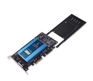

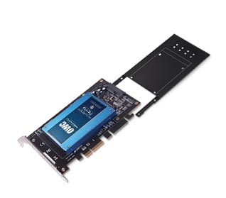

^^^^And what makes this really BAD, is that OWC is a distributer for Sonnet Products and the advertise the Sonnet Tempo Card with an OWC Mercury Extreme SSD on it. As most of you know, OWC is NOT my favorite supplier for Mac products. I avoid them at all costs.
Lou
