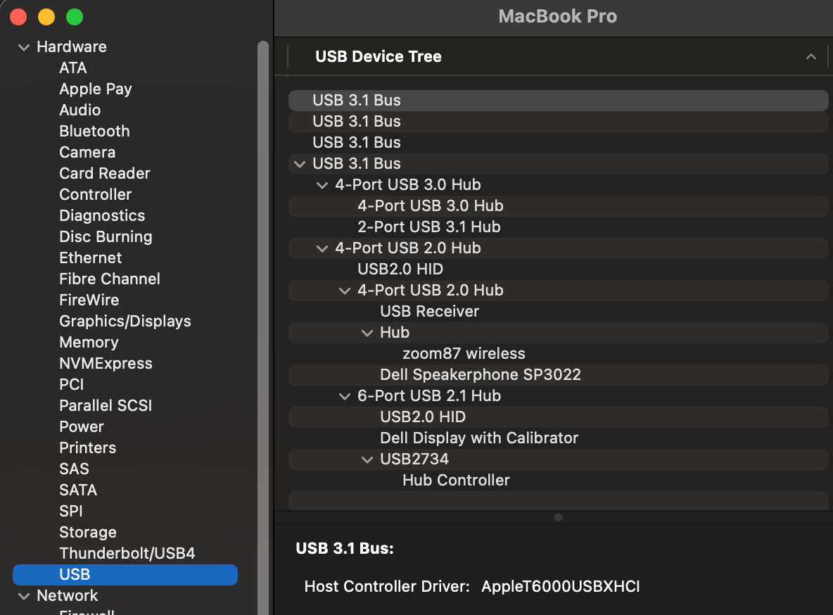

You may check the System Information app and see if the Dell builtin USB hub is still there. For me on UP2720Q,
