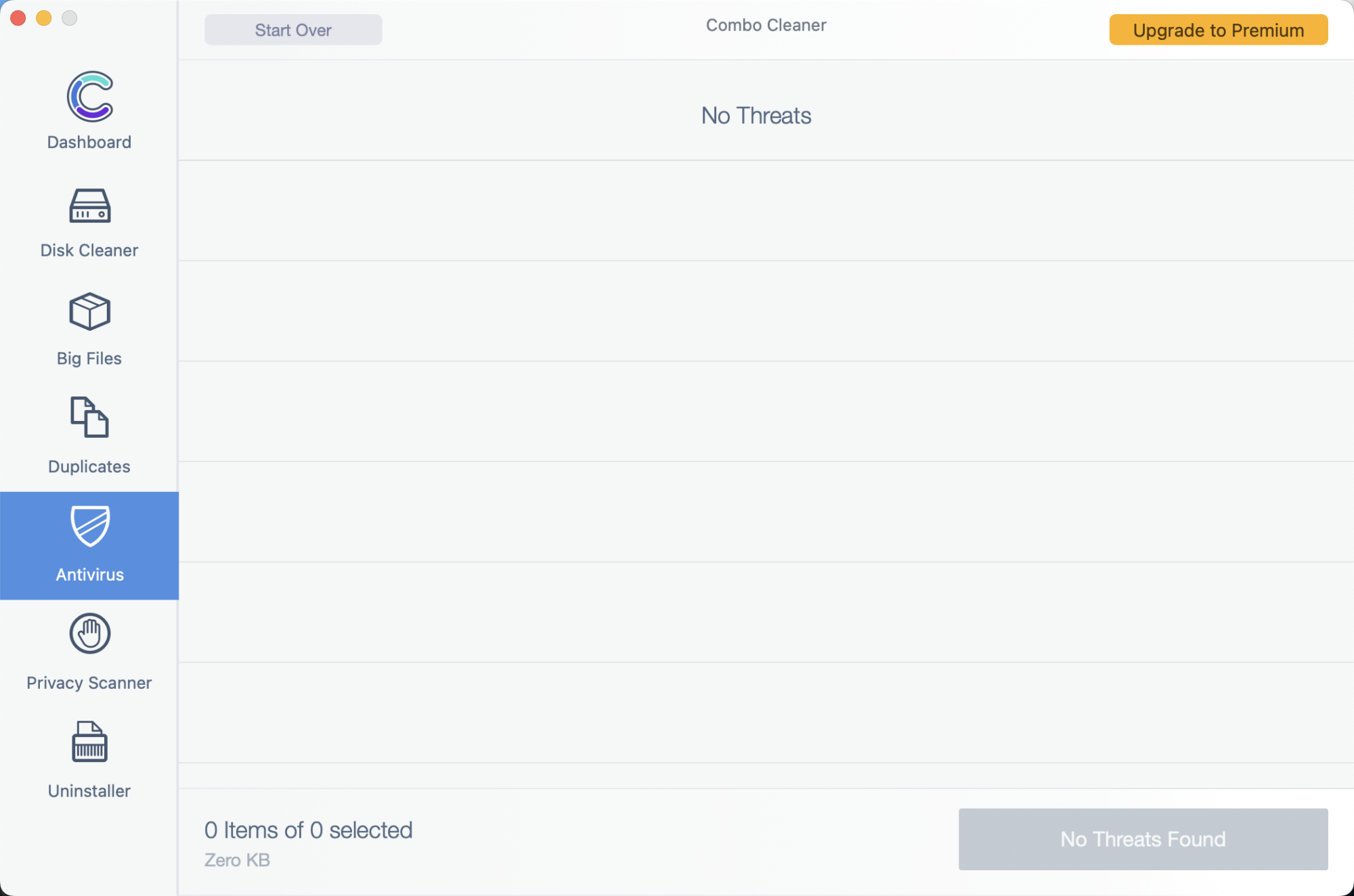

Thanks for this! The only free software I use is Aldente, which I recently downloaded, and on reflection coincides with when the issues started - but compounding that issue is when I installed the dev beta. I'll run a scan to be sure. I do have Citrix Workspace installed, but directly from Citrix.
Whilst it may be the malware version of vpnagentd, it may also be a legit version that has yet to be updated to support Sonoma. I suspect this is the case as I am not seeing the system error message "Vpnagentd will damage your computer".
As I thought...
OK, problem solved. I actually had Cisco Anyconnect installed from many moons ago to access my University. I've uninstalled and the issue is resolved. I'm really not sure why vpnagetd kept running, despite not opening the app for months. I'm sure the updated client would be fine, but I have no need for it anymore.
