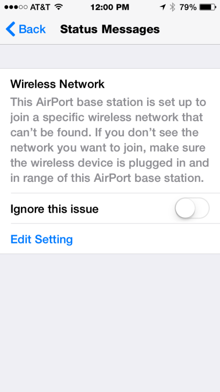

I did get a partial success in that plugging into my no-name router, I was able to get the following info with Airport Utility. Still don't see it in "Setting/Wifi". The screens below were with both networks operating. I'm unplugged now, but before I did that, I'm thinking I should have taken down the network from my Airport Extreme (2nd one in my "daisy chain").
