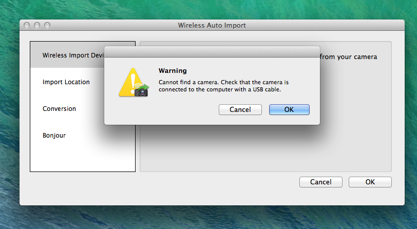

My new camera Sony A7 is supposed to be able to transfer photos wireless to my Mac.
But the application from Sony is unable to find my camera after I connect it to USB. Despite OSX picking it up both as a memory device, and iPhoto as well.
I have tried the different USB modes as well. But nothing works. It is simply unable to set it up.
Wat do?

....and I'm having the same problem. I can't get through to Sony support. I've found nothing so far on the Sony site and current forums.
Update
I finally got through to Sony. The person I spoke to researched it and reported that they are aware of the problem, which is with Wireless Auto Import and OSX 10.9. He said to watch their web site for a software update. He said they are "working on it" and that the update should be coming soon.
So, at least we know that the problem is not due to some convoluted configuration that we haven't figured out because the manual doesn't give you enough information.
Well, I don't think that 10.9 is the specific problem because it didn't work under 10.8 either....at least not for my Sony NEX-6. I've never had any success in getting wireless transfers to work.

Hi folks, just wondering whether this problem still persists. I have a Sony RX 100 II and have exactly the same problem. So, it's the Wireless Auto Import software rather than the camera I guess.
I've tried out PlayMemories, but that is not doing at all what I want.
Now very much relying on Wireless Auto Import and I find it very annoying that no one seesm to take an interest to get this working.
Doesn't Sony care about its reputation?
Possible solution for Sony Wireless Import
After beating my head against Sony support for a while, I think I've got the solution...
First, I set Setup/Access Point Settings to join my wifi network.
Then, and here's the key, USB Connect Setting must be set to "MTP" (instead of Auto, which normally selects Mass Storage).
Now, Wireless Auto Import setup should proceed normally (designation of the computer to transfer to, and verifying you have the desired directory selected).
To actually send the files to the Mac, select Edit/Copy from the main menu, and "Send To Computer."
To regain USB functionality, change the USB Connect Setting back to Auto.
Worked for me!

Hi twideman,
I was really hopeful when I saw the outcome of your interaction with the Sony helpdesk and tried it out immediately for my RX 100 M2. However, with negative result. The step "Send to Computer" results in a message "Connecting", which stays in the screen for a minute or so, before an error message pops up that a connection with the access point has been established, but a connection with the computer was not possible.
I found it unbelievable that Sony does not take any action here to come up with a solution that works. Maybe it has worked in the lab once or twice, but it definitely does not work in real life situations.
Update:
I got it a kind of working now. This is what I've done:
- Reset the connection details at the camera. Entering the password (WPA2) manually did not work! I tried 2 different SSID access points (each with its own password), and both attempts were unsuccesful. Finally, used the WPS option and that worked.
- However, picture transfer still interrupted at the first .MTS file. Interstingly, I couldn't find this .MTS file on the card at all
- Have deleted all videos manually via the camera interface and checked the integrity of the picture database. Still the same; transfer started, but crashed after a while.
- Restart of camera (taking out the battery for a while) and rebooting the laptop did not help either.
- Finallly, copied all pictures from the card manually and reformatted the SD card (via the camera option).
- Rebooted again and took 1 picture.
- This time the transfer completed! Then tried with 2-3 pictures and 2-3 videos. This also worked, as it did originally when the camera was new and I tried the wireless transmission with a small number of pictures.
Now curious to see what will happen when I'm not in test mode but in real-life mode with 100's of pictures and 10-'s of video's. Will it start to break again?
