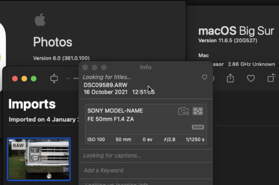

It was easier than I thought 🙂
Could you please share a small raw image created by ILCE-7M4 to test if it really worked.
Just a screenshot of the process, I’ll explain more if it worked.

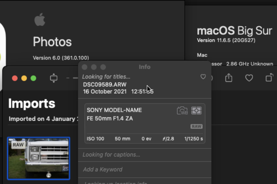

Fantastic! The only problem is to get small Raw picture . Going to try
Even a photo of a pencil on a white sheet is 36 MB

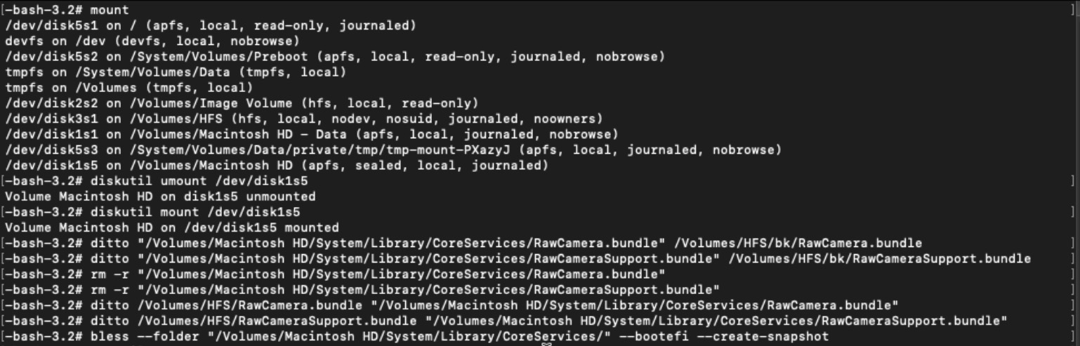

Here are the steps I took :
- format an USB disk as MBR/HFS+ with the name HFS
- copy RawCamera.bundle and RawCameraSupport.bundle from Ventura to the HFS USB
Code:
sudo ditto /System/Library/CoreServices/RawCamera.bundle /Volumes/HFS/RawCamera.bundle
sudo ditto /System/Library/CoreServices/RawCameraSupport.bundle /Volumes/HFS/RawCameraSupport.bundle
Reboot using a bootable installer (should work from Recovery too)
- disable SIP and authenticated-root from Terminal
Code:
csrutil disable
csrutil authenticated-root disable
- reboot and boot again using the bootable installer or recovery
- from Terminal list mounted volumes
Code:
mount
- unmount the system volume
Code:
diskutil umount /dev/disk1s5
- remount the system volume to make it writable
Code:

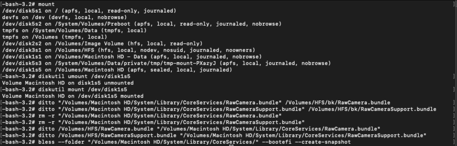

diskutil mount /dev/disk1s5
- make backups of rawCamera.bundle and RawCameraSupport.bundle
Code:
ditto “/Volumes/Macintosh HD/System/Library/CoreServices/RawCamera.bundle” /Volumes/HFS/bk/RawCamera.bundle
ditto “/Volumes/Macintosh HD/System/Library/CoreServices/RawCameraSupport.bundle” /Volumes/HFS/bk/RawCameraSupport.bundle
- delete the two system files
Code:
rm -r “/Volumes/Macintosh HD/System/Library/CoreServices/RawCamera.bundle”
rm -r “/Volumes/Macintosh HD/System/Library/CoreServices/RawCameraSupport.bundle”
- copy the files from Ventura
Code:
ditto /Volumes/HFS/RawCamera.bundle “/Volumes/Macintosh HD/System/Library/CoreServices/RawCamera.bundle”
ditto /Volumes/HFS/RawCameraSupport.bundle “/Volumes/Macintosh HD/System/Library/CoreServices/RawCameraSupport.bundle”
- make the modified system volume bootable
Code:
bless --folder "/Volumes/Macintosh HD/System/Library/CoreServices/" --bootefi –create-snapshot
- reboot and enjoy updated RAW support 🙂

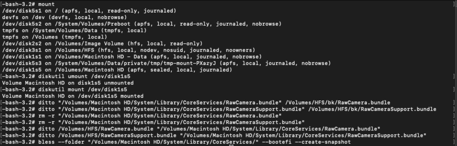

Code:
Code:
csrutil disable
Code:
mount
Code:
Code:
Code:
Code:
Code:
Code:
You can’t turn SIP on, the modification will be reversed.
Off course, the files will be replaced by any system update.

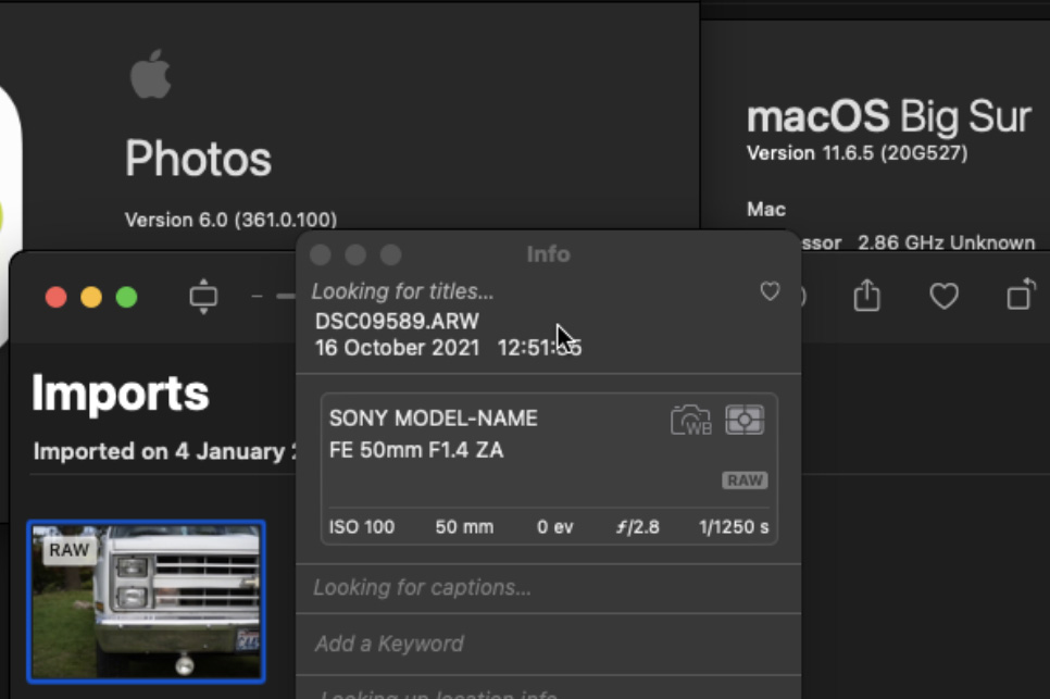

An update on what happens after an update 🙂
The virtual machine was running Big Sur 11.6.5 and today I’ve updated it to 11.7.2. As expected, the bundle files were replaced. The image imported before was still visible in Photos, but a new image was imported as blank. I’ve replaced again the bundle files with the ones from Ventura and I had to delete the second image from Photos and import it again in order to be properly displayed.
