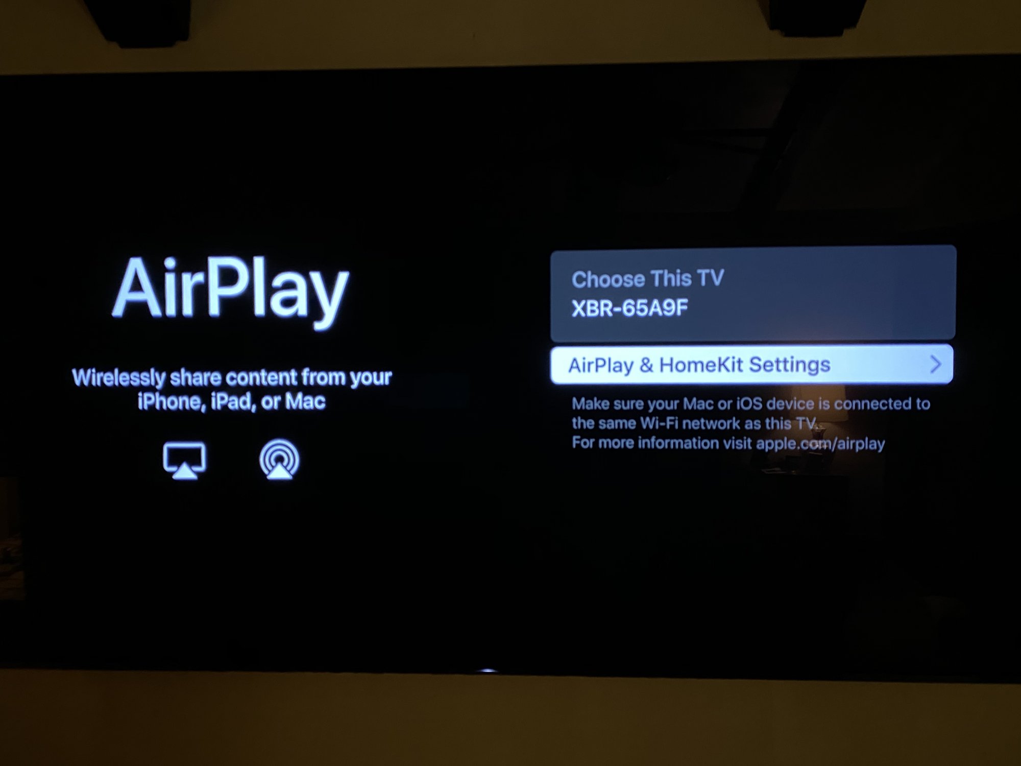

well it was a royal pain to force the update, but its finally done and the integration is flawless. Works very well. It also appears its setup now for updates from Apple to occur in the apps and no longer require the long wait for another FW update

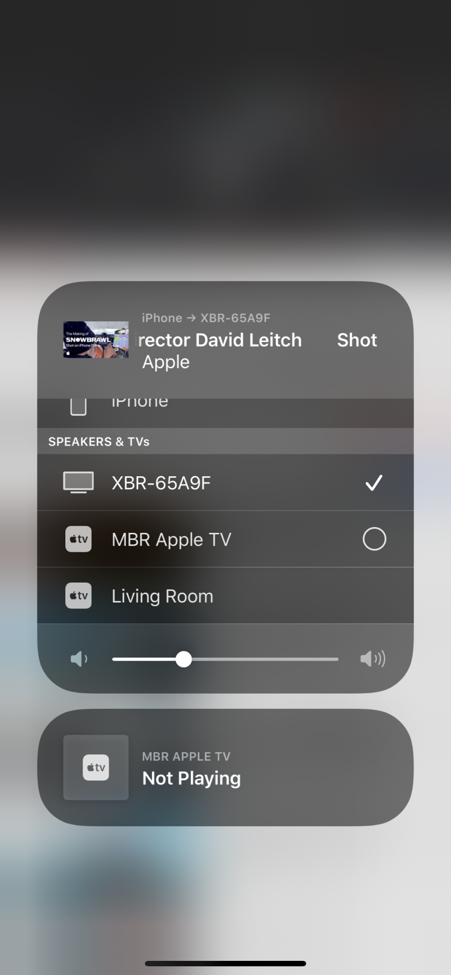

Too bad you can't send audio from the TV out to external speakers or an airport express...this would make for a whole house audio setup to select different rooms/zones of audio from the Sony TV via Airplay 2.
You may be able to. A box pops up asking to select "Speakers and TV"...and you can select multiple. I don't have separate speakers set up on HomeKit right now to test. I'll try later. But I was able to select The Sony + Apple TV
What do you mean it was a pain to force? How complex can it be beyond going into the menu and check for update?
Yes, it was a bit of a pain. My TV did not recognize flash drives formatted on a Mac. I had to use a PC to format the drive. Also you have to unzip the file on a PC to get the correct .zip file that the TV recognizes. Not the simplest process but I was able to get it done.

For anyone else, you don't have to go through all that trouble of using a PC. Use Disk Utility to format the USB drive as FAT32 with Master Boot Record. Also, turn off Open "safe" files after downloading in Safari preferences. Once the primary Zip file is download, double-click the zip file to unzip the actual firmware "zip" file. Then copy that to the USB drive.
