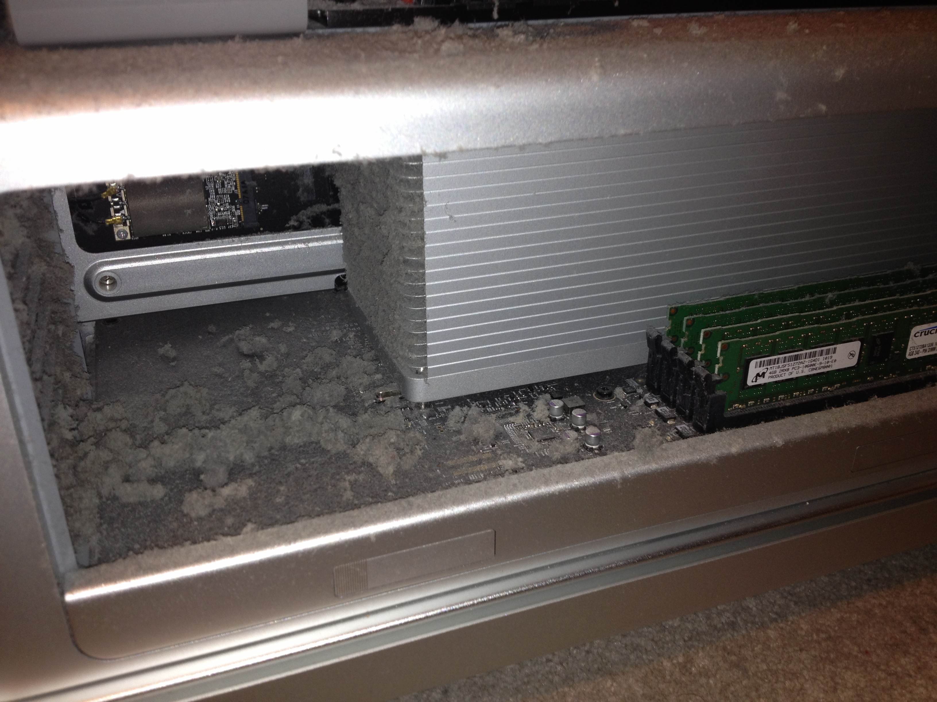

Hey guys, Ive have my MacPro since the last update and have never really given it a spring clean. I opened up the case the other day and was shocked to see how dusty it is inside. I don't no much about how sensitive the insides are so am seeking advise on how to safely clean it. Do I need any antistatic gloves or anything? What are the ideal or suitable tools i should use... I've read people use hoovers but they just seem very harsh!? bearing in mind the cost of the machine i want to be extremely careful!
Thanks in advance

I use an air compressor for monthly blow outs....
I've never seen one like yours though!
Do you live on a sheep farm ??? 😀
I thought I was the only one that used a air compressor 🙂
Works great and gets into areas a vac can't.
OMG! Take it out side with a few cans of Compressed air. Take all the components out and blow them off separately.
I take mine all apart every month or so.
I use an air compressor for a monthly blow outs....
I've never seen on like yours though!

I'm more concerned about your health rather than the Mac. The picture tells more about the air quality of your room. Seriously!

Do you have lots of cats? Dogs? You might think about an air filter. I just opened mine to check, and your Mac Pro looks much, much dustier than my Early 2009 model, and I've never cleaned it out. I have a dog, but I hear cats are the worst for dander and hair in electronics.

Do you smoke? I only see stuff like this when people keep the machine in a place they smoke a lot.
No no I don't smoke, It sits on a carpet floor under my desk and whats worse is I've probably only switched it off a handful of times. I tend not to open in it as I don't want to break anything. The irony is by not doing so I have probably done more harm.
