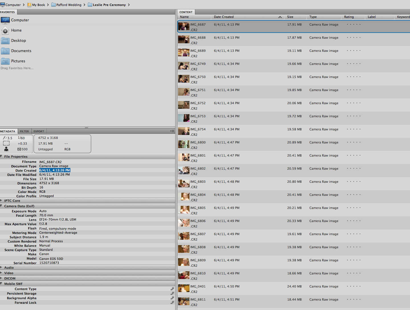

I've pinpointed where my problem is, hopefully someone will be able to answer?
In Adobe Bridge (CS5) in the Metadata tab, I see all the metadata info of my photos to the left. The date created shows the hour, minute and seconds.
But in the Content info to the right, the date created only shows hour and minute. I am assuming this is why I cannot sort to the second accurately in the Bridge Sort option.
So now my question is: how do I make the seconds also show up in the Content, or the image properties? It is there in the metadata....so now I just need it in the content.
I've attached a screen shot of the issue to make it even more clear, hopefully.

I figured out that if I rename it in lightroom the seconds do in fact show up, but this must be done on import. So there was my problem, we'd already imported and I couldn't get the seconds in the name after that. But if you rename on import, it works.
