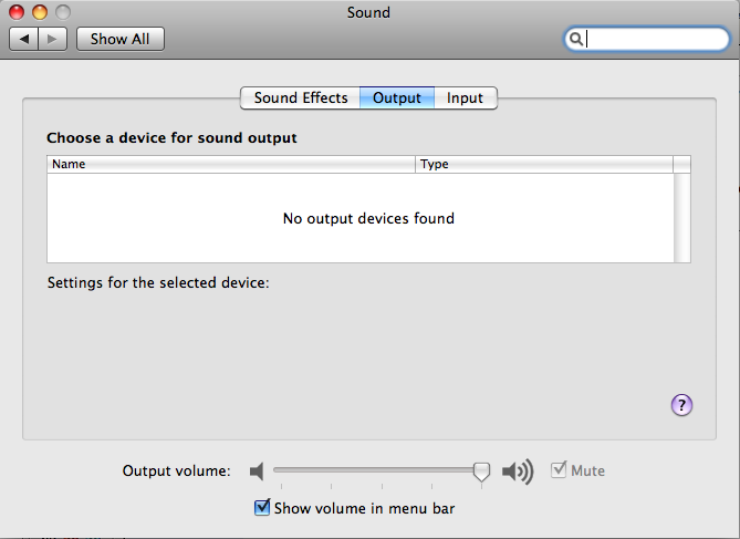

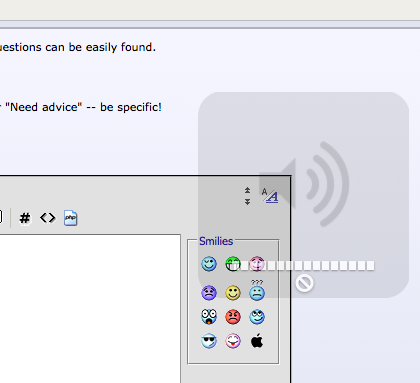

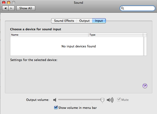

Whilst listening to iTunes, my music cut dead. I couldn't adjust the volume. There was a big delay between pressing the volume keys and the volume icon appearing on screen.
Then I got a 'kernel panic'.
I rebooted, and now whenever I press the volume up/down key I am presented with this volume icon (please excuse the composition I had to screen grab it quickly whilst on screen):
Hmm... that it coincided with a kernel panic is disconcerting.
If you're lucky, the panic somehow corrupted the sound driver. The easiest way to test this would, I think, be to boot from the reinstall disc it came with and see if you can adjust the sound there (I think you can adjust the sound in the installer...). If this is the issue, an archive-and-install OS reinstall is probably the easiest solution.
If you're not so lucky, the sound chip fried, crashing the OS and then disappearing entirely. This would be the case if a reinstall fails to bring it back, though it should still be under warranty so Apple will fix it for free. Not sure if running the hardware test disc that came with the computer would show this as an issue or not, but it's not difficult to check.
It's also possible that something in the firmware just flaked out; you could try resetting the PRAM and PMU (Google or a forum search will give you instructions for both for your model). May not help, but can't hurt to try.

Did an 'Archive and Install', and now Final Cut Pro Studio won't open on my machine. Quits 'unexpectedly'...
WTF?
Apps that aren't installed via a simple drag and drop (that is, ones that have an installer that puts components in system folders) often need reinstalling after an archive and install. I know Adobe's CS products are in this group, and I wouldn't be at all surprised if FCP and friends are too; reinstalling it should get you back in business.
Did that fix your audio problem, then?
CS3 seems to be ok, but I'm re-installing FCP Studio now.
It fixed it.
MacBook Pro back in action! Thanks!
Glad you got your issue sorted midi. Seems like you had to jump through some hoops to get there.
