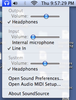

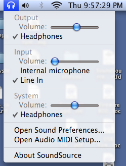

Update:
I just downloaded SoundSource 2.0 -- still no joy. As you can see from the
screen grab below, there's no "Internal Speakers" option when something
(anything!) is plugged-in to the "Headphone" jack.
...does anyone see both "Internal Speakers" and "Headphones" ?
LK
No, it doesn't allow both headphones and internal. If you have headphones plugged in, then it replaces the Internal selection. What I did to work around this was I bought the iMic on Ebay for $22 and it turns a headphone connection into a USB. So I could plug my stereo or headphones into the iMic which is run USB, freeing up my headphone jack. THEN I can use SoundSource to select between iMic and Internal speakers. MUCH easier than going thru System Preferences and Sound and changing it that way.

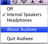

What about Audieee. I have it on my hack netbook. It allows my headphones to be plugged in and I can still play from the internal speaker just by making a selection.
Is that the type of thing you're looking for?
Yes, but does it allow sound to come out of both at the same time? Our goal here is to use iMic or the Headphone port to play to speakers, and still get sound from the iMac internal speakers at the same time. I still have not figured out a way to do this.
