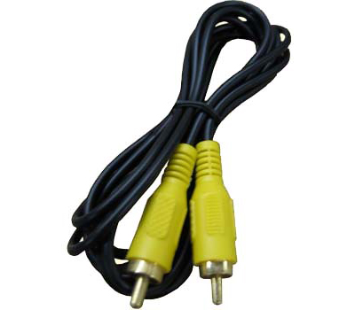

connect the DVI adapter to your MBP. Then you need a male-to-male composite video connector, like this:
One end plugs into the yellow jack on the DVI adapter, the other end plugs into the yellow jack on your TV. That takes care of video.

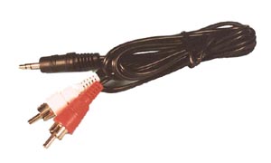

For audio, if you want the sound to come out of your TV's speakers, you need a minijack-to-RCA audio cable, like this:
You plug the minijack end into your MBP's headphone jack, and the red and white plugs into the red and white jacks of your TV.

You're not getting any sound because you're not connecting the audio to anything. As CrzyCanuck72 said, you need a 3.5 mm mini-plug to RCA adapter, which you can find cheap at Walmart or Target. Another example of the cable is http://www.walmart.com/catalog/product.do?product_id=3913841. You plug the one part into the headphone jack on the Macbook, then plug in the RCA ends into your TV where the red/white jacks are.

now, to get the sound you need a jack to composite audio cable (means jack on one end and to composite plugs on the other end red and white (these two plus are the ones you plug to your TV) the jack end plugs on your laptop left side.
the audio cable looks like this
