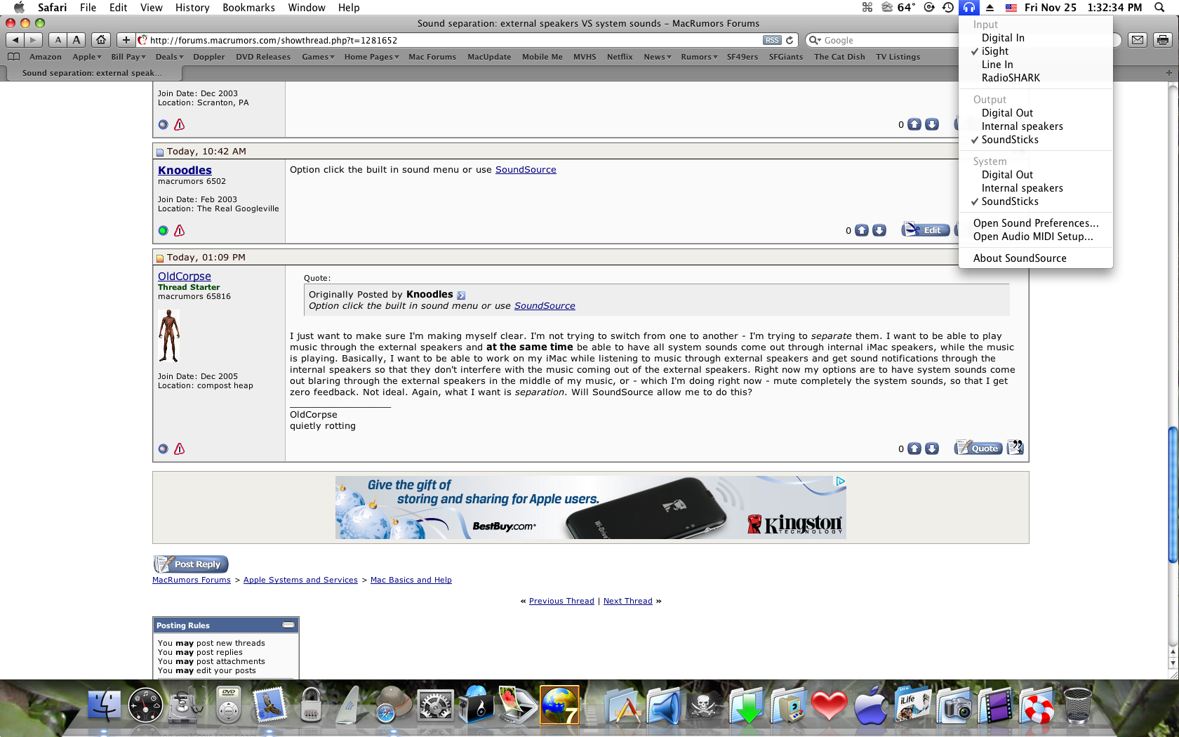

Option click the built in sound menu or use SoundSource
I just want to make sure I'm making myself clear. I'm not trying to switch from one to another - I'm trying to separate them. I want to be able to play music through the external speakers and at the same time be able to have all system sounds come out through internal iMac speakers, while the music is playing. Basically, I want to be able to work on my iMac while listening to music through external speakers and get sound notifications through the internal speakers so that they don't interfere with the music coming out of the external speakers. Right now my options are to have system sounds come out blaring through the external speakers in the middle of my music, or - which I'm doing right now - mute completely the system sounds, so that I get zero feedback. Not ideal. Again, what I want is separation. Will SoundSource allow me to do this?
