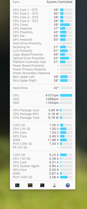

Hope you can help. it sounds as tho the fan is running too fast on my imac. This has happened a few times before and Ive resolved it by resetting the SMC. I tried that several times this time around, but no change.
I downloaded the free trial of iStat which is showing the CPU (or the fan of the CPU?) is running at over 4000 RPM. I live in Australia, but today is a cool day!
Is there anything else I can do to fix or investigate the problem (I dont have any technical knowledge beyond user level) or will I need to take it in to a store?
I havent made any changes to the hardware or installed any new apps recently, the problem just seemed to come out of the blue.
many thanks, Rich

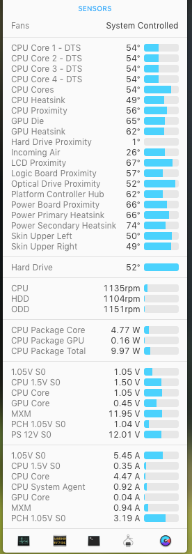

many thanks for your reply. i switched the machine back on to check the year (you're right its mid-2011) and low and behold the fan is now running normally. Could be just because its had time to cool I suppose? Since I restarted it about an hour ago, the CPU heatsink has been gradually rising (currently up to 52 degrees) with the CPU fan stable at around 1000 RPM, so perhaps it was an SMC issue after all?
Meanwhile I noticed the Hard Drive temperature is listed as 52 degrees, with the blue 'status bar' completely filled in. Not sure if thats something I should be concerned about .. the hard drive fan is operating around 1100 RPM.
warm wishes
Rich

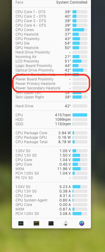

I suspect the power board sensor causing the issue (working intermittently). When there is lack of data, the associated fan will work to 100% to avoid possible overheat. Your fan run at high speed actually means SMC is working as expected.
I believe when you perform the SMC reset in the past, you actually reset the sensors, not really the SMC. That's why it can fix the issue (when the sensors are successfully reset).

thanks for the tip on the fan controller. My last screen shot with 52 degrees on the hard drive was after an hour of intense use (running Logic Pro X and a RAM hungry virtual piano). Currently its 48 degrees after an hour of internet browsing and netflix. I googled the safe operating temp of the processor and from this post on the Intel site it looks like i might be in the clear, but Ill keep an eye on it.

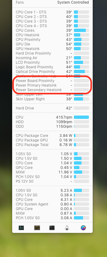

I suspect the power board sensor causing the issue (working intermittently). When there is lack of data, the associated fan will work to 100% to avoid possible overheat. You fan run at high speed actually means SMC is working as expected.
I believe when you perform the SMC reset in the past, you actually reset the sensors, not really the SMC. That's why it can it the issue (when the sensors are successfully reset).
So the lack of Powerboard data would make the CPU fan run like that? Ok, thanks will keep an eye on that.
