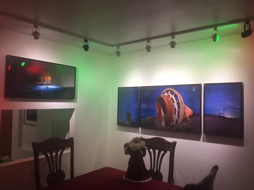

As for the other part of your post. A 42” printer is on my short list of gear. It will probably move up if I ever get back into a gallery space. All my past gallery work was done with a chromogenic process and standardized for display at 12x18 and 20x30. This allowed me to flip the gallery every month. The biggest print I’ve sold was a four foot pano, also a chromogenic print.
The largest piece I’ve produced was a quadtych that measured 24x84 not counting the gaps between frames. For that project I used about 80 feet of 24 inch paper to make 15 images. They were all diptychs, triptychs and quads. Here’s one of the triptychs hanging at home:
These I printed myself on Epson Metallic Glossy paper and they compare well to the lab printed chromogenic prints. I actually preferred the depth of color on the inkjet prints. They were done on the last generation Epson printers, not the current machines.

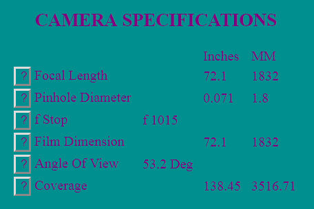

what sort of aperture are you using?
The calculations above show f1015.
