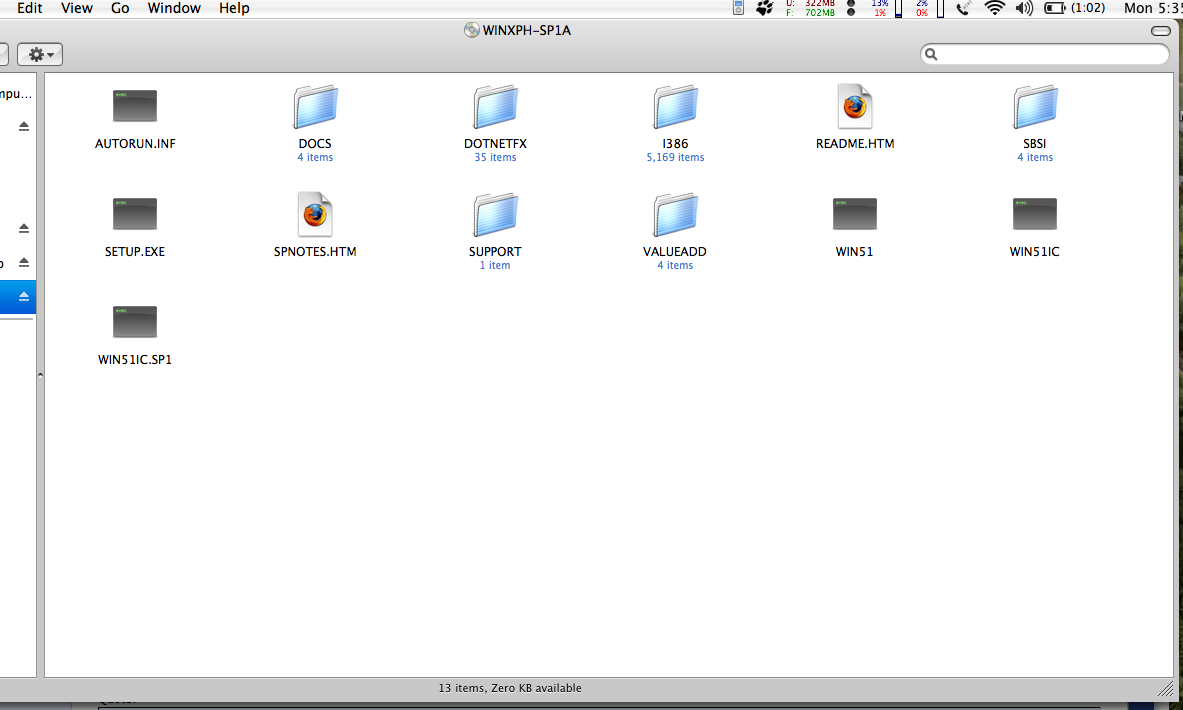

sounds like a good idea. unfortunately, all i see is this:
I think they're in i386. Get rid of the *.sp1 file too.

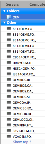

sound the *.sp1, SVPACK.inf, and SVPACK folder.
didn't find $OEM$
anyway, spotlighting OEM gave me this:
didn't find $OEM$
You probably don't have one then... It's just for things like custom wallpaper and the like....
