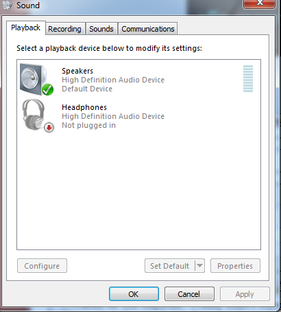

It looks like everything is set up correctly on the device side. Boot Camp is all up to date (3.2) and I've been trolling the web for days looking for updated audio drivers. It's driving me crazy!
Are there lots of MBA Late 2010'ers with Win 7 boot camp installs working without any audio issues? Everything else is perfect, but I never realized how much of a pain it is to grab a pair of headphones every time I need audio.

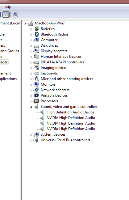

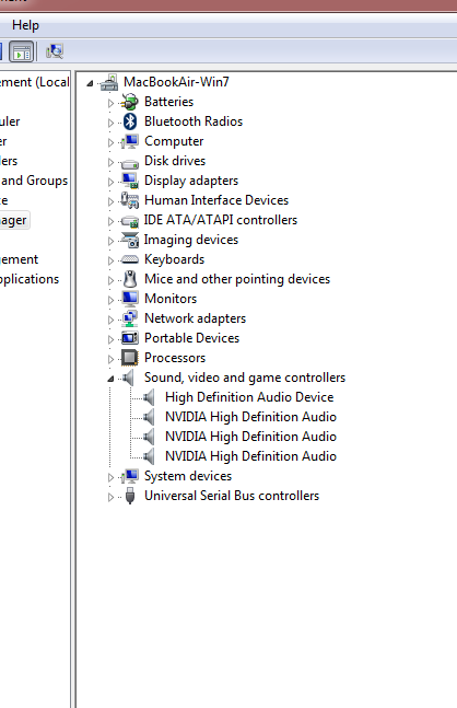

That screenie looks the same as my 11" Air with W7 Ultimate SP1, and audio is working fine on here.
Can you go into the Start menu, right click Computer, click Manage, then click Device Manager on the left hand bar. Check whether or not if there's any errors under the Sound menu.

That's what I was afraid of... 🙁 Everything's good as far as Win reports. Device Manager is clearn. I'm sure the 11 and the 13 have same audio drivers - just can't figure out why it worked for the first few reboots, but discovered the problem after all updates and service packs were installed.
