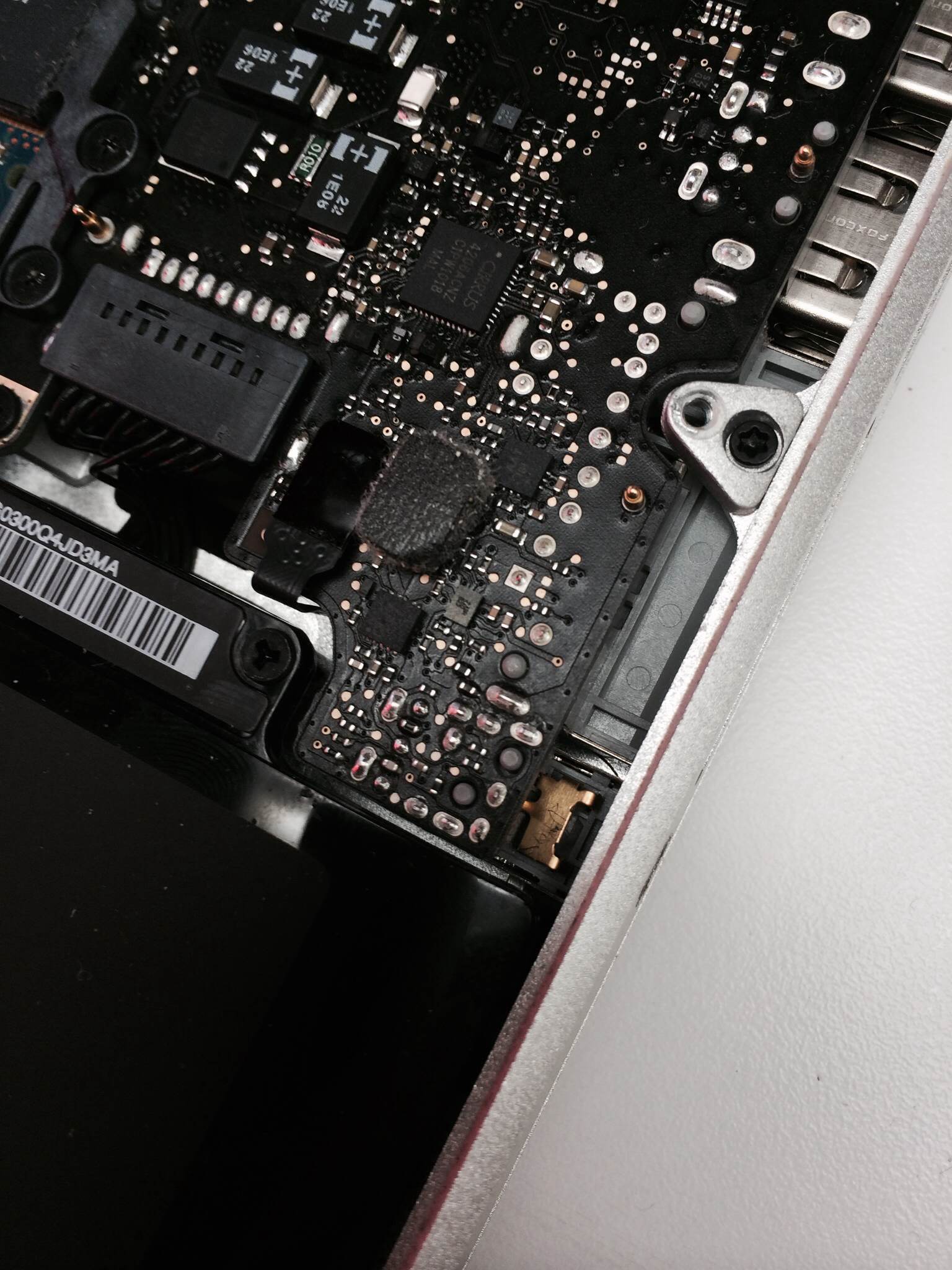

Two photos here:
- the jack stuck in the port
- the logic board - the headphone port is where the light brown rectangle is

The proper way to go about this is to desolder the headphone port from the logic board then solder on a replacement one. You can't push it from the back unfortunately.

I don't own a power drill. I thought of going by the local hardware store to borrow one. Still, the thought of having someone drill into the area makes me nervous. For every time this approach works, I wonder how often it does more damage.
About desoldering the headphone port from the board, how advanced is this work? I found a step-by-step guide to removing/replacing the logic board online, and that in itself seems feasible. The repairman who volunteered to help specializes in PCs. I don't get a sense he's done anything quite like this on a macbook before. That also makes me a little nervous...

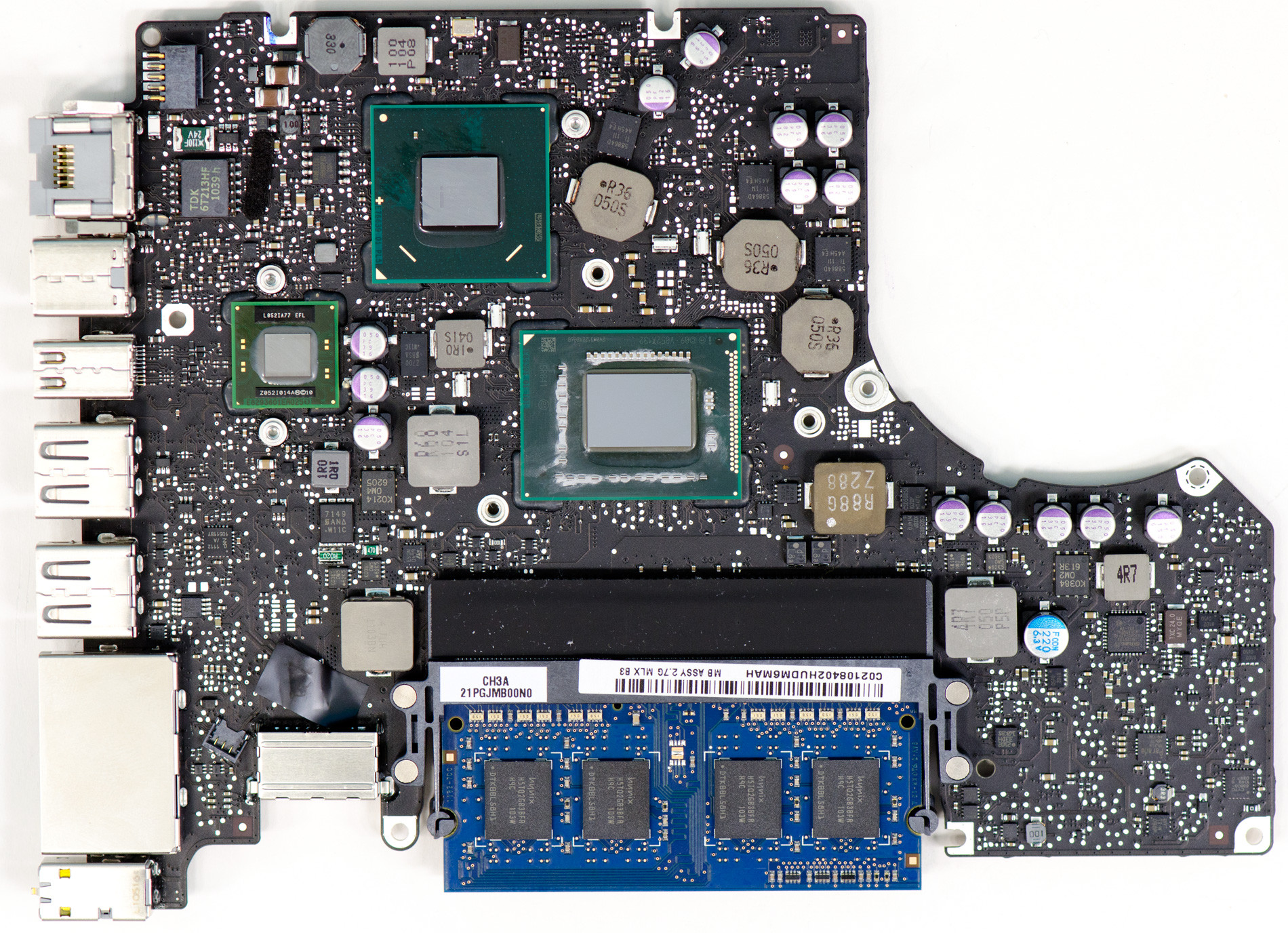

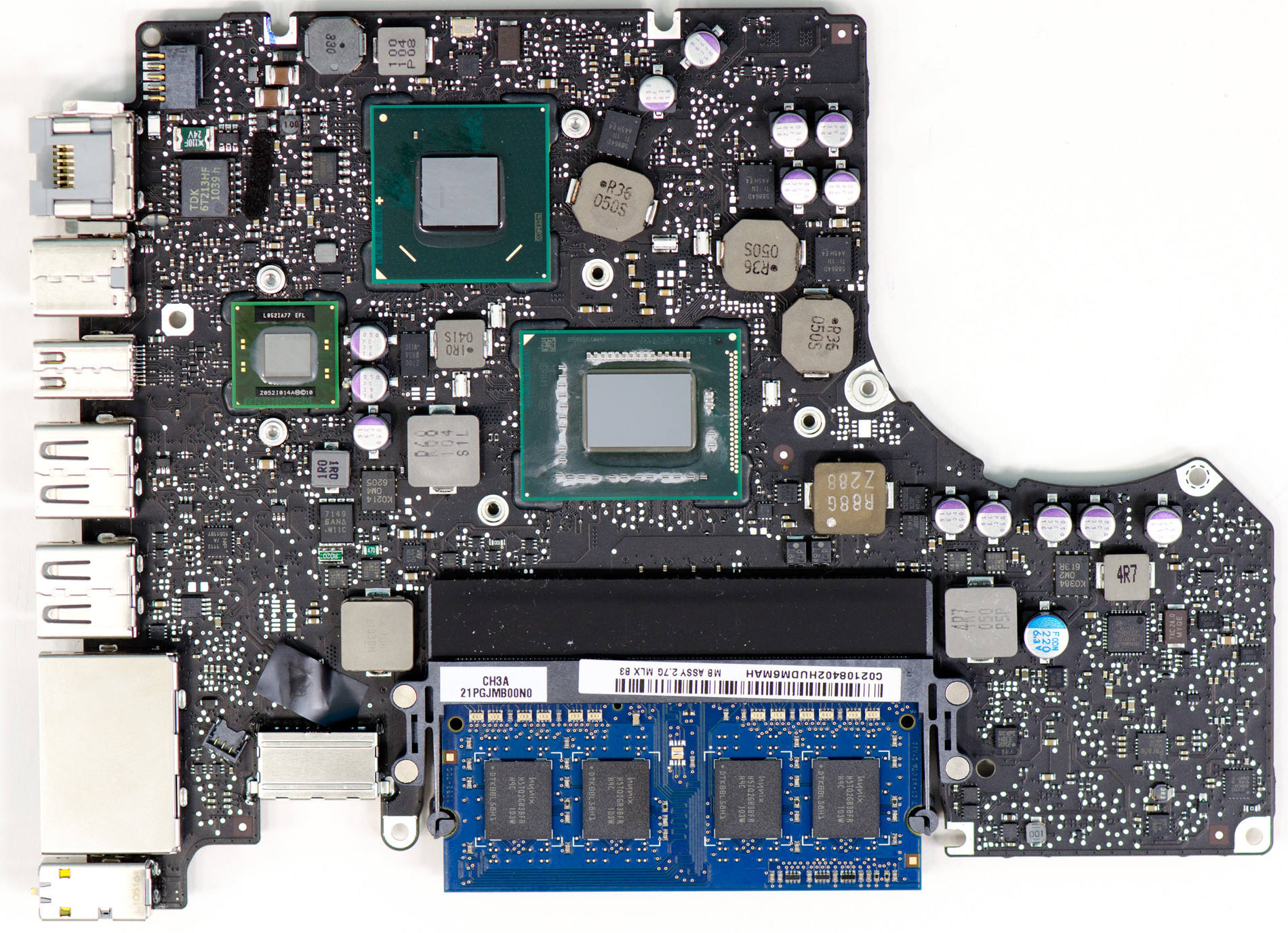

Found images of 13-inch 2010 MBP logic board. Audio jack in lower left corner of first one, and lower right corner of second one.
Looks like a rather simple soldering project, but it is quite small and may need an experienced solderer.
