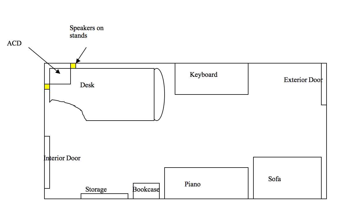

So; they still sit in the corner. I am planning on getting some Auralex Mo Pads for underneath, but how exactly will the corner affect the sound? Is there any treatment that you can recommend so that I can get an accurate monitoring solution?
My trouble is that I want a squarish room with lots of acoustic treatment so I won't have any of these problems and the speakers would sit somewhere in the middle so there are no reflections off the room, but unfortunately I also use the room as a teaching studio so it has to look neat and tidy!!
I've attached a room plan below so that you can get an idea of the possibilities of acoustic treatment.
By the way, thank you for the replies so far.
if you want to get into speaker placement, this thread can go on forever.
indeed. other than offering some CW as a starting point, i think it's like a war: you make all your plans, then everything changes the moment you start implementing it 🙂
it will exacerbate bass problems and the early reflections will spoil your stereo separation.
buy as many bass traps (actually, they're broadband absorption panels, but they're most effective in the bass frequencies) as you can afford. i have panels from both GIK and Realtraps and can recommend both. performance is similar, GIK is cheaper, RT has better build quality.
for placement, the first thing you should think about is having the speakers fire the long way into the room. then you should move them as far away from the corners and front wall as is practical. the CW for listening position is 38% of the room distance from either the front or rear wall.
put bass traps in all 4 corners (you can mount them on moveable stands to deal with the doors) and as many 2 surface meets as you can. also consider placing the high-freq versions of those panels at your 3 first reflection points (ceiling, left wall, right wall). finally, acoustically decouple the speakers from the floor.
if you can do all of those, you'll likely have a nice sounding room. of course there are always constraints, so do as many as you can.
