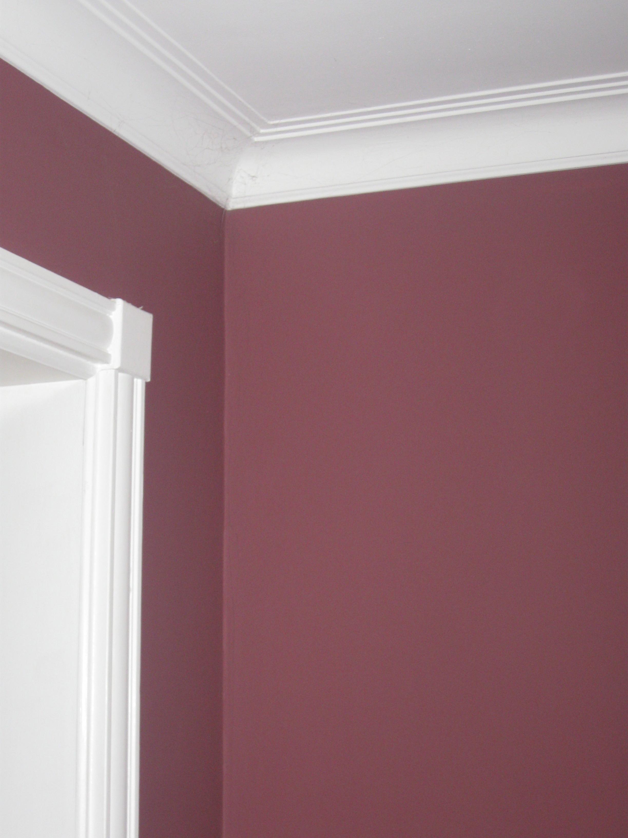

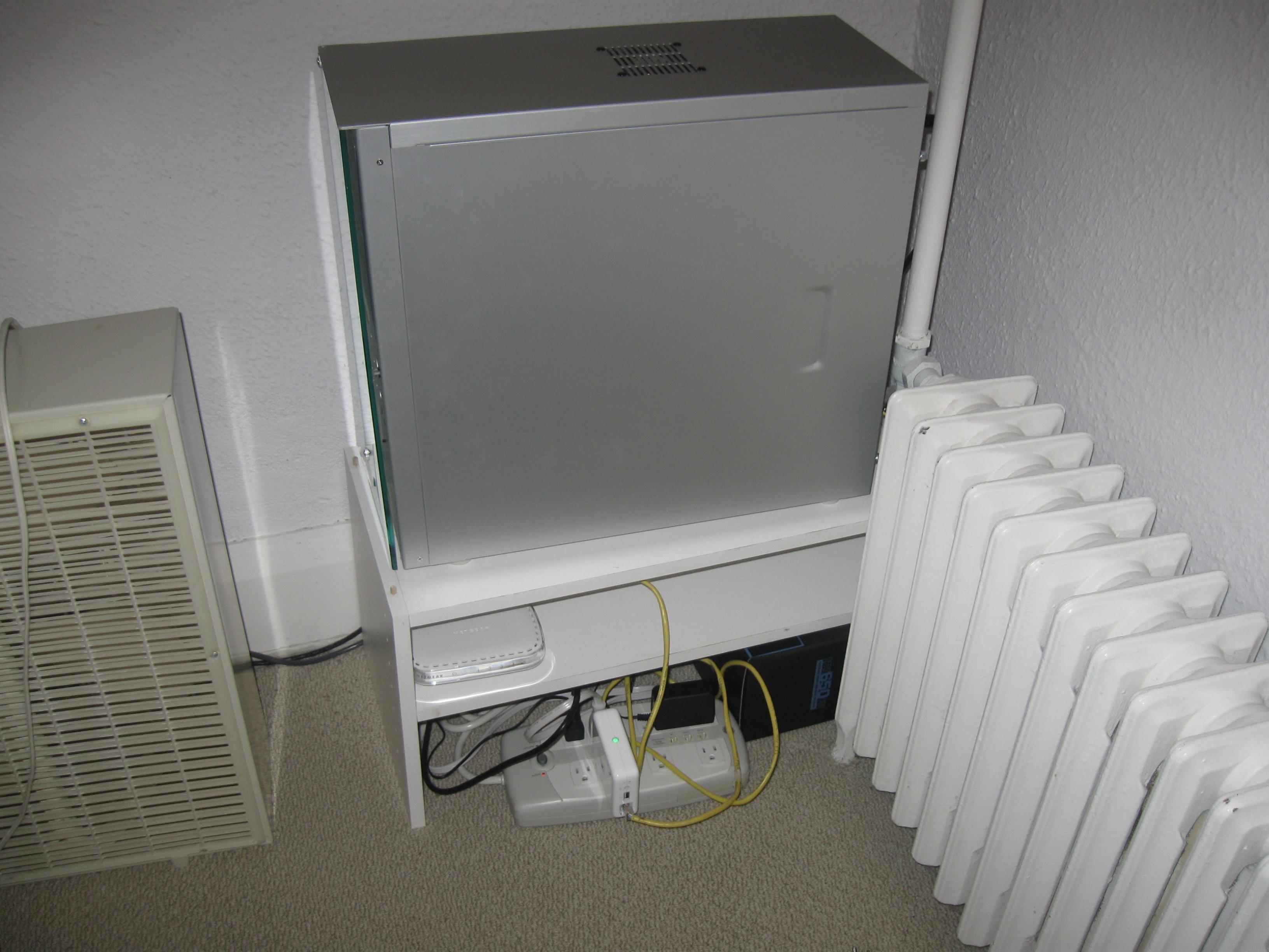

I live in an old house and want to add speakers cheaply to my house. Currently we own the right stuff (Bose cube speakers, recover, airport express, subwoofer, etc) But we are can't think of a plan. The problem is that we don't want any visible cables and we can't cut up the ceiling. We could not figure out a solution until yesterday I thought of (if I do say so myself) an amazing solution. My idea was instead of running the speakers to a a receiver in the room why don't we put it in the basement! It gets better! The room below us is our server room! So the idea is we will mount the speakers on the corners of the walls, run the speaker cable through the well, along the outside of the house, have the cable some back into the house through the basement, connect it to our receiver, and connect our receiver to the airport express.

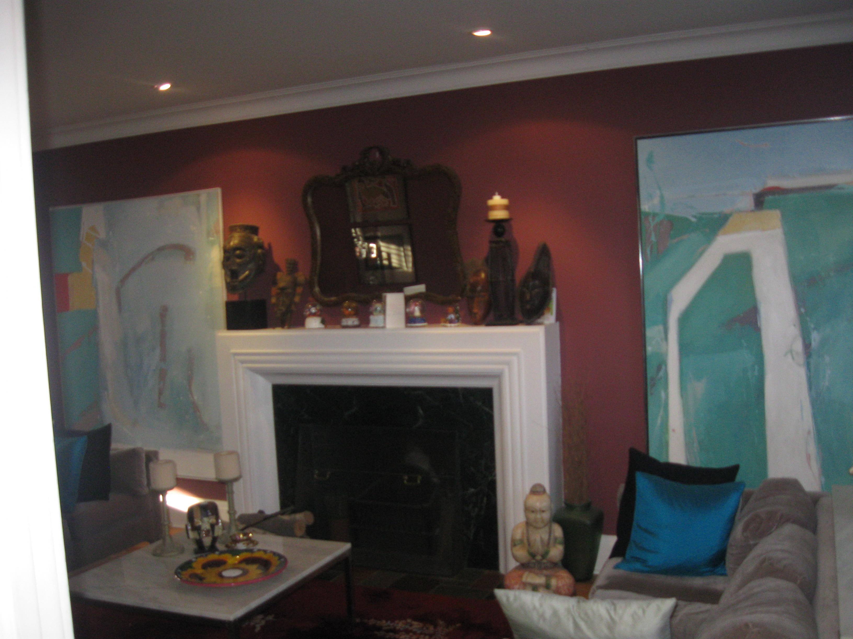

Living Room:

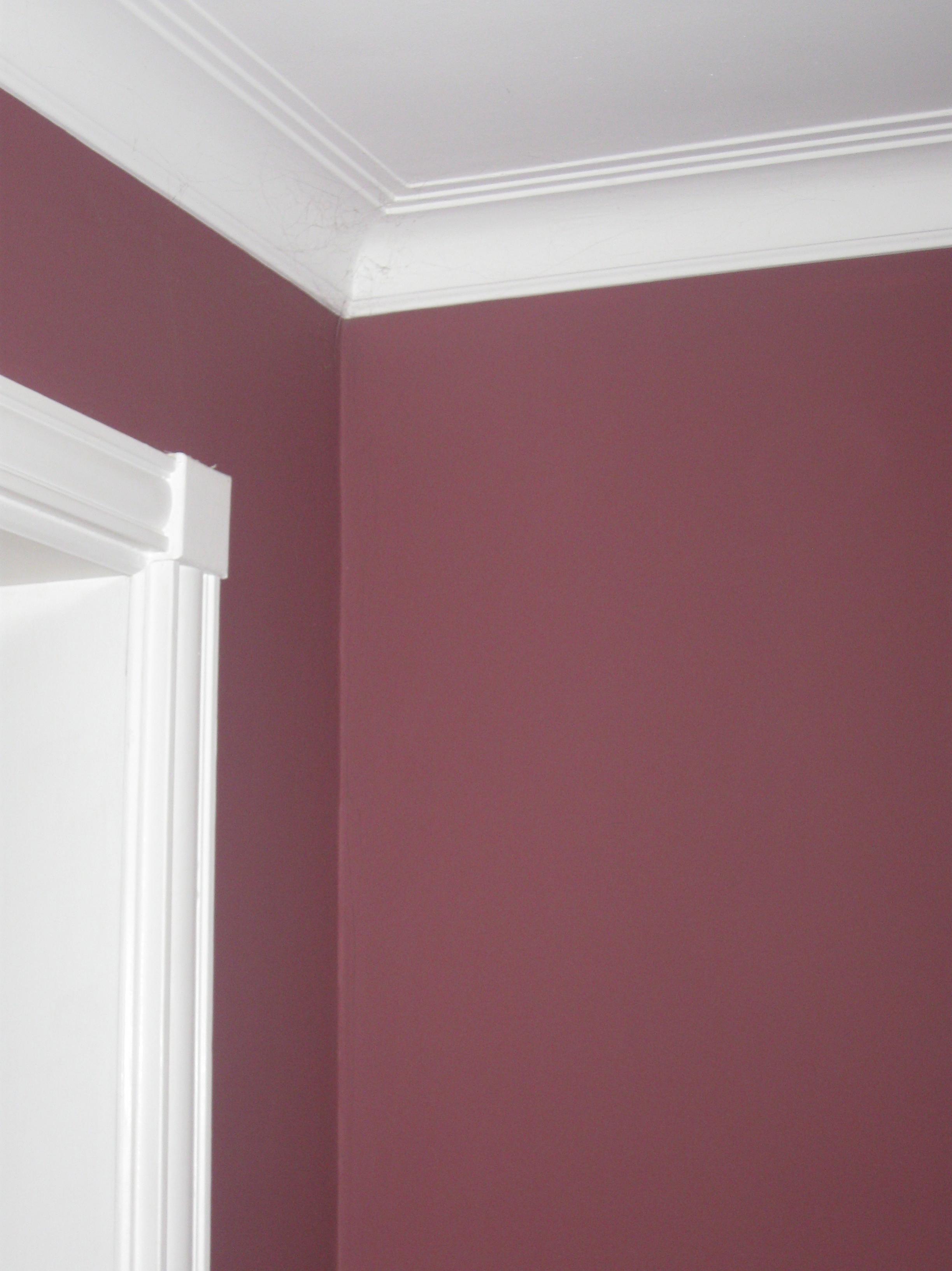

This is were we would put one of the speakers, and I would put the other in the opposite corner:

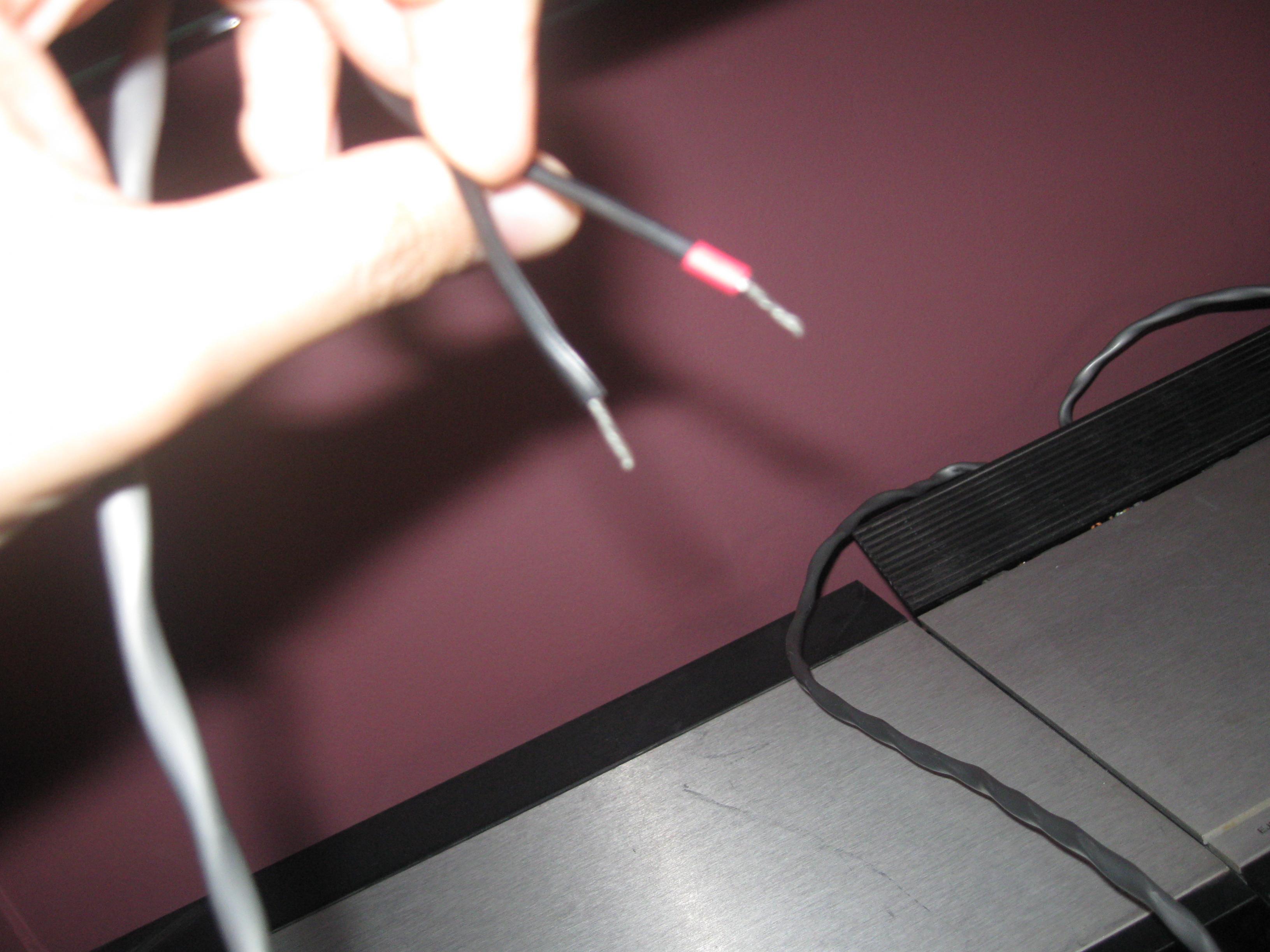

This is they type of speaker cableing we would be useing (Does anyone know what this is called and were to get it cheaply?)
The reciever would be located down here connected to the airport express:

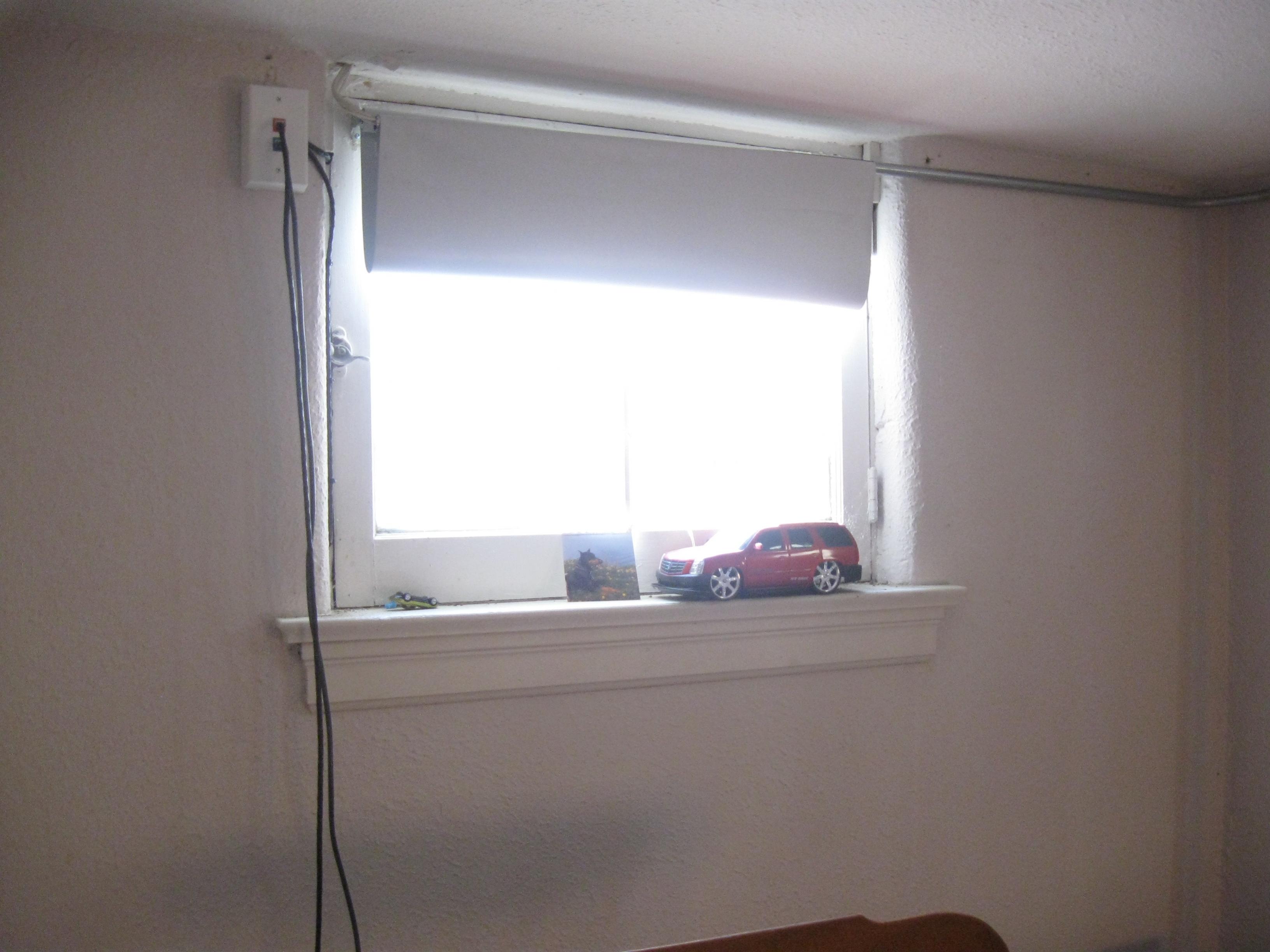

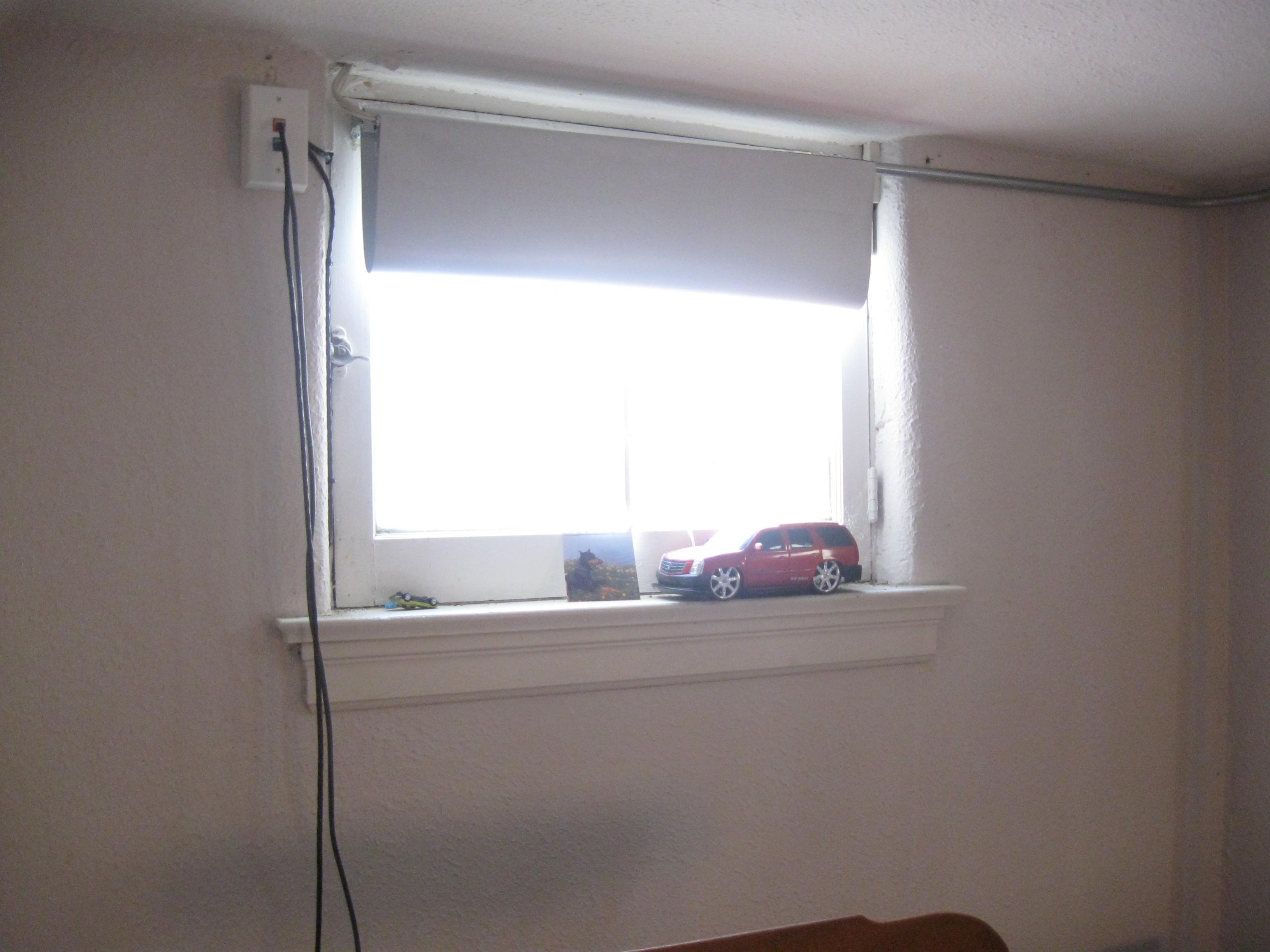

So this is were the cabling would re-enter the house:

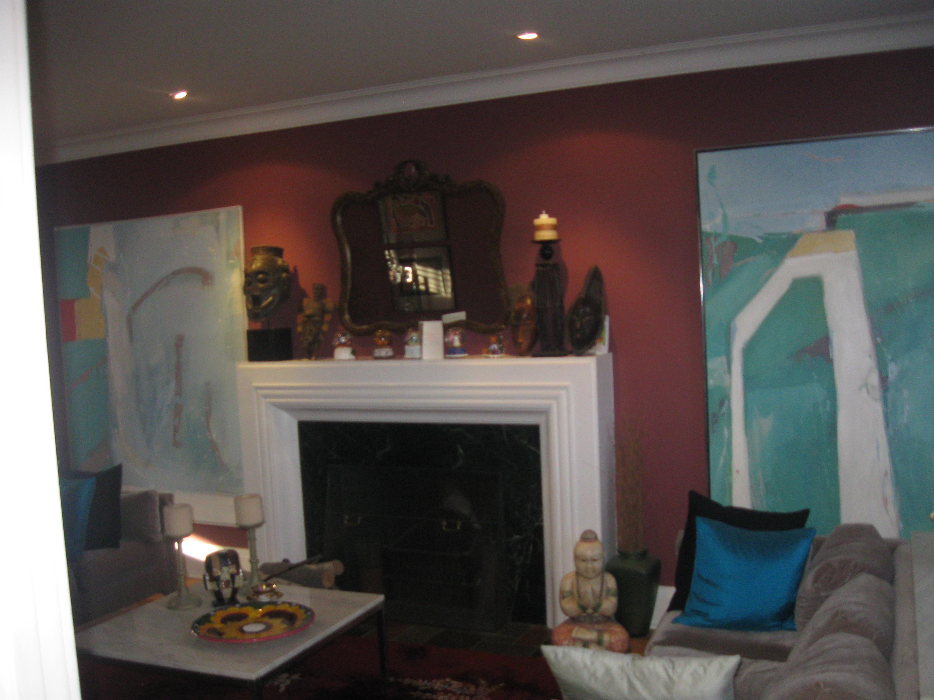

If all goes well we will do the same in this room:
http://www.flickr.com/photos/67500475@N02/6492832979/in/photostream

1) Is this just for listening to music, or will this be part of a home theater set up?
2) Have you considered going through the basement ceiling and into the living room floor? You could use floor standing speakers so that there would still not be any visible cables in the living room.
I'm not sure I like the idea of running speaker cables outside of the house. That seems like it would be more unsightly than having speaker cables visible in the living room.
The picture of your speaker cable is out of focus so it's hard to get a good look at them. Regardless, I highly recommend monoprice.com for all of your speaker cable needs.

Hope moisture doesn't enter through the holes in the wall. I have done something like this going through to the garage but never outside the house.
You don't have to go through the floor, but you can come from the basement into the wall cavity. It will be MUCH cleaner than going outside the house. Any holes in the exterior wall will create a hole the the insulation value of the home. This will create a leak and allow cold air in during the winter months and cool air out during the summer months.
Also, why the Bose cubes? IMO, they are not "all the right stuff," especially for music listening.
Listen to this post. Both points are right on.
Do NOT run your speaker cables outside and then back inside your house. You will get moisture problems as others have pointed out. Either run them through the walls (hire a professional) or have your drill meet your floor exactly where you want to put some bose floor standing speaker stands (which have channels for hiding the speaker cable - you will not see it at all). If you drill the hole in the right spot and don't use an overly-large bit, it will be completely unnoticeable. As others have pointed out you might not want to state so boldly that having bose cube arrays is the "right stuff." To anyone who appreciates hearing the full spectrum of audio they are definitely NOT the right stuff. Nevertheless you can get much enjoyment from them.
By the way, that speaker cord is probably 16 American Wire Gauge stranded silver-plated nickel or copper (or stranded copper with silver or nickel-plated tips). Bose actually will call it "lamp cord" because it's the same gauge as "lamp cord" you find at the hardware store.

In regards to moisture.. Honestly we have done this with other things (cable tv, ethernet) and never had a problem. After we drill the hole we use some spray foam installation to fill the area. We have not had any problems in the 14+ years like this (Our house was built without cable, our house is also pre WW2) We also will use some caulking to see the hole.
In regards from insulation... If you can not tell already bye our houses old age our house has little if any insulation. We will take this opportunity to add more (see above)
